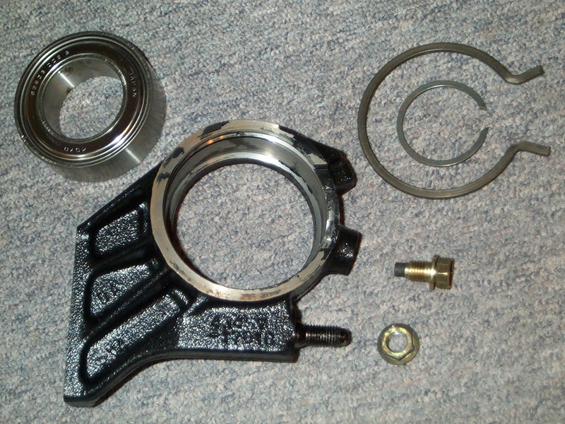

Jack it up and check your axle carrier (if you have one). It looks like this:
Next to it in the pic there is a screw with a rubber tip. This screw secures the bearing that sits in the housing and stops any vibration. If the rubber is missing or worn down the bearing will move and make wierd noises.
Just my 2 pence
***EDIT*** Just read it's an N/A, so probably not applicable
Just my 2 pence

mr2magic wrote:Jack it up and check your axle carrier (if you have one). It looks like this:
Image Replaced With URL For Quote http://www.mr2turbo.info/pics/800x600/dcp_2772.jpg
Just my 2 pence
Cheers but i dont seem to have one lol
