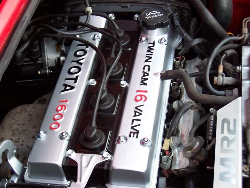

Karl_T
Posts: 871
Joined: Wed Sep 14, 2005 6:52 pm
Location: Wiltshire
Re: Best paint for cam covers
Post by Karl_T »
Can't find an 'in engine bay' shot to upload but this is how they looked after I'd done em, and to be honest they still look the same. Not too shiny, just a good flat silver.
Done with Plastikote, with Humbrol lettering
