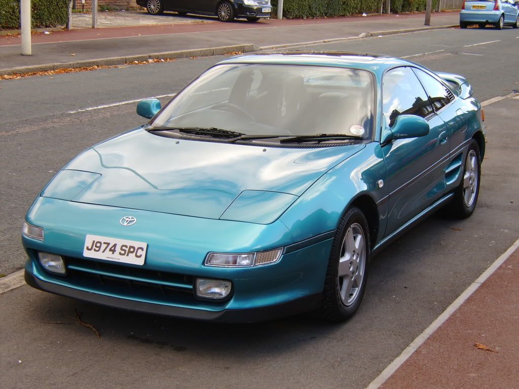

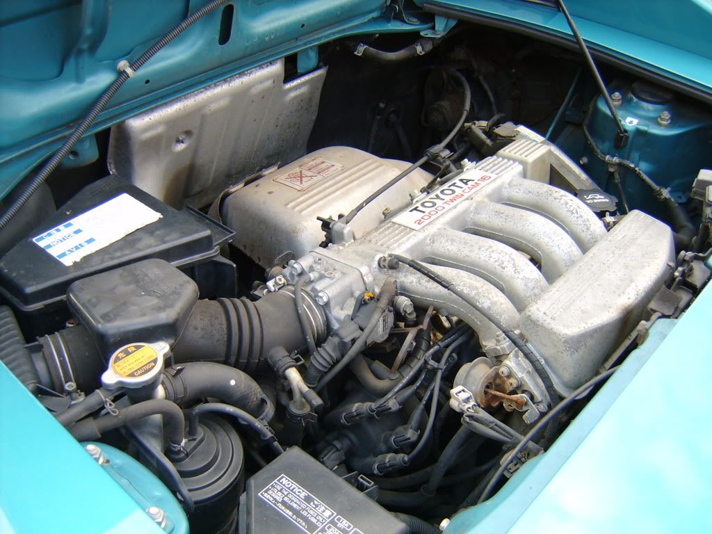

nope heres mine couldnt resist a few pics of her either, not that many uk cars around i mostly looked at imports this came up for good money so thought why not the rest is history :thumleft: :thumleft: :thumleft:
