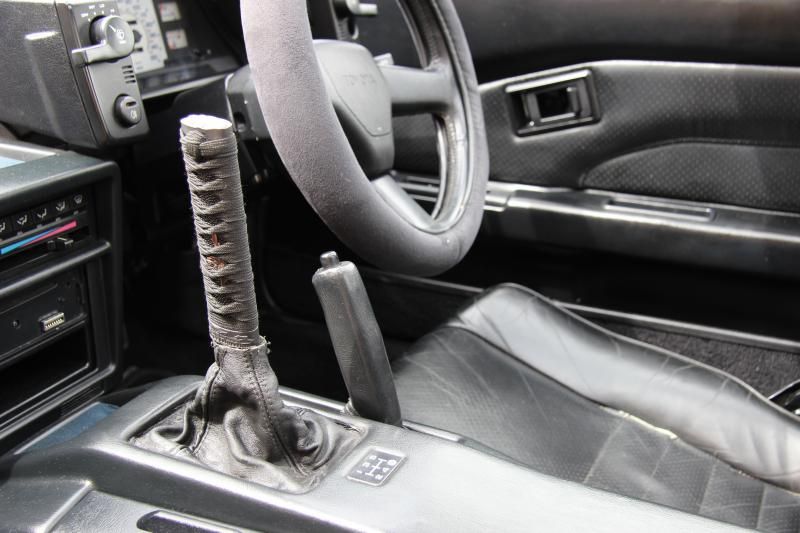

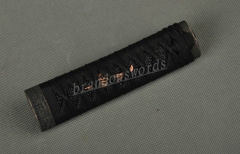

Bit of playing this morning and got my katana sword handle fitted, a little nod to Seiichi Yamauchi here.

That is different. A lot of the drifters seem to favour these long gearsticks. Do you think it helps or hinders the gear change though?
Also steering wheel cover. :shocked:
Samc
Posts: 29
Joined: Fri Jun 06, 2014 6:02 pm
Location: Hayling island
Re: Project : Its not a project MK1b
Post by Samc »
I say hinder as I drilled a load if the inards out so I won't be using it for road driving.
Leather wheel is a bit squeaky puts me off ma driving. Cover will keep the wheel looking good for a while, but yeah bit xxxx in it lol.

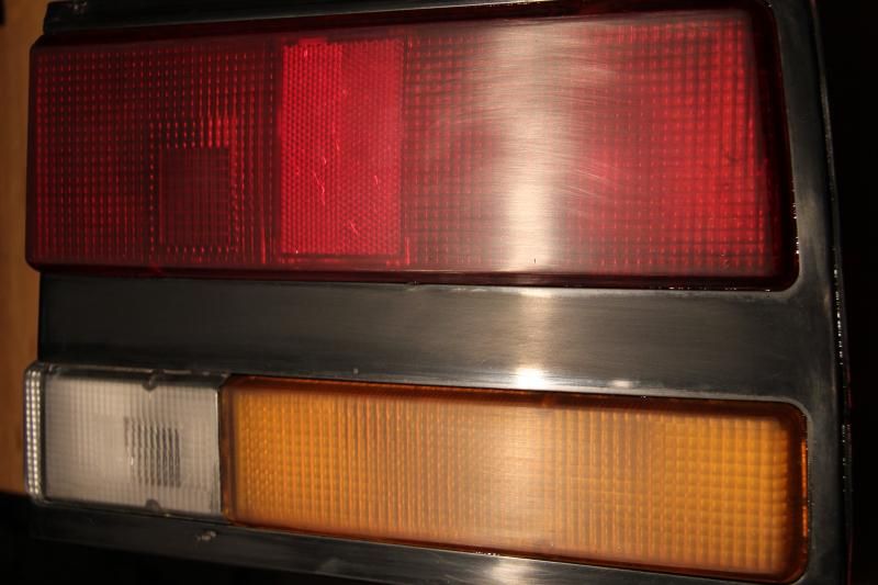

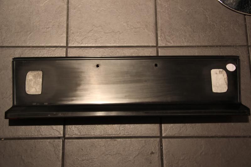

Bought an extra set of lights and rear panel to try this on. Going for a smooth look with deleting the original number plate lights and fitting some bolt lights instead to metal import size license plate which is on order, also going for a red tint on the orange indicators/reverse light with amber LED bulbs and load resistors. Extra reverse light being fitted under the bumper, not that you have to for the MOT!
All the lettering gone now..
Needs more fill and sand, not my favourite job in the world

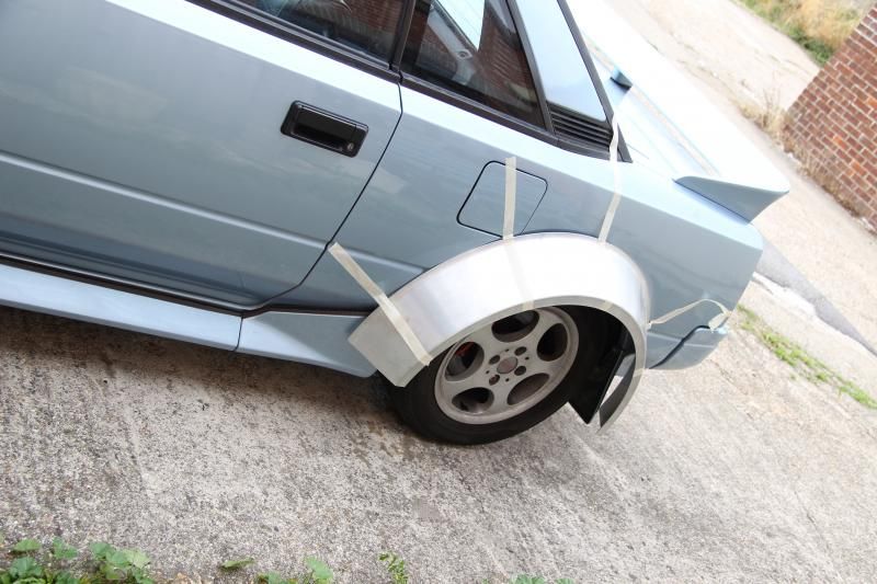

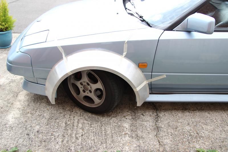

Know I now I said the outside of the car wouldn't change too much, however I just love my cars low and very wide! I had these arches from a previous build, they are spun aluminium from an air con inlet duct!
If that ^ ever did happen I would sell the OZ Turbines in favour of some 13" x 10J wheels to fill those dang big arches

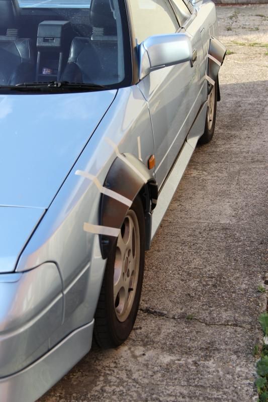

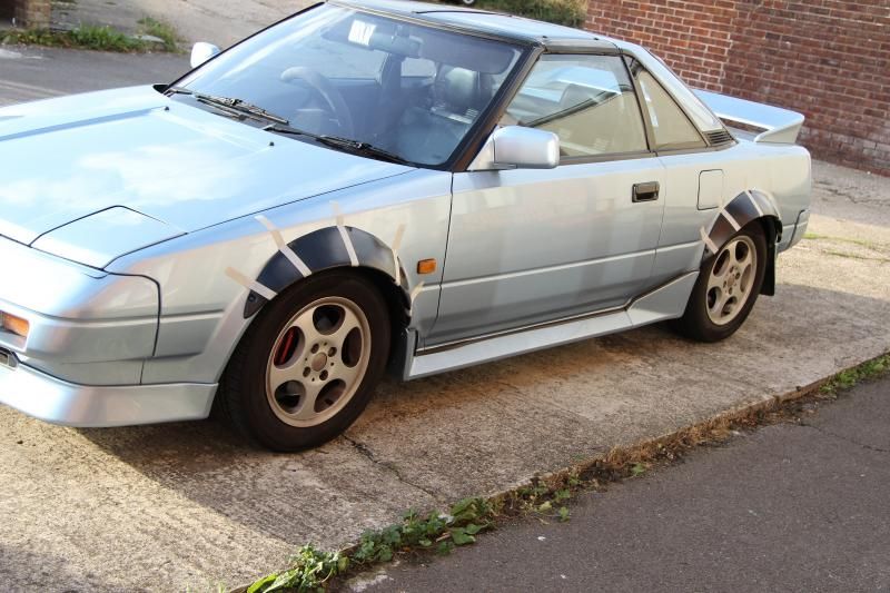

Post by Samc »

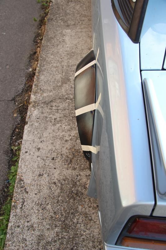

So this looks likely to be happening! Scored these arches from a company called ala-plast in Poland, made from ABS plastic and really a good fit without to much trimming. Have been in contact with the suppliers of Revolution wheels and after some measuring they confirmed for me there 13" race wheel will just fit over the rear calipers.
