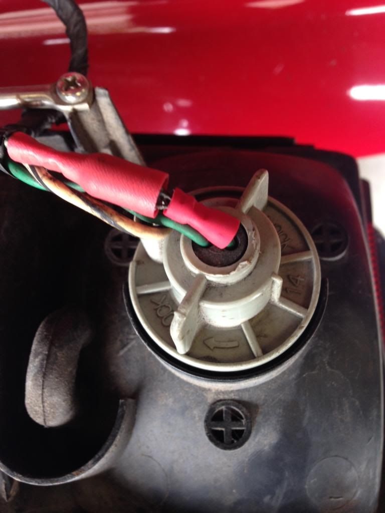

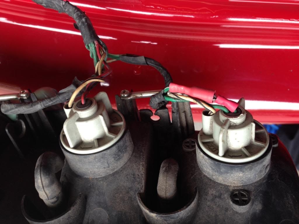

When the lights are on all four lights illuminate as they should, but with brake pressed i have no brake light in the inner drivers fog.
I didn't install the mod
Thanks in advance
That I would think is the problem, diodes only allow electrical flow in 1 direction and prevent the circuit from being made elsewhere and bypassing the fog light.lufcraigyg wrote:There were no diodes that's for sure, just spade connectors in the wiring on the passenger side inner fog.Also with fog switch on i don't have fog lights, so guess i need to see whats on the end of the switch
I'll get some picks up tomorrow& update.
Craig
What you need to do is to install a diode with the flow facing the light fitting on the Fog Live(green with orange stripe wire) and another from the Brake Live
(Green with white stripe) where is connects the two
- which is added as part of the mod.
This one needs the flow facing from brake to fog.
The diagram here shows what Im talking about.
http://www.mr2oc.co.uk/know-your-2-know ... bartid=211
EDIT on the last picture it looks as if there are only 2 wires on the LH light, is this correct?
