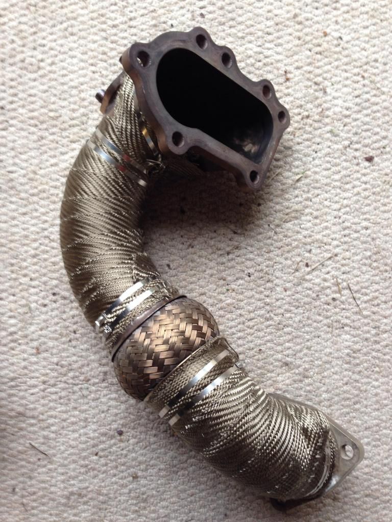

I did this last year and actually found that my boost level went up so had to adjust the controller.
I guess it was due to lower intake temps

You've done a neat job on that :thumleft:

Mr.Two wrote:You've done a neat job on that :thumleft:
It took a lot of patience to get it neat. Well worth it in my eyes though.

Lefty1991 wrote:Image Replaced With URL For Quote [url]http://i842.photobucket.com/albums/zz346/Lefty1991/Mobile%20Uploads/image_zps4332552a.jpg[/URL]
Your boost pressure went up because the waste gate was unable to control the boost as the outlet pressure was much higher because of the increased back pressure after the turbo.
You can do a much better job by fitting a heat shield around the pipe, just not wrapping it.
