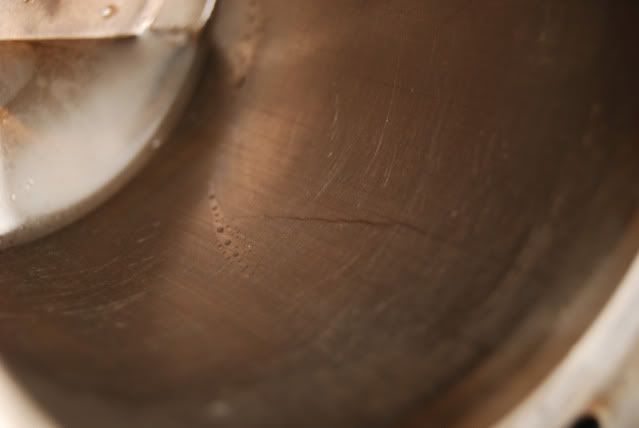

dawesy wrote:....early or late block sleeved or not makes no difference.....
You should be ok with a late 3s block, sleeved with the re-inforced corner, or are you saying you have already cracked a late sleeved block?
Did you cement it just to the water pump housing or fully to the deck?Where did you crack the cemented block?
ive had a block i brought brand new in 2003 ultrasonically measured and it was thinner than a 94 block by nearly 0.5mm which may not sound a lot but the walls were only around 3mm anyway.
yeah cemented to the bottom of the water pump.
first cracked block about 2 weeks after mapping :( (Cyl 3)
second cracked block (cyl 3 again but further round)
the only possible explanation for the second one is ai had a small leak (turned out to be the HCV) for a short time. wether or not this weakened the block im not sure. the second block has lasted for about 5 years and 20,000 miles though 8-[

dawesy wrote:
Image Replaced With URL For Quote http://i80.photobucket.com/albums/j183/ ... 000023.jpg
Image Replaced With URL For Quote http://i80.photobucket.com/albums/j183/ ... C_0311.jpg
Not had much luck then!
The 2003 block, then sleeved should be a good option if uve still got the block.
