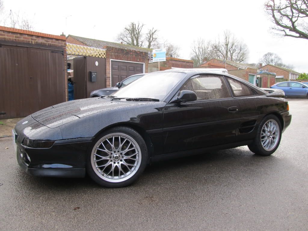

well chuffed with result, i have carried out
Chassis:
Lowered on spax springs
Black bilstein shocks all round
New front drop links
EBC yellow stuff front pads
EBC drilled and grooved front discs
17 inch BK racing wheels
Engine:
A complete rebuild has been carried out which has included:
Forged wossner pistons
Cometic triple layer head gasket
Ferrera competition exhaust valves(full set)
The block has had a re-bore.
Head has been skimmed
Reground balanced then polished crank
Balanced and resurfaced flywheel
Balanced clutch cover
LSD gearbox and driveshafts from later revision mr2
Rebuilt turbo from turbo dynamics with a 360degree bearing, fitted with forge actuator
Magnecore ignition leads
Iridium spark plugs
3 inch mongoose exhaust system
3 inch decat downpipe with heat wrap
Blitz sus induction kit
Blitz fuel cut defender
Complete ST205 chargercooler conversion fitted with toyota pump and silicone coolant hoses.
New toyota gasket set fitted including crank seals etc
new oil pump
Reconditioned starter and alternator
new cambelt and alternator belt
new thermostat
new cap and rotor arm
hose from hell plus most other coolant hoses replaced.
Clevette main and big end bearings
Braided clutch hose
MBC fitted
Chrome heatshield plus professionally painted charger cooler rocker cover and manifold.
New battery
New 02 sensor

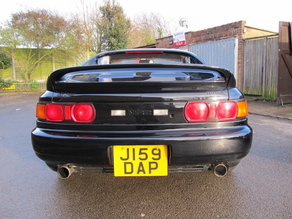

Body:
standard other than uk spec front bumper strips
rev3+ rear lights
Smoothed aerial hole in spoiler
Interior:
Apexi boost gauge
Chargecooler temp gauges
Kenwood cd/mp3 head unit with sony 6x9's plus JBL speakers in front doors
