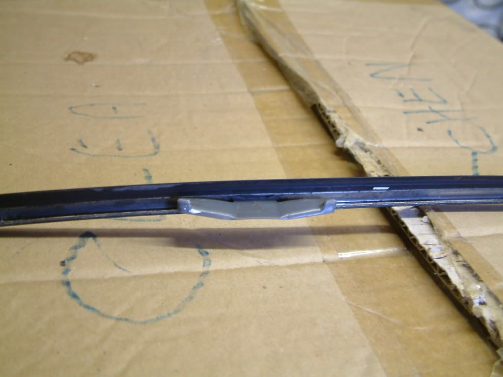

Jim, These are the plastic bits that stick in to the sealant. These are the ones you don't want to break.
Bod

The clips do come out of the trim but I didn't take mine out as if you pull the trim they will break.
Also the ends of the trim fit into the gutter trim making it hard to move the trim without bending it or breaking it.
Really the only way is to cut it out.
If you do break a clip you can slide the remaining clips along the trim to compensate.
The fish tank stuf is really untested as my car is still a garage ornament but I cant see why it won't work as it is water proof and a type of mastic.
Bod

Sorry, I meant cut the adheasive out leaving the clips attached to the trim.
If you can do better than me you should end up with the trim out with all 5 clips still attached.
You just have to take your time and be gentle (unlike me) or the trim will bend and it's a right cow trying to get it back to it's proper shape.
If you do damage it, all is not lost as apparently a windscreen place can supply a length of T section rubber trim that will stick in but I think it's better to have the origional part.
Bod

So if I get this right, the clips are clipped to the trim and the clips are then bedded in to the adhesive and so the trim itself is not bedded in to the adhesive itself at all? So in that way the clips are doing all the work securing the trim to the car?
If so, if the clips did break when I take the trim out what's to stop me digging the remainder of the clip out of the windscreen adhesive, gluing the clip back together with structural glue, glueing the complete clip to the underside of the trim and then setting the clip back in to new windscreen adhesive again to perform as an anchor?
