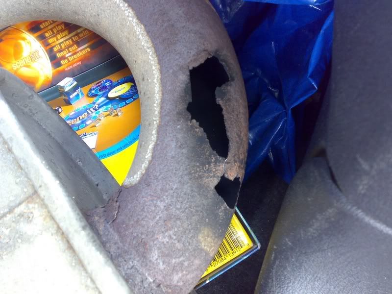

This is the remains of my HKS Hyper exhaust.
Completely rusted to bu88ery. This is a £600 exhaust system people and it's rusted so badly the hanger snapped off. Lucky the car has 3!
I'm replacing this with a much cheaper Berk unit thats fully stainless and has a lifetime warrenty I believe.
I guess what I'm trying to say is sometimes this "you get what you pay for" saying is completely wrong.

The saving grace is that I didnt buy that, it was on the car when I bought it.
I wouldn't even consider buying a mild steel system, especially not for £600

to be fair, its probably our horrible salty roads that killed it. was probably fine and would last as long as most people would have the car in jap-land.

I was trying to think of why on earth they make them from mild steel. It's not like it's dryer over there, they have a very humid climate IIRC?
Re: [Mk2] [Turbo] Beware Of Expensive Jap Crap
Most mild steel exhausts will rot from the inside -> out.
It's moisture in the exhaust gasses and condensation that forms on the inside which is to blame..

But to be fair, the standard system is going to be made mostly of mild steel and that HKS system has probbbably been on the car 10 years. Thats good going for any exhaust imo. Bit harsh to paint all japanese manufacturers with the same brush just becuase you have a rusty exhaust Its made out of metal, metal will corrode at some point in its life regardless of its grade of steel.

Think the Japanese exhausts are not really designed to last that long and possible our expectations of their life exceed the equation along with as mentioned salt roads-winter-internal gasses of the exhaust itself?
Having said that they are expensive but how many years have they been on some cars is another issue unless fitted by the owner as brand new to monitor its life preformance?

Not all stainless steel is the same. It comes in different grades.
316 Grade - top notch stuff, near impossible to get it to rust.
304 Grade - cheaper - rusts when it comes into contact with salt water / long term exposure to damp conditions.
I dont have a clue what grade the exhausts are made from or any of the scientific reasons for using a different grade. Im merely posting to say that as a sign maker I know there are different grades and that the quality differs a lot between them.
Stainless steel doesnt mean rust proof in all cases.

Mild steel exhausts will only rot from the inside if you leave the car for days on end without driving it. Or if you leave it out in the cold. If the car is a daily driver any condensation accumulated overnight will be blown through the exhaust that morning with no danger of rusting.
The reason so many companies make exhausts with mild steel is because mild steel deals with the heat far better.
