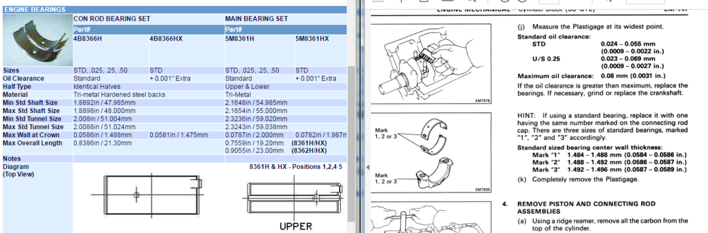

my only concern is the oil clearance as for all of my searching they only appear to be one size yet the toyo ones are 3 sizes, that said the difference in size is minute and mine are slap bang in the middle of tolerance so if ACL is equivalent to size 2 they would be perfect.
I might ping Pete a message but I don't want to hassle the guy, he must be inundated with questions like this
just looked up the spec sheet of the ACL bearing, its a damn sight more informative than sellers listings. Their standard size has a wall thickness of 1.488mm which puts it on the boarder of size 1/2.
I think I'll give that a go and see what it comes out on the plastigauge
People use them as they're cheaper, but nothing wrong with ACL or Clevite
If your old bearings were ok, I would think std size should be fine but deffo plastigauge
