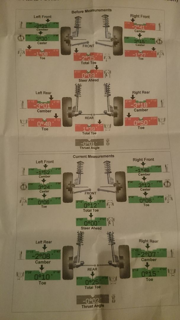

I'm sorry to keep bringing this subject up but it's really starting to p*ss me off and make me hate the car now Especially when some of you have been driving MR2's for years and always praising the handling, I can't believe that it's just my perception of the inherent characteristics of a midship car with light front end (which is what my mates are telling me) so there must be something going on with the car.
Had the geometry set up by Northampton Motorsport at the end of November and have had a few chances to take her for a good drive over the winter break since. Still not happy - can anybody advise what to try next?
I gave them a printout of Dino's recommended settings (see below) and asked for a fast road setup but left it up to them as they have experience with setting up MR2s so figured they may want to deviate from the settings slightly. From what I can tell (and it mostly goes over my head) the settings they've done are quite different to Dino's.
The car is cornering beautifully - very neutral, no complaints there. But on uneven B roads it's a real handful especially when putting down the power and even on the motorway/dual carriageway it just weaves all over the lane - especially when exiting onto a slip road etc. probably due to ruts in the road. Other road users seem to avoid me thinking I must be drunk Even in town it seems to wander wherever it fancies and I have to be really careful where I'm braking because I'm worried it'll lock up over a bump and head towards a curb (the roads in town are pretty rough too).
Suspension etc. as follows:
16x7 and 16x8 Te37 with 205/45 and 225/45 AD08R
TRD ARBs
Koni Yellows with Eibach springs
Front Tein top mounts
Delphi drop links
No PAS afaik (I know that sounds stupid but the steering is bloody heavy however it makes a whining sound sometimes related to steering input when making low speed manoeuvres)
Camber bolts all round for further adjustment
All wheel bearings are fine
Arnage RCAs all round (20mm or 25mm, can't remember)
It doesn't seem to pull to the side on a decent straight road, although I get some light vibration through the steering wheel (Sticking caliper? Wheels are balanced ok).
I kind of feel it was better behaved on my previous settings where I'd just maxed out the negative camber with bolts and had basic tracking done at a tyre place, but the cornering feels lightyears ahead since the new setup as it used to understeer intially.
Chris at Northampton Motorsport also pointed out that despite having a set of Eibach springs fitted, the front was sitting noticeably higher than the back. I have a set of lower front springs which I could fit if this might help, but not sure of brand - I ran them on my old Ohlins shocks. Speed bumps and ramps will just become even more of a challenge
TRD ARBs
Delphi drop links

Another thought - would anybody local-ish be willing to meet in the near future and drive my car to give me some feedback in comparison to theirs?
Re: My suspension woes continue.. (skip to end!)
I run a similar geo to you but -2 degrees front and -1.5 rear so opposite to yours. I also run total 0.42 rear toe and mine handles sweet as, loads of grip and very predictable on the road and track.
What damping settings are you running? Different front and back? I run about 10 on the road so very soft to allow for our crap roads.
How old are the units? Mileage covered? What tyre pressures do you run as well as I find the mr2 is pretty sensitive in this area.
I know I rant on a lot about corner weighting but the difference is night and day.
Standard suspension makes me feel sick in the bends like driving a boat id go back to them as a last resort.
At the moment they're all set to softest as corner roll was minimal and I wasn't sure how else to judge it besides wallowing and comfort!
The shocks and springs are pretty much new, less than 1000 miles since fitting in June iirc.
So I should probably go back to Nptn Motor Sport and explain, might try and persuade Chris to come out for a drive so he can see for himself.. Then hopefully they could tweak the settings and see how it fares should I ask them to take a look at the corner weighting too then do you think?
And 29psi front, 31psi rear seemed to be what most people go with so I've stuck around there tbh.
