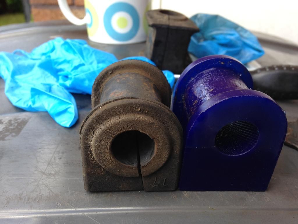

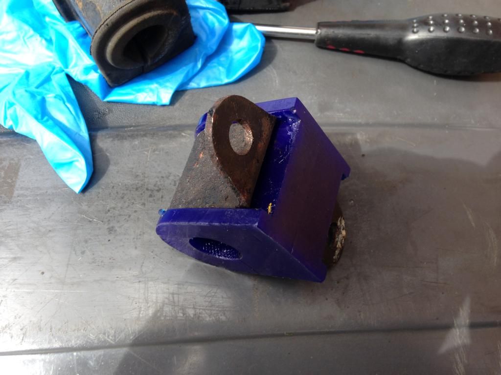

right after seeking advice and being assured my mk1b dec 1986 tbar has 18mm front anti roll bars I bought some arb bushes (18mm) tried to fit them today and although the antiroll bar diameter looks fine the arb bushs were about 5mm taller than the old bushs and they just dont look like they fit the old bushs said 17 on them but the arb measures 17.5 mm

right all fitted didnt realise they squashed up so much !!
what a difference ,jesus it corners and drives fantastic now ! :thumleft:

i had to slightly grind down my arb bush on st182 celica to make it fit. i would have done the same if my mr2 did't fit properly. pur is nice to grind down
