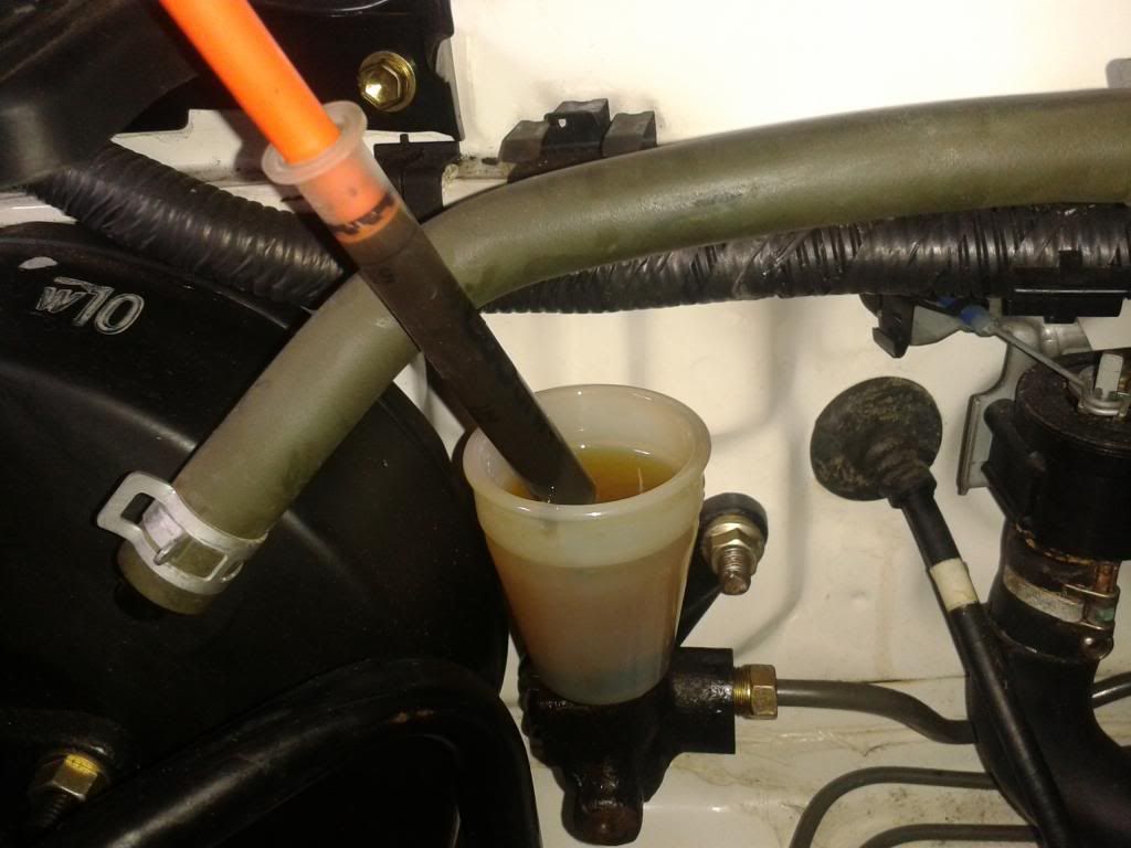

Thanks for the replys guys, I did a bleed of the system yesterday but didn't have a chance to take it up the road. The fluid looked nice and clean when you look through the peep hole in the frunk but it looked to have a dark patch at the bottom so I sucked some out before the bleed. Have a look.
Is this just crap from over the years or may be just wear from the seals or a bit of both?
Anyway, during the bleed I let it run dry twice, (it really is a pain having the reservoir at the front) but I think that helped give the pipe a proper wash through. I'll give her a thrash today and see what happens.

Bleeding can't have rectified the fault as that would only improve the disengagement of the clutch, for it to be slipping you had the opposite, so it must have been a sticky slave and the pedal pumping has freed it off.
Success either way.
