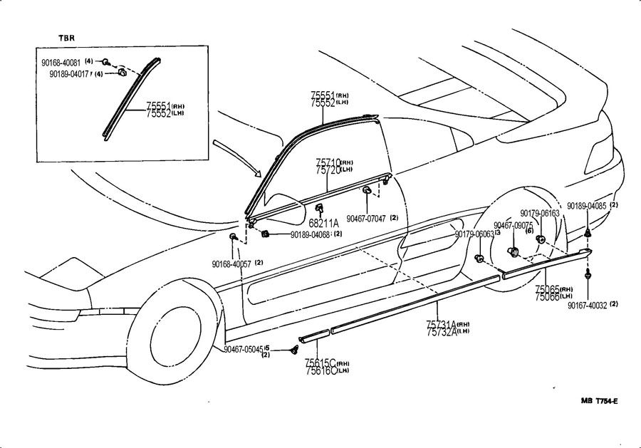

Re: External window seals/scrapers - Part number?
Driver side: 75710-17020
Passenger side: 75720-17020
Report back on prices - I'm sure I heard somewhere that these are very expensive!
juliankv73 wrote:I'd be interested in buying both passenger and drivers door window seals in a group buy
Are the mirror rubbers available (where the glass rises up to) as mine are split :/
75551/75552?
juliankv73 wrote:Are the mirror rubbers available (where the glass rises up to) as mine are split :/
Those rubbers are part of the mirror brackets:
67514-17020 (left hand side)
67513-17020 (right hand side)
