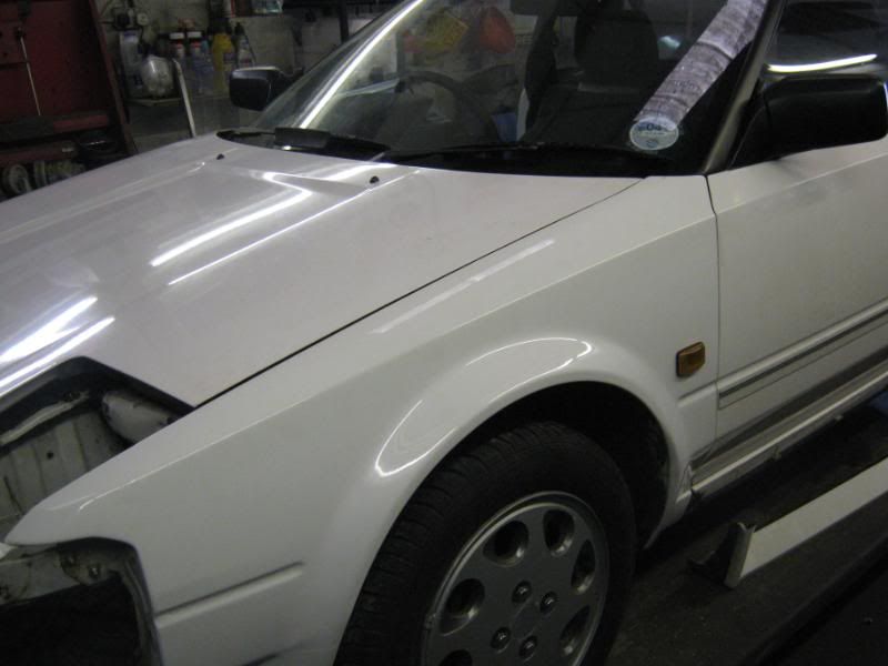

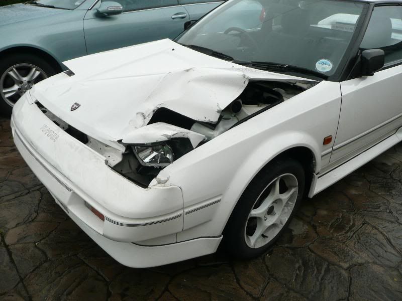

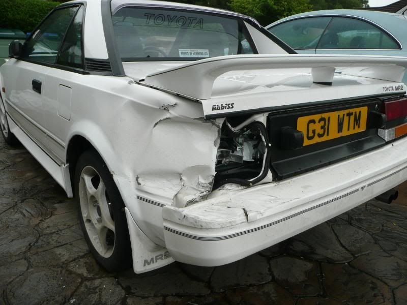

hi , i have saved a few mk1s now and love these cars to bits fantastic fun to drive and always bring a smile to my face when driving them . this car was smashed up after the peaks run which i organize with bill hulme on the mk1 club site . this is the aftermath of hitting diesel coming off a round about on the m60 ( very lucky Denis who was driving the car was unhurt )

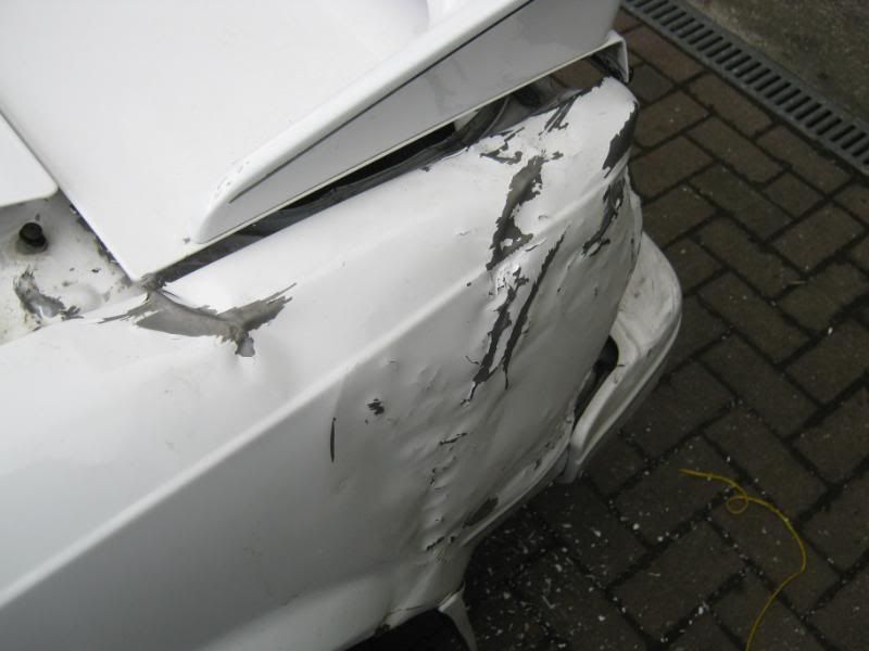

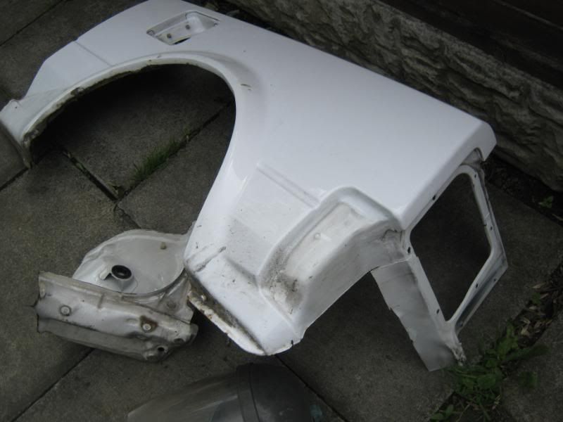

she had very bad hits but no chassis damage , i decided to buy the car off Denis to restore , she was to good to scrap and rust free and mint prior to the accident with the previous lady owner had it 18 years from new . she needed 2 new wings , slam panel , bumper , head light , bonnet , inner wing and head light mounting panel , rear quarter panel , back light and rear bumper with crash bar . she needed a lot off parts the biggest problem being the rear quarter . has luck would have it a fully restored car with new rear quarters fitted had sadly caught fire and was being scraped ( far to good to break but had already fully striped when i got to it ) . i managed to get 2 as new wings ,full rear panel , slam panel , and lights for 100 pounds

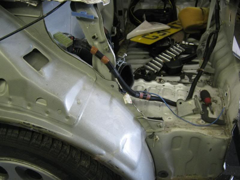

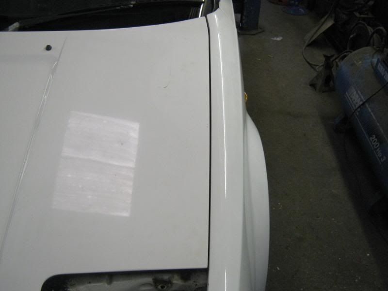

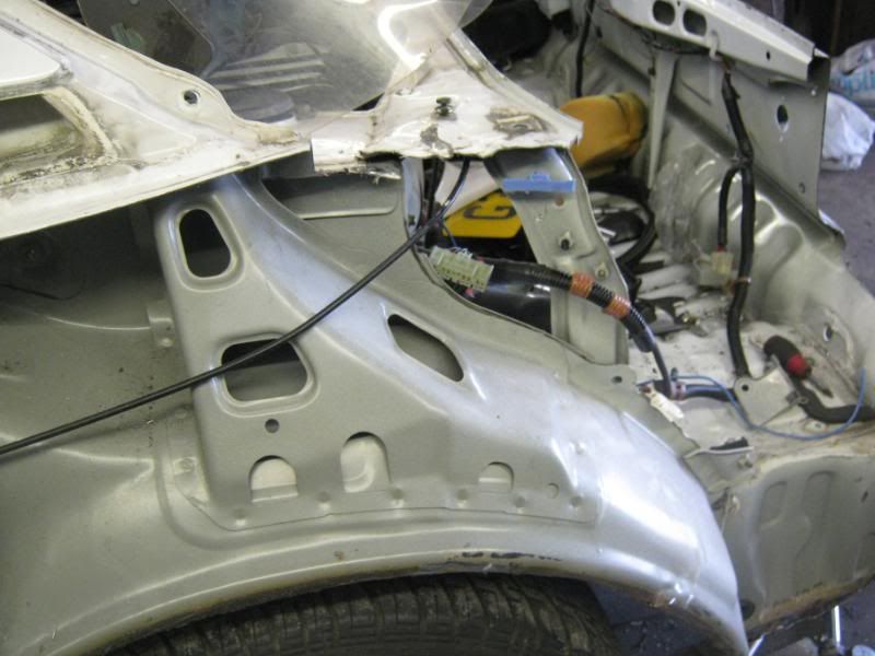

parts cut out of donor car

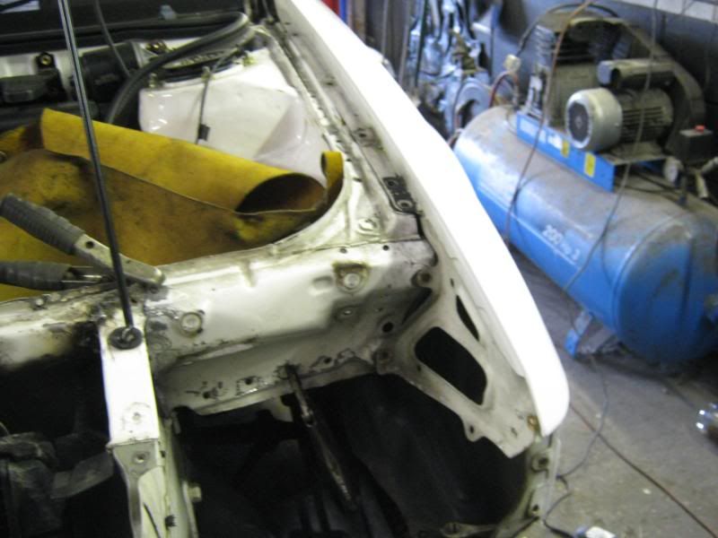

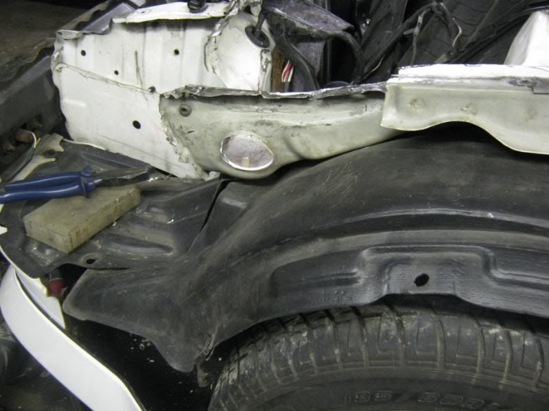

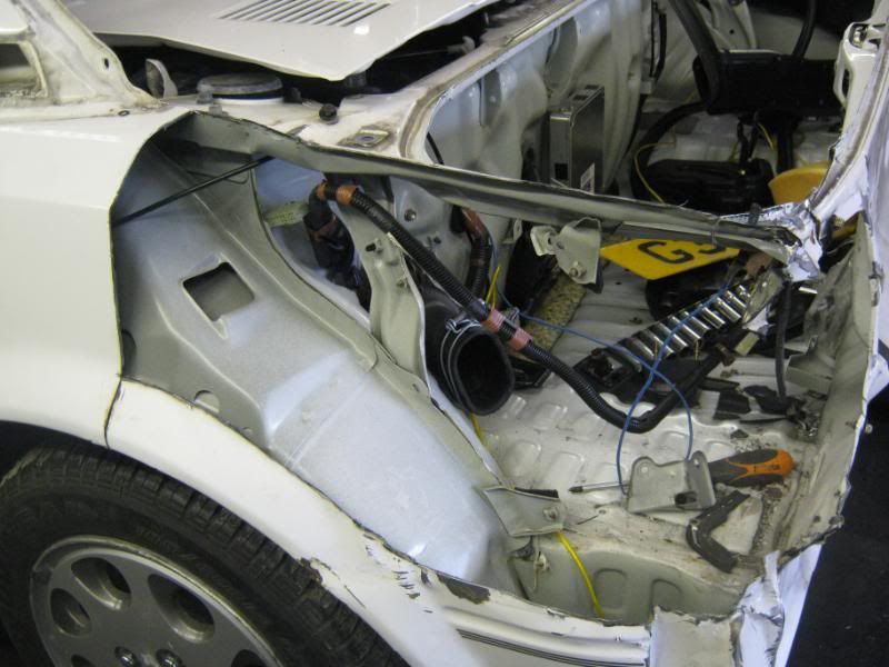

the front was done first on the car ,it had inner panel damage so this was cut out .

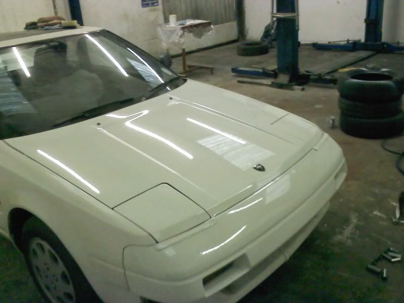

the replacement part where carefully measured and welded in

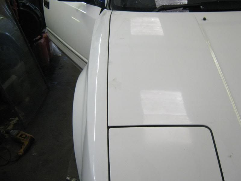

then the new wings and bonnet where trial fitted for the shut lines .
happy with the front it was time to sort the rear out .

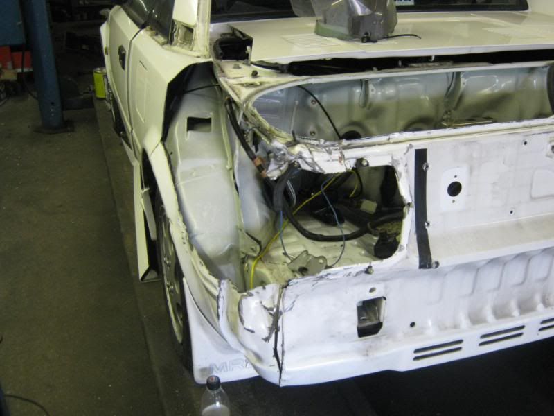

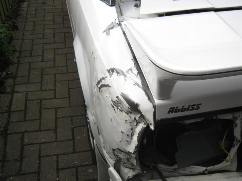

this was after i gave it a good bash to get the boot to shut .

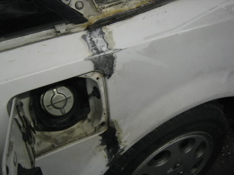

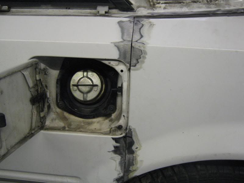

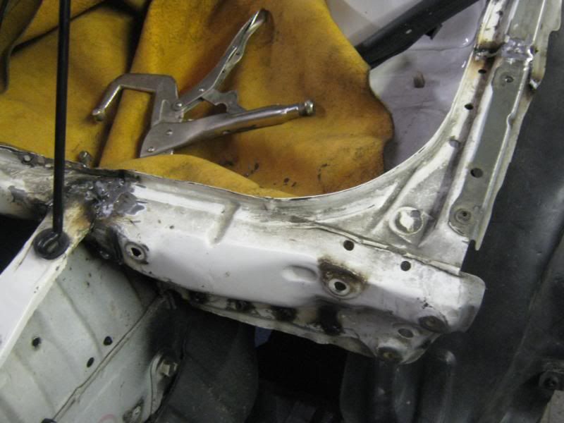

all this damaged needed to be cut out , i carefully removed the rear quarter .

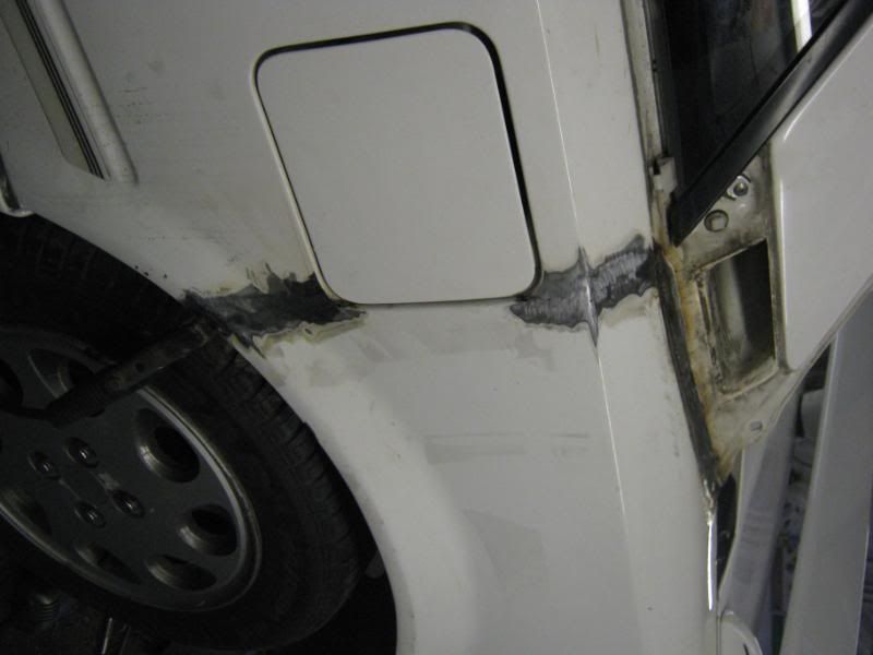

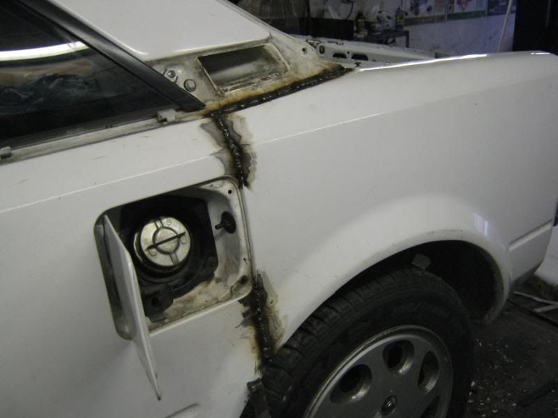

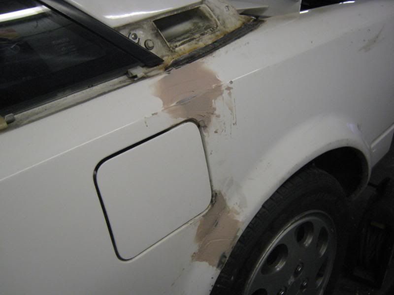

to fit the rear panel i decided to join it at the fuel cap edge as its the shortest distance to weld , this was a bit of a sod but is more than doable if you take your time .
welded in and spot welded around the rest of the panel .

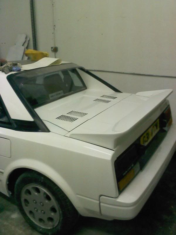

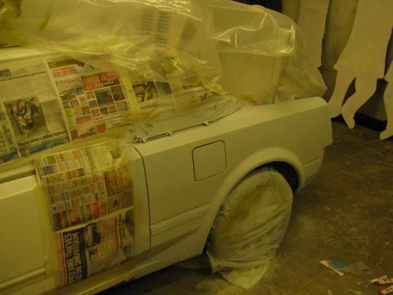

then filled and painted

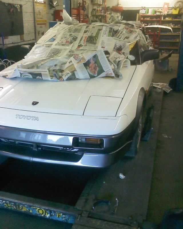

i decided to change the white from 043 to 040 and two tone the with gray 167 so fully painted the car .

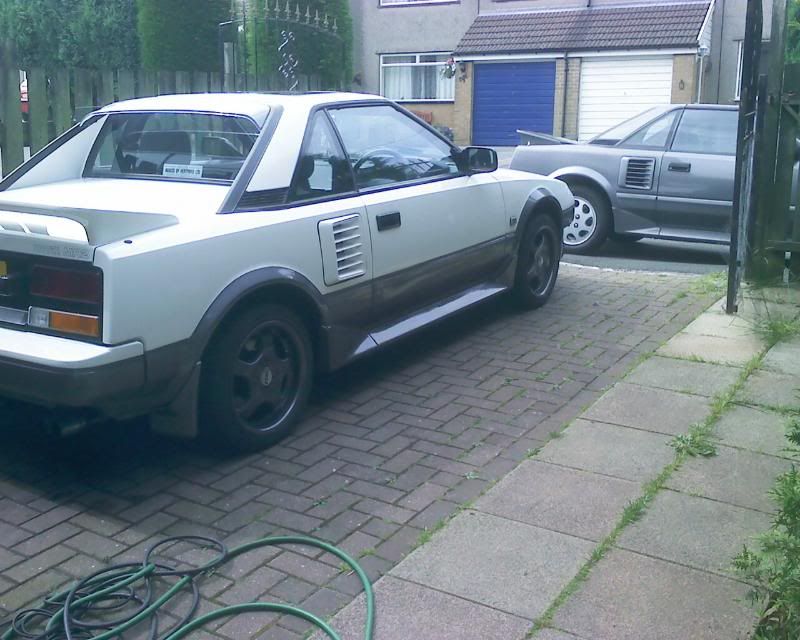

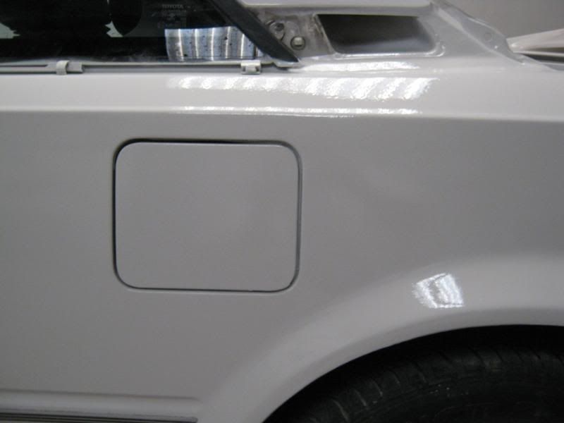

2 tone paint just done

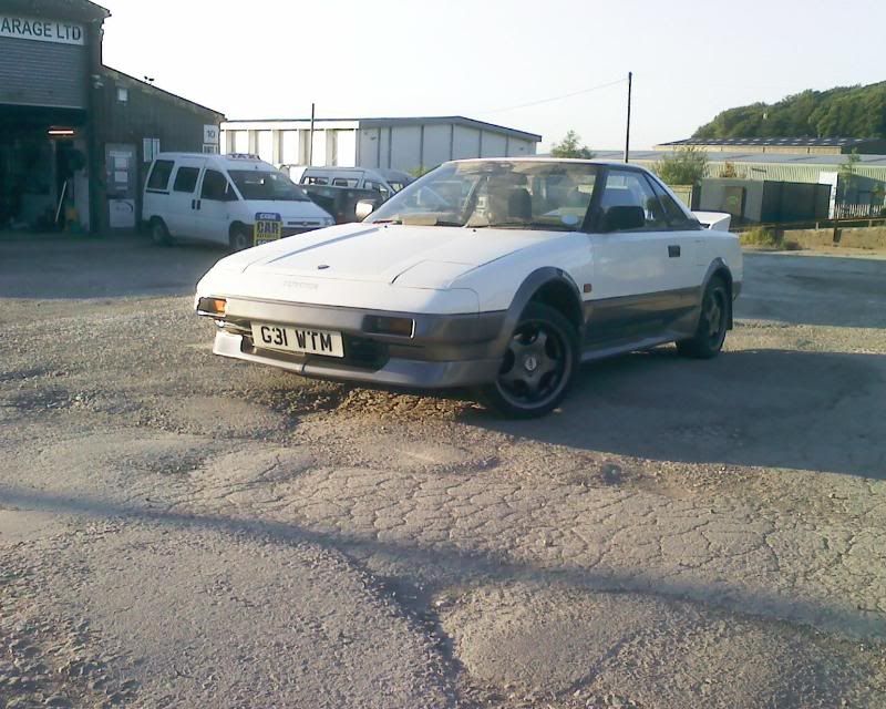

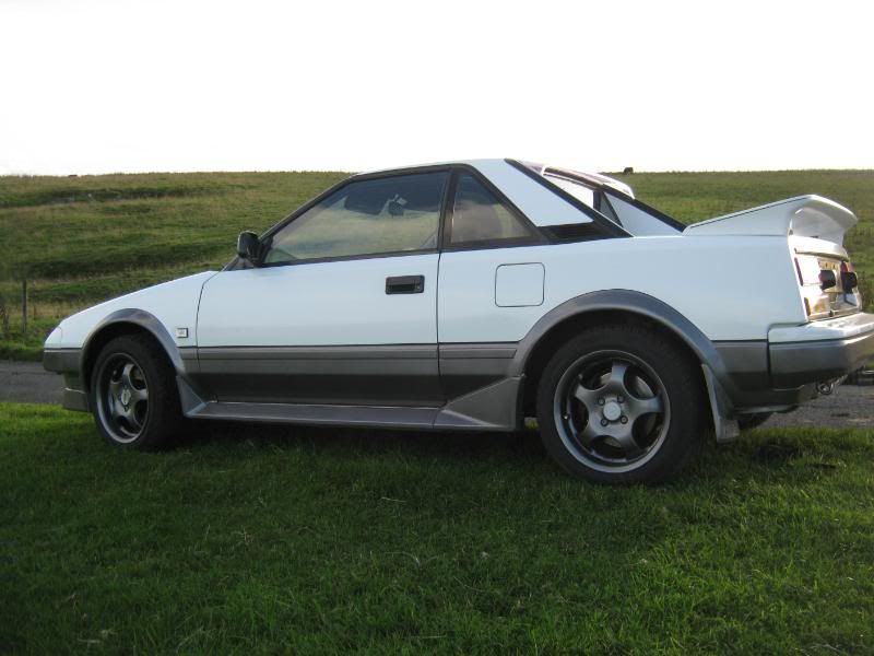

and car as she is now

@mk1dal - re pic, I recognise that setting , that crinkly hill, is it called "Parkhouse Hill" / "Chrome Hill"? Love that whole area. One never-forgotten drive was Longnor to Oncote to Alton in my mk1a in 1986.
Re: saving a mk1 which lost a battle with a armco barrier ( 360 spin)
What a fine thing to see it rescued like that. Full credit to our man who should be justly proud.
CecilWard wrote:@mk1dal - re pic, I recognise that setting , that crinkly hill, is it called "Parkhouse Hill" / "Chrome Hill"? Love that whole area. One never-forgotten drive was Longnor to Oncote to Alton in my mk1a in 1986.
hi, well spotted its called chrome hill , Ive walked up there a few times with the dogs the views are stunning at the top .

hi , i do know what you mean , that weld wont crack end off , it had a self adhesive purging strip at the back before it was welded and a 1mm weld gap for prep , even though the weld was ground off it still has the same depth of clean weld on the inside as the outside did pryor to grinding off. I have 23 years experience in fabricating ( advanced sheet metal ,coded welder and plater welder . ) and this repair was very easy to do compared to my day job , so i know the repair is 100% safe and only panel damage , it doesn't need a inspection . ps, do you own a super edition you lucky sod .
