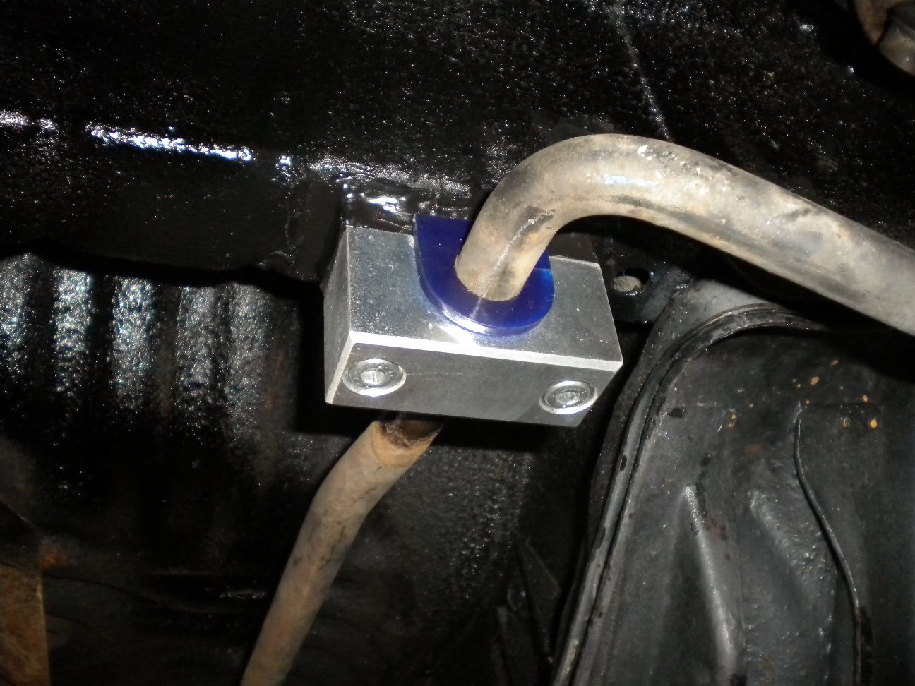

The Mk2 brackets are square dog legs and won't fit the Mk1 chassis, so Mk1 front brackets work.
By far the best option is to use the "no bullsh1t" mounts made by Adamh over on TB, we invented the Mk2 turbo ARB mod on the Mk1 but Adams mounts just finish it off prefectly. You weld one half of the casing to the chassis and the other half bolts to that, properly over engineered works of art.
