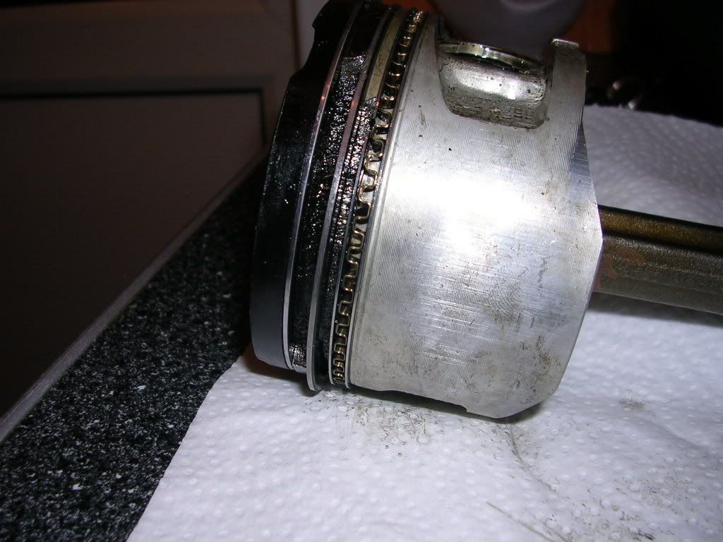

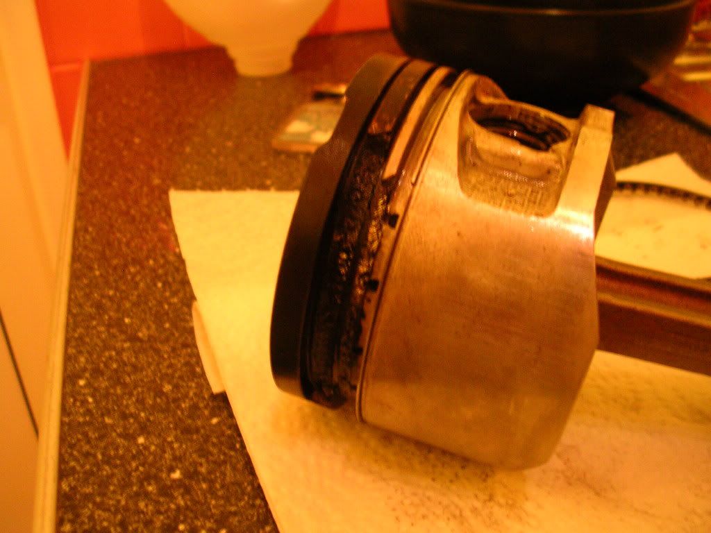

just got head off and pistons out and found piston has broke again taken piston in to engine specilast and have been told it has gone because its over fueling. just wounded what could be causeing this.

The stock pistons get damaged all the time from knock.
The stock engine is designed to run at 0.8 bar or so on 99 ron fuel.
When the boost is turned up the stock timing should be taken back to 8deg btdc to stop the knock.
All the stock turbo engines run very rich to cool them and try to stop the knock but it can only do so much.
From what I know a rich running engine will not damage a piston, if it was way too rich it could seize a piston in the bore but not damage a ring land.
Do you have a photo of the damage to the piston?

Please post a photo of the damage to your piston then we can tell you what caused it.

some pics off broken piston
forgot to mention piston ring are not damaged at all. hope this helps
