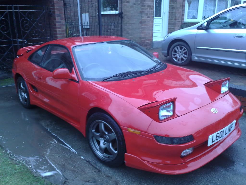

i wont be able to get pics up before and after really as the whole car is being sprayed. i may be able to get one when the car comes out of the oven but then its going to my mates unit to have all the bushes changed engine put back in etc etc.
this is the best i can do for now allthough the car will look nothing like that when it comes out. it still has these wheels on but also different tyres. obviously as the engine is out if i take a pic of it comeing out of the oven it will be about 2 ft off the floor lol
the car wont be to everyones taste but ill hopefully have pics of it done in about 3 weeks
