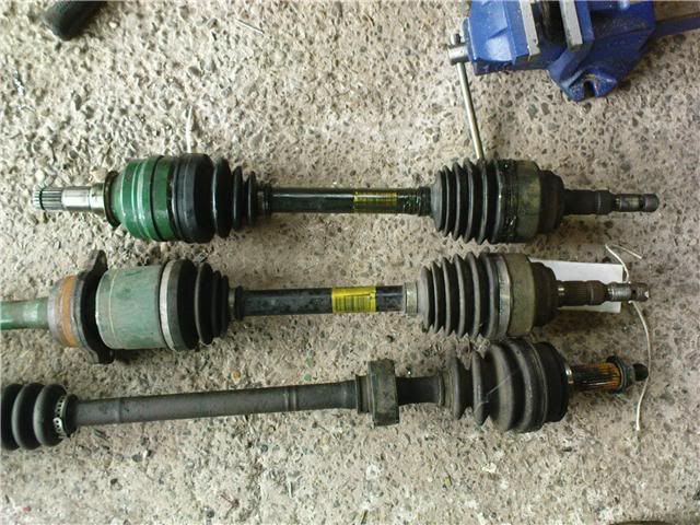

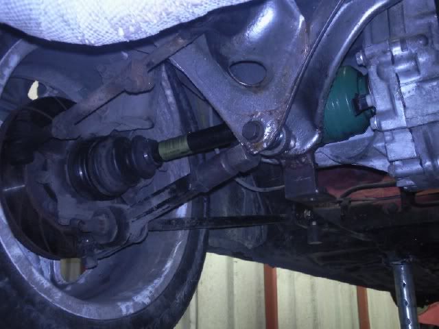

Passenger side hybrid drive shaft

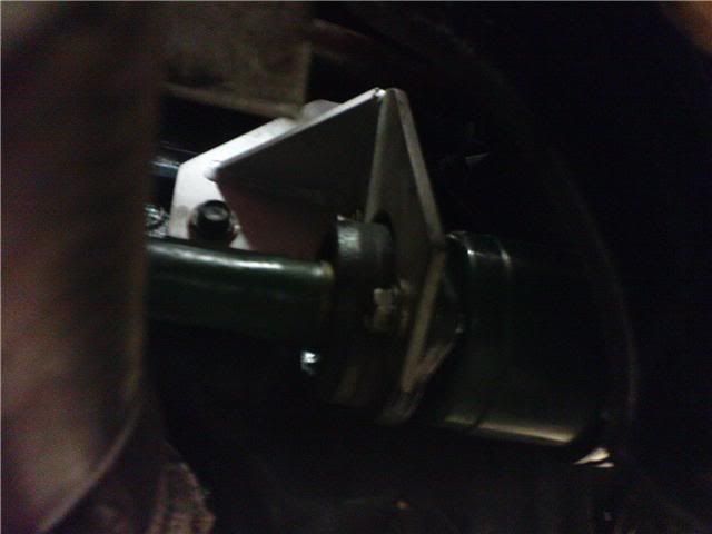

Drivers side hybrid drive shaft and bracket

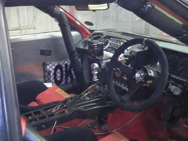

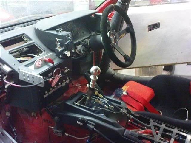

View from above, not much to see, shift cables enter the engine bay and bend round to meet the box from the rear. A lovely bracket was made (in cogboys living room) to mount the Exige cables to the C52 bell, all looks very factory.

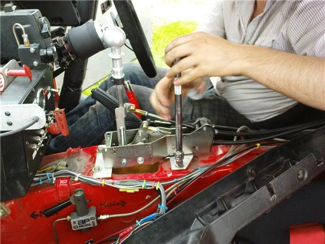

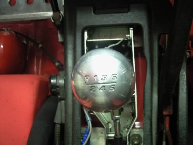

A view of the cut down Exige shifter, modified to bolt to the standard MR2 mounting points. A lovely piece of kit.
As above.

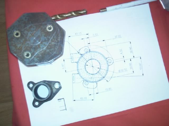

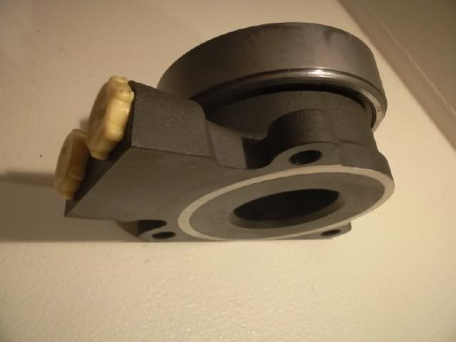

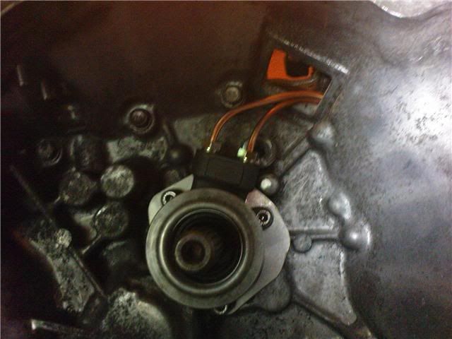

AP concentric clutch slave, machined down slightly. This mounts on a custom plate which replaces the input shaft shroud / CRB mount on the standard C52.
Making the mounting plate for the AP slave, started with 5mm mild steel but was then replaced by a very trick stainless item with M6 nuts Tig'd onto the back.
The C64 with C52 bell and AP slave mounted.

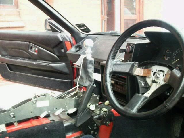

Exige shifter prior to modification. Simply sat it on the tunnel, as you can see it was a bit too long.
Fitting the modified shifter, still at full length. The shaft was cut removing about 60mm, drilled and tapped for an M6 stud, screwed back together then Mig welded. It will not brake, not even with full speed cogboy shifts (he got that name for a reason, and it isn't because he is kind to cogs, quite the opposite).
DONE!
The Lotus shafts next to an MR2 long shaft. Lotus outer cv's were removed, shafts turned down and re-splined to fit toyota outers. Using the lotus shafts also gave us a bit of extra length to cure our bellhouse smashing problems.

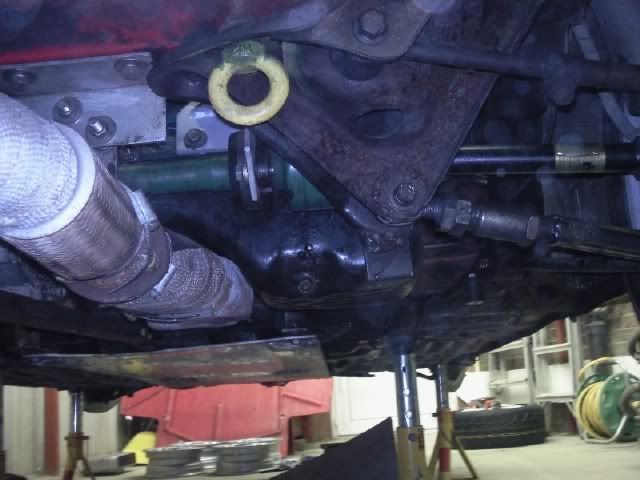

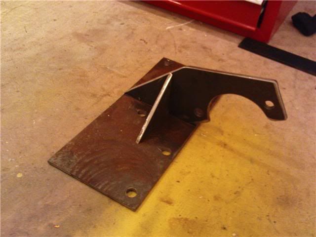

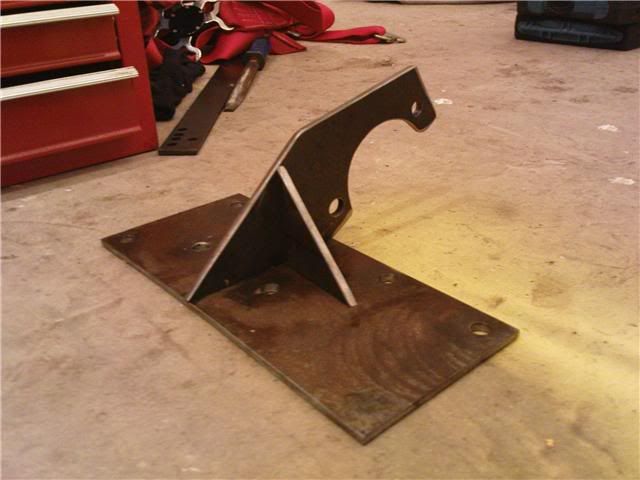

Bracket to support the two piece drivers side drive shaft inner cv. Knocked up one afternoon in cogboys front garden using an angle grinder and a tobacco tin. Unfortunately cogboys Mustang now has a fleck of rust over the rear quarter....oops.
Bracket cut down, zinc primed and mounted in place on the block. Precision engineering at its best. Grinder and tobacco tin method got us within 1 or 2 mm! There is the added advantage that the inner cv is no longer above / touching the exhaust.

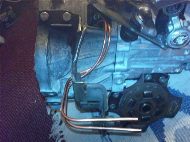

Plumbing for AP concentric slave. When finished the pipes were covered in black heat shrink and bolted to the original slave bracket. All looks very standard.

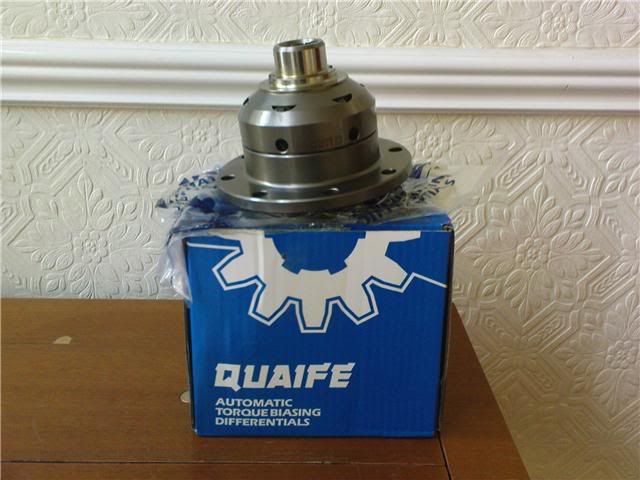

The biggest chunk of the budget (not that there was one) went on the ATB LSD, it cost more than the gearbox!
