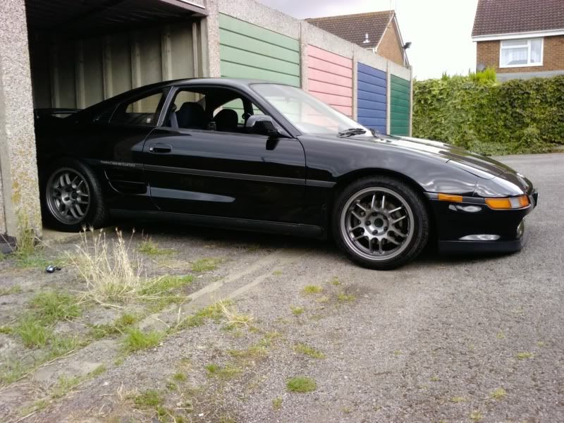

if you can see post the dirt, look closely at the front and rear tyres, big difference :(

Ah sorry yeah, its the Falken FK-452's - thats quite crazy looking at your pic there, quite a difference.

Just changed my 195/50-16 front and 205/50-16 rears for different 16's with 205/45-16,590mm front and 225/45-16 608mm rears.
Car now decks on the floor when I go into my garage :( .
However this site is v good for checking tyre height width etc.
http://www.rims-n-tires.com/info_specs.jsp
Tempted to go for 205/50-16, 612mm front and 245/45-16, 626mm rear and this will keep the front rear difference,fill the wheel arch and stop me grounding out.

Beached whale springs to mind,lol,and sits on Tein HR's
