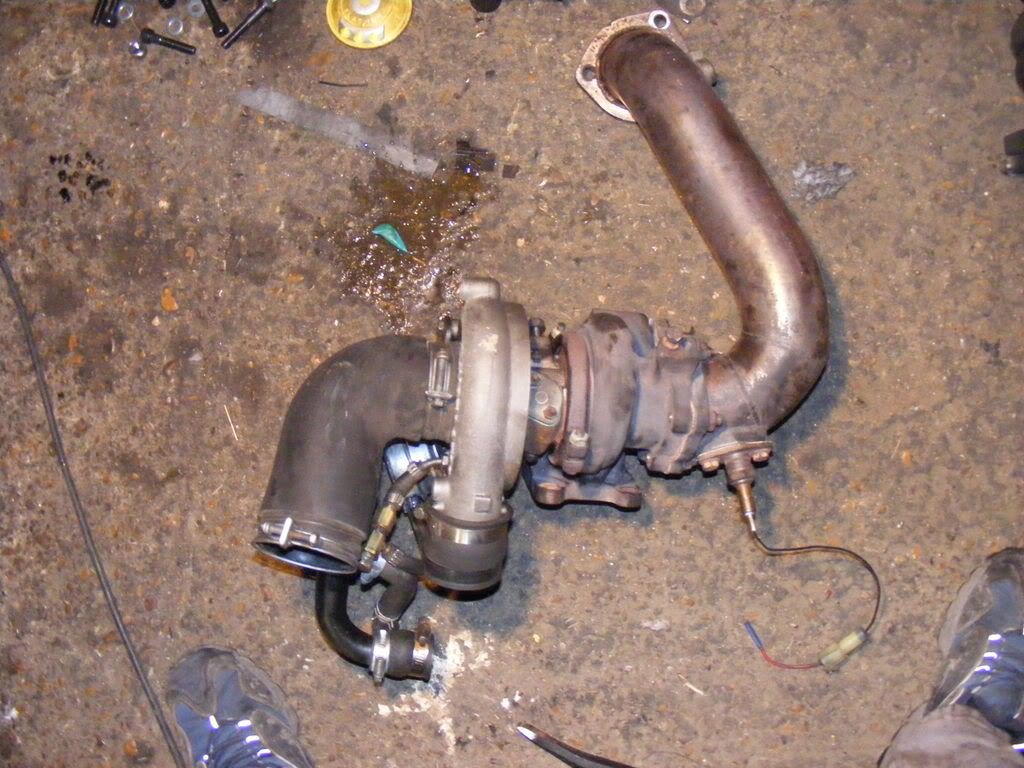

Turbo:
The turbo is a stage 1 Turbo technics CT26.
On top of it is what looks to be some type of feed pipe that has been blanked off.
Pic Below:
Could anyone tell me what this is and why this might have been done?
Additionally should I change this during the rebuild (eg: attach what has been removed) ?
Thanks in advance for your help.

the pipe from the turbo, is the pipe to the actuator i believe.. but if that has always been blanked off then i'd imagine the wastegate would never open, and you'd be hitting fuel cut all the time or running as much boost as the turbo could make. :-k i'm sure somebody will confirm soon.
Conrods coming loose is probably caused by knock/det.
I'll let someone that knows confirm :thumleft:

The lambda sensor doesn't have any effect when you're on-boost but should keep the mixture correct when cruising off-boost. A leak like that shouldn't have had any rfeal effect on reliability but might have been costing you fuel consumption.
As for the turbo, which bit are you talking about that's blanked off?
There's a 2-bolt blanking plate in the middle, but also a pipe on the right hand side of the picture.
The pipe on the right is the feed to the wastegate but it sounds like that's been working fine so I'm guessing that you mean the 2-stud blanking plate on the main bearing housing.
That's ok as well. There should be one plate that's blanked off and another connection on the other side that has a feed pipe that runs to the engine block.
I've heard that these engines are very susseptable to running low oil. I think my old engine went the same way as I'm fairly sure that I spun a bearing due to running low oil and not changing it frequently enough.
