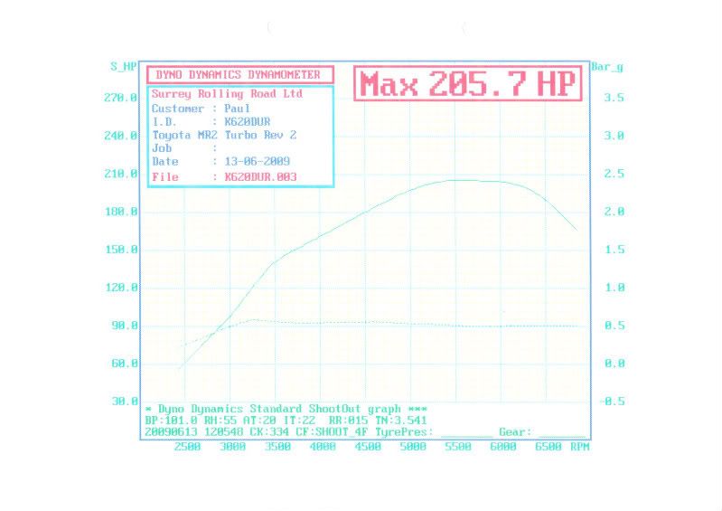

Went to Surrey rolling road today with 9 Skylines,wasn't going to run the car only watch, however a few people dropped out and they needed a min of 10.
Anyway the car is a rev2 turbo and is bone stock with 95000 miles.
Max power came out 205.7 with .5 bar boost and was told it should be .7 bar (doesn't sound much difference :lol: )
Was told that the actuator was most probably the cause.
Could barly hear mine over the bloody big fan,max skyline db reading was 123 db.
However I'm happy that it made 200 after 16 years.

Your looking around 10bhp per psi of boost increase if i remember correctly :-k , which means in theory you are running pretty much stock power.
Thats obviously a very healthy engine :mrgreen: You should be pleased.

Not a bad result mate my stock rev 2 (well apart from a filter and exhaust) made 222bhp @ fly and 186@ wheels on stock boost which on mine was 0.6bar :thumleft:

if its making a constand 0.5 bar then the actuator is fine and the vsv is not enabled, get it checked out :thumleft:
