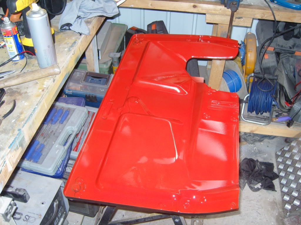

when i put the tubby lid on my n/a the screws wernt to clever the rain tray is quite heavy to be honest, i filled mine with epoxy resin but that was off the car so it went off whilst flat, bit of a problem whilst still on the car i cleaned and painted my tray whilst off the car aswell. :thumleft: :thumleft: :thumleft:

nofearmadbiker wrote:when i put the tubby lid on my n/a the screws wernt to clever the rain tray is quite heavy to be honest, i filled mine with epoxy resin but that was off the car so it went off whilst flat, bit of a problem whilst still on the car i cleaned and painted my tray whilst off the car aswell. :thumleft: :thumleft: :thumleft:
Image Replaced With URL For Quote http://i182.photobucket.com/albums/x222 ... ics021.jpg
Image Replaced With URL For Quote http://i182.photobucket.com/albums/x222 ... ics020.jpg
Image Replaced With URL For Quote http://i182.photobucket.com/albums/x222 ... ics024.jpg
Image Replaced With URL For Quote http://i182.photobucket.com/albums/x222 ... ics028.jpg
so u basically made your own rain guard out of fiberglass resin using the origional as a template? :-k take it that worked?

no i filled the holes where the screws go to re-thread them, so as screws hold the rain tray now, just like if you would re-tap a thread on something metal done the job nicely. :thumleft: :thumleft: :thumleft:
