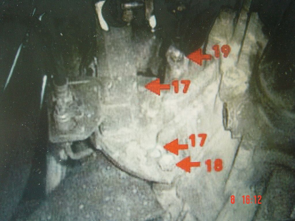

Is this where the fifth bolt would be ?
Bolt number 19 on this pic
There doesnt seem to be any bolt 19 on my C52 box
Wondering if the pic is of a C51

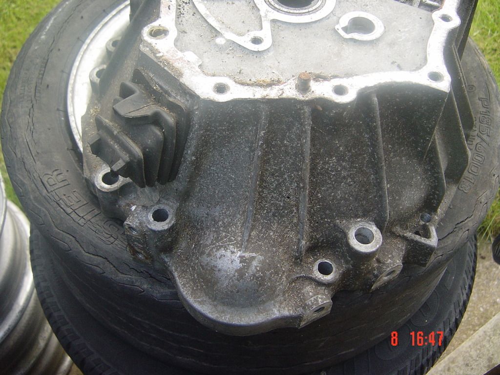

Below is the casing of my "old" gearbox
Clockwise, you can see the hole for the large bolt that holds the trans at the bottom and also the bottom of the gearshift bracket
Then the two starter bolt holes
Then the two large holes to hold the top of the trans
Again no bolt 19

elbon50 wrote:
1 with 14 mill head near output shaft speedo drive side (goes through lug on bottom of engine block at back & into transaxle casting)
So where the heck is the fifth one :?:
Should be near to that one from memory.
It is common for the locating dowels between engine and gearbox to get stuck pretty tight if it's not been apart for a while though so it might just be a case of "more elbow grease required".
I usually start on the inlet side down near to these two bolts and try to drive an old screwdriver between engine and gearbox to get things started.
That bolt 19 you've marked is on the wrong side (and I think is one of the starter motor bolts)
