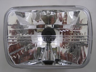

Just seen these on eBay.
Has anyone tried these and are they any good? My lights are pretty poor so I would like to do something so I can see better in the dark.
[url=http://cgi.ebay.co.uk/Crystal-headlamp- ... 40%3A1318/[/url]

He says they are RHD MOT legal but i can't for the life of me see how thats possible.....
Where is the kicker pattern in the lens?? the lens looks symmetrical to me?
Headlights need to have this \____ pattern in the lens for dip beam kick pattern.This is what makes LHD and RHD lights handed,these do not look handed at all,just a word of caution.
