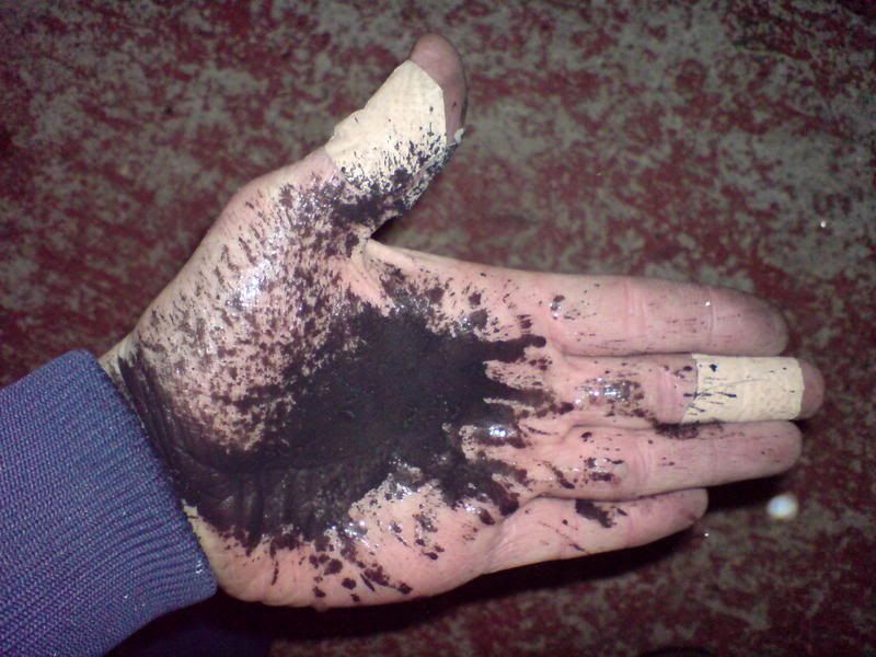

Black liquid from exhausts:
If I start it up in the garage and leave it sat still it'll spit little drops of black liquid out of the exhausts. After just a couple of minutes there are stains on the floor where these have landed and dried out. Quite a few cars do this a bit, but if I hold my hand over the exhaust and rev it, this happens:
I used to think it was overfuelling but I've leaned it off as far as I dare and it's made no difference.
