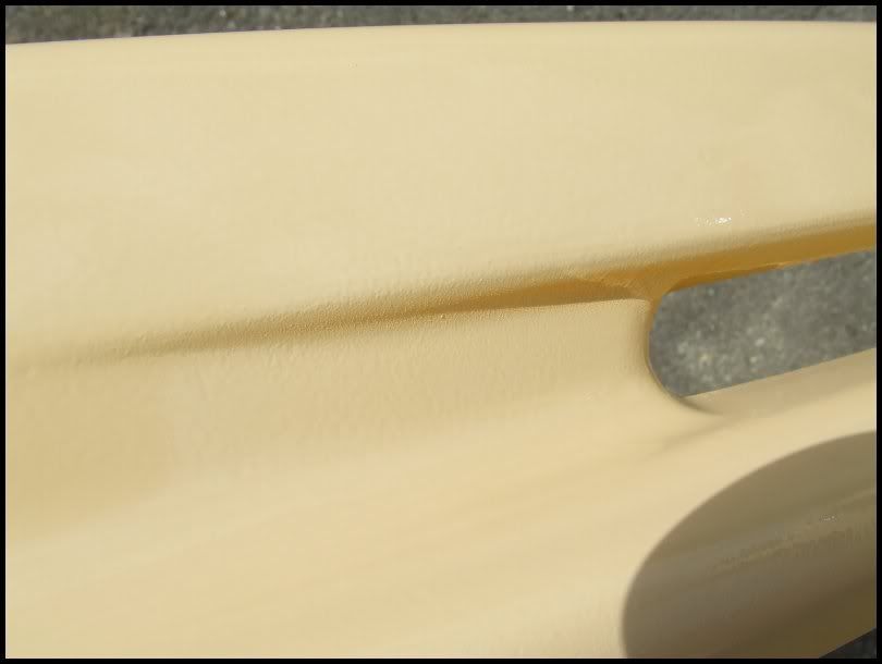

As for what the paint looked like, I've only got a small photo of what happened which I cant really tell whether it looks like orange peel or not. However from what you guys have said it does seem as though it was an error on his part. Oh well all sorted now and I've learnt a bit along the way :)

doesnt look anything like that, heres the pic I got sent....

ah yes i see!
Thats rather odd, especialy the way its confined to one area!
