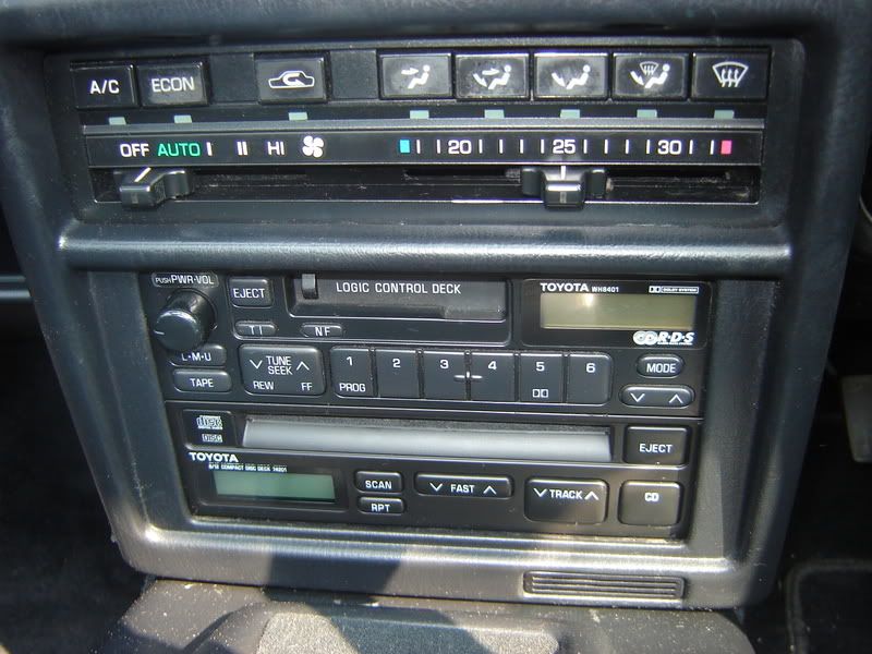

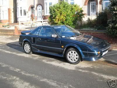

Evening one and all, i'm the fella that owns the mk1 that Superchargedsam said about, some of you may of know of the car or seen it already, it was the the blue one advertised on ebay for sale earlier on this year,
As far as i know the one i own is not a "Pinewood" as such (just ignore what Sam says most people do :tongue: ) but the system may of been installed by them. When i brought the car it was 1 owner from new, now the fella i brought it from used to work for toyota, at which dealership i cant remember as the car was first registered in his wife's name, and he was able to buy my aw11 at "trade cost" as it was when the sw20's were now being onto the market and old stock needed to be sold off to make room, from then he sent it off to whatever dealership/company was fitting air-con / climate control at the time and paid to have it installed, again i presume at trade cost within the company, and from 1990 untill 2007 it was used as a run around, school run and trips abroad by his wife and himself untill sometime at the start of this year the engine drew it's last breath and decided that with 78,000 miles under its tyres, con-rod number 1 was no longer fit for this world and severed it self from the crank,
and this is where i step in, winning said car through ebay earlier this year, i have replaced the engine with another 4age, donated from Sam himself , the car is now up and running under it's own steam, but being busy with work and other commitments i have not had the time to get it through a MOT but rest assured it will be on the road sometime, just not anytime soon :thumleft:

WOW! Now that is incredibly rare. Does it still work? ;)
Also very rare to see the toyota CD player, even Mark's Super Edition doesn't have that.
