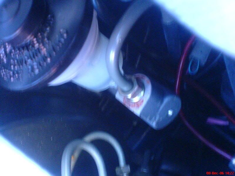

This is the first I've heard of this check valve!!
Where abouts is it? Got any pics of its location? I'll have a looksee in the BGB to see if I can find it.

follow the master clynder line and there should be a brass union it goes to which is bolted to the bulkhead, bleed either side of this

oh yeah. I hadn't noticed that before. Will give it a looking over. Looks a right pain in the ar$e to do :?

Ahh right... Yeah thats the first union on the master cylinder.
I've undone that and had fluid running out. Have also done both sides of the check valve a little further down the hard pipe.
