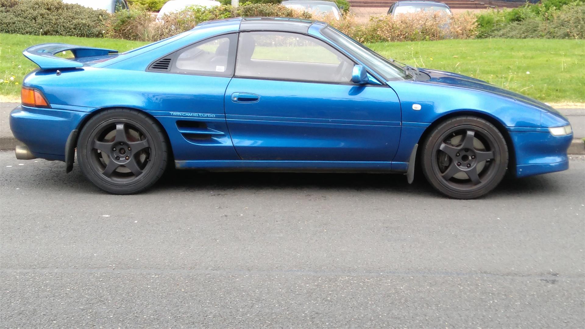

anyone got part numbers from their H&R lowering springs? I bought some -20mm which have 29884 HA stamped on the rears but compared to stock OEM (22yo springs) the drop is a lot more than 20mm. Looking at the part number on the spring it seems most places are quoting -1.3inches which is nearer 35mm
pic for show of the weird drop, fronts are a good bit higher than the rears

Hey pal, I'm also on the H&R set that you're using. I would say mine is slightly biased to the rear like yours, I can upload a photo if you would like, for comparison? It looks like your rear is a 45 profile tyre and the front is a 40 profile, or is that just my eyes haha! If thats the case that may be partly the reason for the difference in tyre to arch distance. Also worth saying that the front of mine started a little higher but did drop after a few months, come to think of it the back did as well to be honest!

Here you go pal, on 17's as well, 225/45 rear and 215/45 front though.
Actually that image pretty useless because of the light, have a scroll through on photo bucket, there are probably some better ones!

thanks for sharing, yeah that looks similar to mine tbh. The retailer got back to me and apparently H&R are advising him that the fronts should have 20mm cut off the bump stops............. I might be missing the point here but isn't a set of -20mm springs supposed to drop the car 20mm? I hate to think what 40mm drops do. Now it rubs on the rear and looks crap on the front! :cry: :pale:

Here's the photos as promised...

Looks ok, does seem a bit lower at the back.
