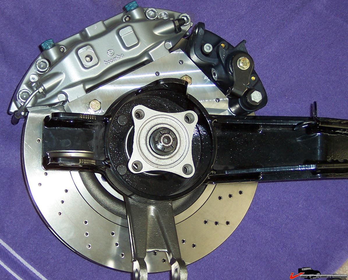

Well http://www.vettemod.com/forum/imagehost ... 8aa916.jpg was just going to use a mechanical spot caliper like used on lambo's,Aston Martins etc, after all, making an adapter bracket with 4 lugs won't be much harder than making one with 2!. Only trouble I am having now tho is sourcing a spot caliper that fits over a 32mm disc! Until I actually looked, I assumed the wilwood ones would do the job but turns out they only go up to 12mm disc width or something? I know brembo do one that's perfect, I even have a part number but I cannot find anywhere that sells them so I have no idea what they cost.
Just found this on Google, pretty much the same idea I was thinking, uses the brembo spot caliper too:

ah righto lol :thumleft: have you thought about just getting a bracket like the one you quoted made up and relocating the stock caliper keeping it purely for handbrake duties? Or you could go http://www.bigbrakes4u.co.uk/hi-spec-ro ... t_228.html see if it works? Pistons might be too large but you could dial that out with a bias valve I guess.
oteck made up a rear drum brake like nearly every other car on the planet thus gaining a much better handbrake and allowing the use of a single caliper for the foot brake and separate legal handbrake. http://www.twobrutal.co.uk/forum/showth ... ight=oteck all toyota parts too :thumleft:
