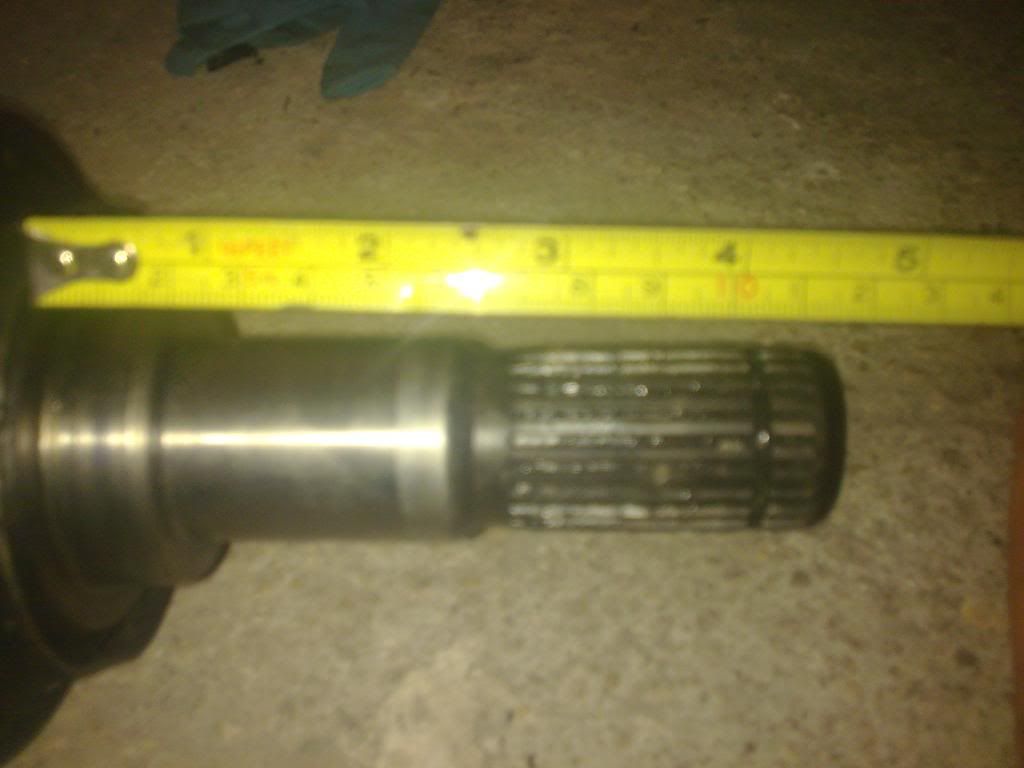

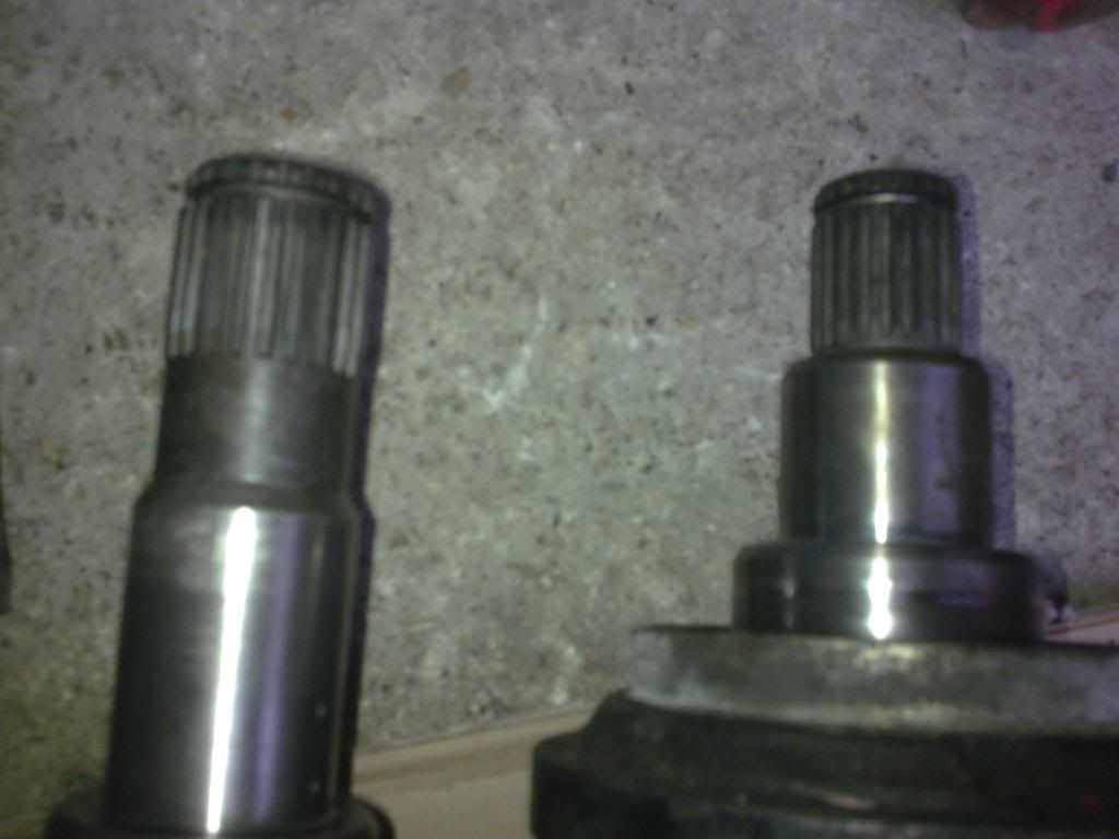

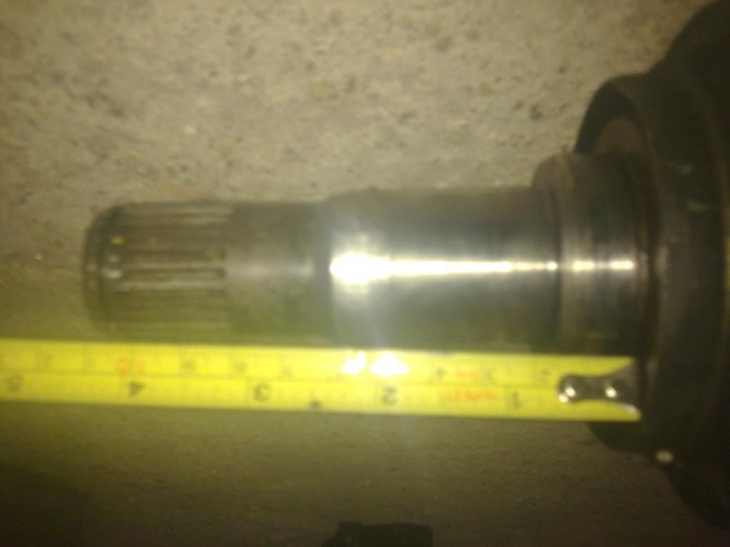

Indeed rev 1 did come with an option of an lsd - using rev 1 drive shafts as far as I'm aware.
Rev1 turbo and rev 2+ ( with lsd) have a different length splined area.
I'm not trying to be a pain here - I have some rev 1 shafts I would happily sell him BUT I dont want the chap to shell out on something that may not be suitable :thumleft:
Rev1 turbo
Rev2+ lsd turbo
Rev1 turbo and st185 drive shafts - same era of car
It looks like Peter of Sbits has come to the rescue here but thought I would post up the pictures as a reference in case any one else has this dillema.
As far as I'm aware The rev 2+ turbo lsd shaft was not available when the rev1 was comeing out of the factory so if you ordred yours with an lsd from new I believe you would still be using the rev1 shafts

slipping clutch wrote:Indeed rev 1 did come with an option of an lsd - using rev 1 drive shafts as far as I'm aware.
Correct. There is only one part number for each of the Rev1 driveshafts, whether the car had an LSD or not. And TRD list/ed two different Turbo LSDs: Rev1 for use with Rev1 driveshafts, and Rev2+ for use with LSD shafts, thus ensuring no one would have to replace shafts when fitting a TRD LSD.
