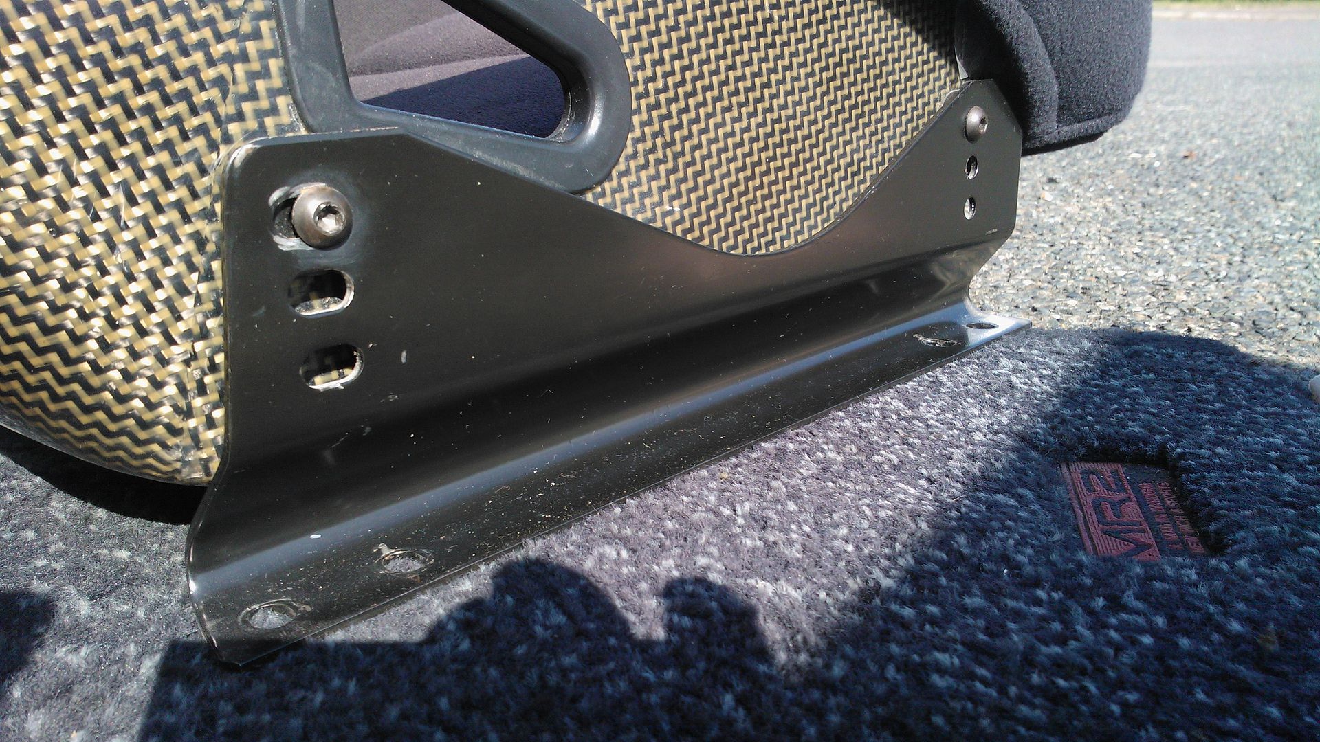

It has side mounts attached as pictured...
Can anyone tell me what seat rails I need to buy to fit this onto?
i.e Bride, Recaro, Corbeau, Sparco etc?

Could you cut the rails off the standard seats and use those, I've heard people doing that with aftermarket seats before ?

The rail that's on it looks very similar to the Bride FO-Type

Hmmm... I took the standard seat out, took juan look at the rail and pulled some epic *wtf* face... Im not much cop with cutting, grinding etc. It would only end in tears, knowing me, id weld the thing while its in the car and goodbye rare stuff :(

Nice one... Need to wait for one to come up cheap I guess. Unless someone has one? So it seems I deffo have bride side mounts?

What is the distances between the holes on metal mount brackets

The cobra's I put in Alexd's mr2 just had the side mounts bolted onto standard mr2 runners

Did you manage to sort this out , if not, there is a sidemount bride rail on driftworks
http://www.driftworks.com/forum/showthread.php?t=183879

lol rails are the wrong way round on your first pic fittings on the inside

Thats how i picked these up. Someone fit these to custom rails prior.

The side mountings are not designed to be mounted on rails, they bolt direct to the floor. You will find they are going to be way too high if on rails
