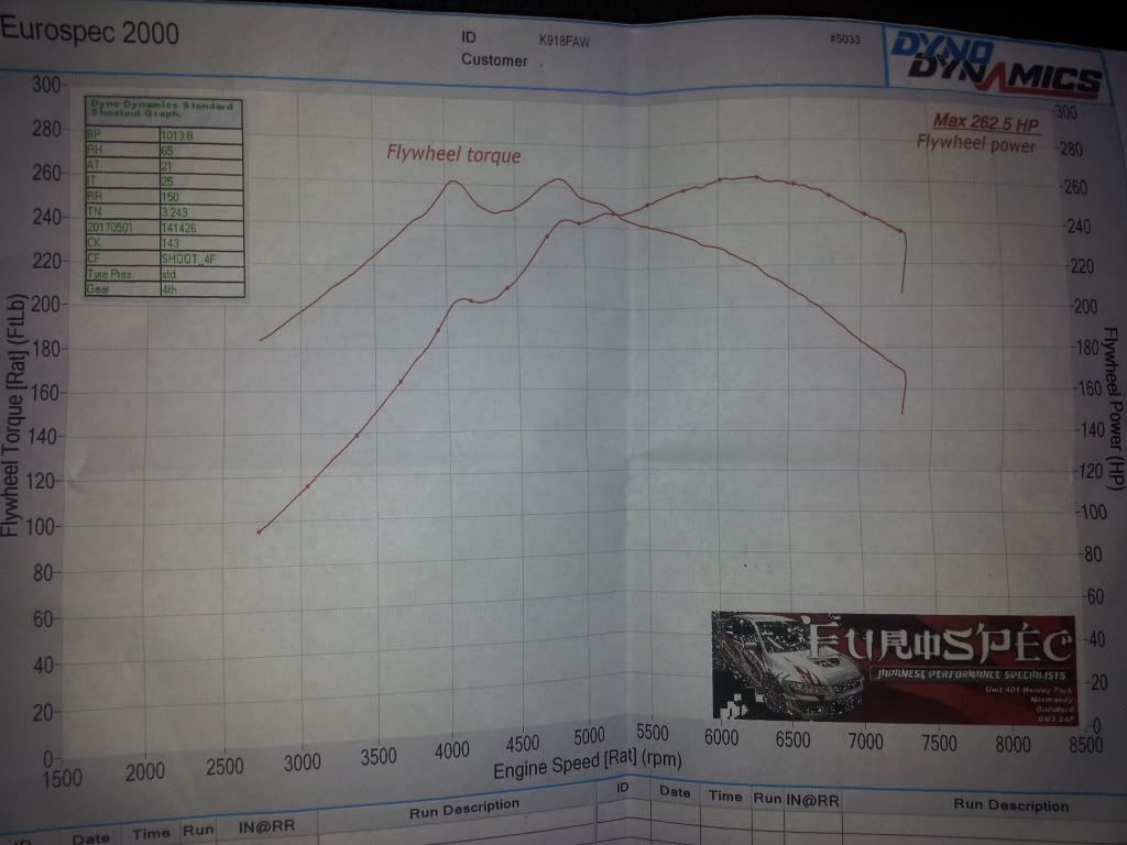

As mentioned in a previous post I did a dyno run the other day and it had two humps but the second one bigger with the torque first one@ just over 4krpm and then 4.75krpm the power curve its in humps going on too.
Once I get my laptop back I'll try and put one of the plots up. Just looking at some older plots and they are the same only the figures vary and that will be down to the different type of dyno's .

I thought it was a little less responsive so put it on the rolling road and managed to get an extra 20rwp with the mapping. Only got the engine fitted earlier this year.
The guy doing the map said I should look at the cause of the fluctuations first.
Could a dicky actuator cause this?

The power curve looks "normal " apart from a couple of dips at the same point in the graph as the torque rpm wise.

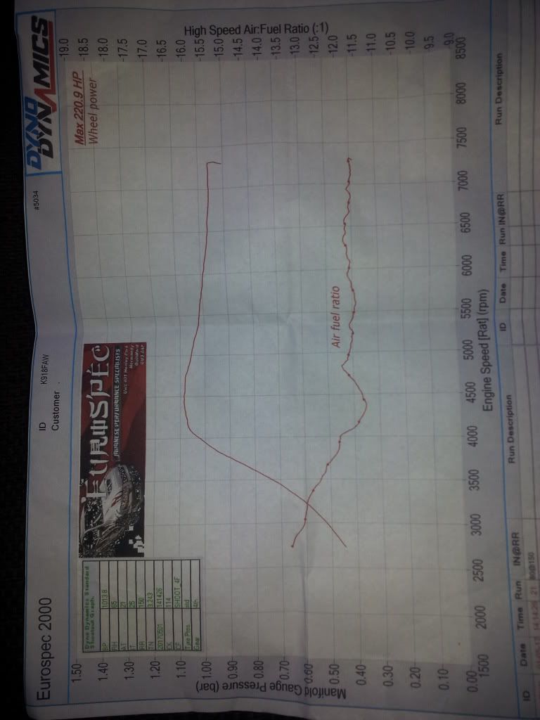

Sorry Jim being stupid, got laptop and thanks to djpkns figured out how to post pics.
Apologies for the one pic being 90 degrees out it just keeps saving that way no matter what way I rotate it.

Your fueling needs looking at, you can see the same pattern in your AFR's...what cams are you running, and are they on verniers?

That looks to be happening at peak torque.
Apart from the fueling being very rich there - possibly marginal HT / Sparks? A long time back I did back to back Dyno runs with old and then new spark plugs and was really surprised to see a reasonable gain (10 bhp) - car felt fine though with the old HT stuff on it.
