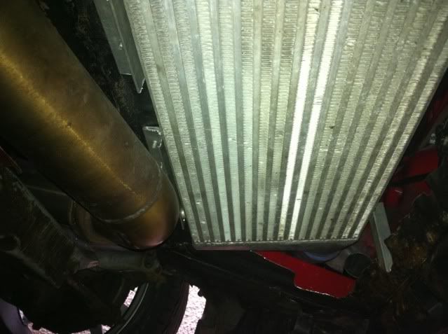

A side exit will be the only way to make full use of the bootmount. If not side exit, a custom job to run around the scoop with a full heat wrap will be OK.
Inspiration here...
http://www.imoc.co.uk/forums/viewtopic. ... ght=mapped :thumleft:

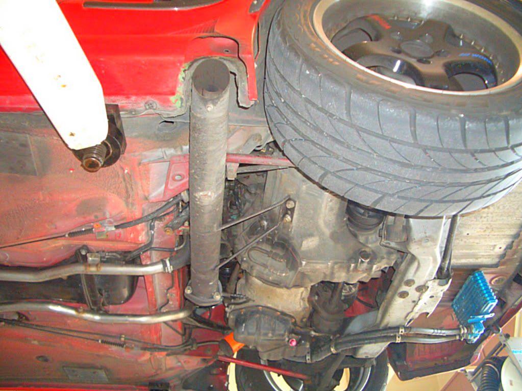

If your looking for some inspiration I found this thread on the net.. . .
http://www.mr2.com/forums/vbpicgallery. ... iew&g=1144
One of the pictures . . .
Kev.

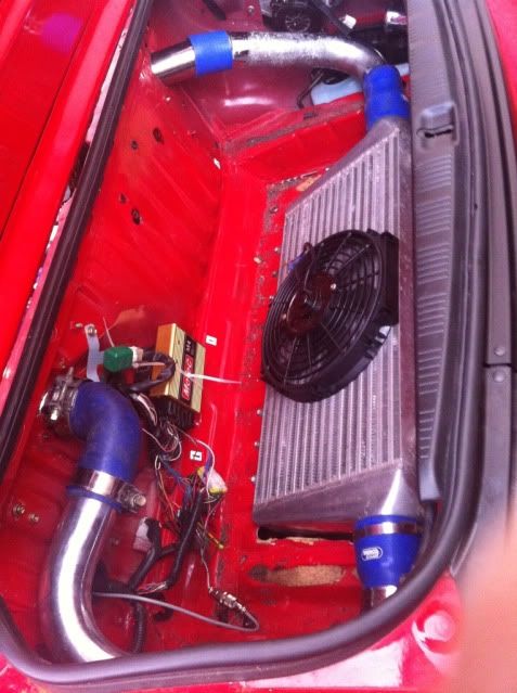

ive just altered my BMIC, it used to lay flat with a hole cut in the boot floor, but its always hard to get good air flow this way. so ive now mounted it vertically against the back panel (cut out) this has enabled me to A, duct coler air as the exhaust is further away, and B, seal it off and still have a usable boot. ill get some pics up soon of the new setup, but heres the old one
you can just see the single exit exhaust in this one
