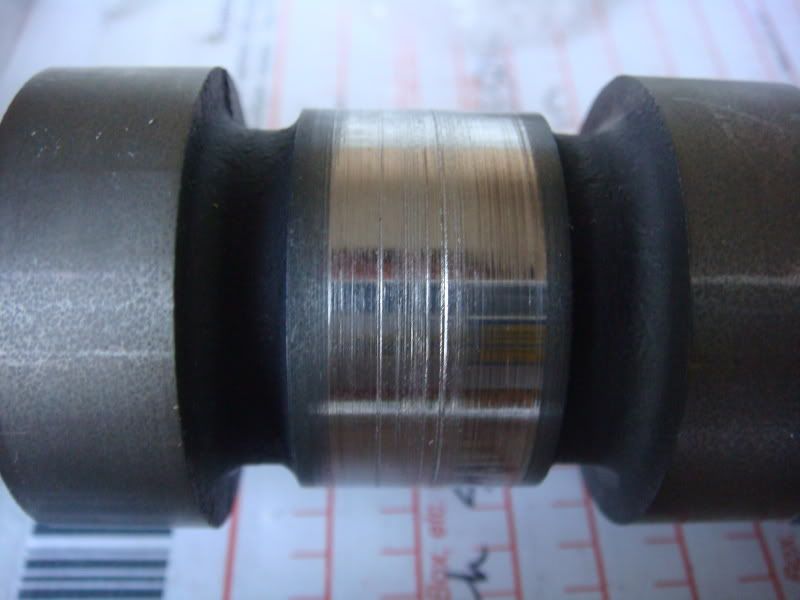

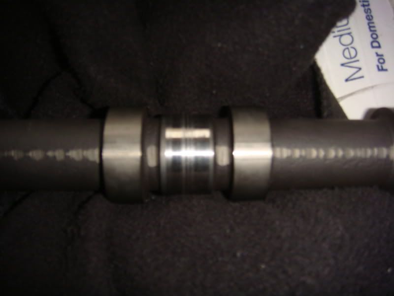

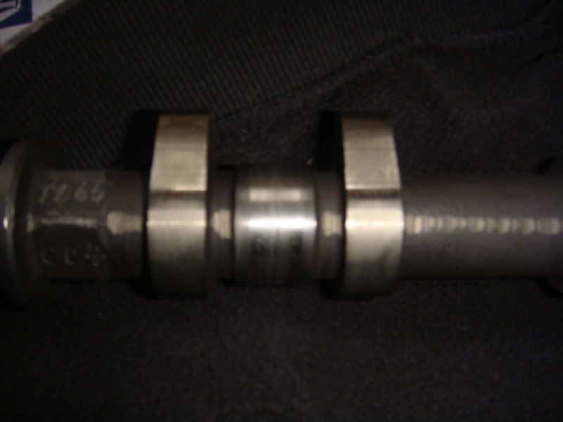

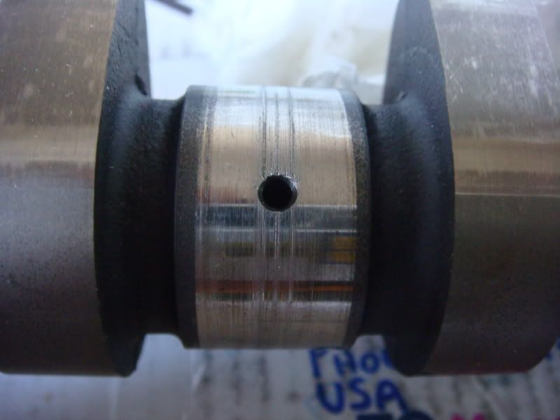

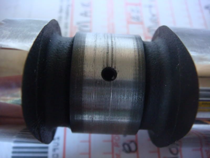

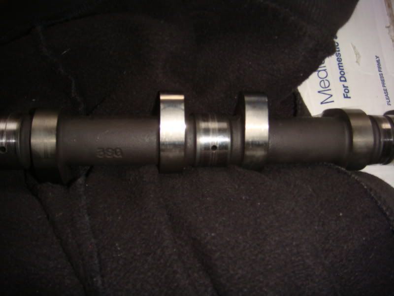

Having taken yet another look at these cams in the hope that "there not as bad as I thought" I have to say they are :( in fairness I should say that the seller has been in contact with me and whilst stating that "I didnt look at them I just sold them on" has said that he may partially refund the cost to cover repair.
Also I have taken a few more pictures and notice they say to66 on them - I would expect somwhere on them for it to state 272 - been looking on various sites for this but cannot find anyhing to confirm or dispute this.
You can actually see on the cam where something has come out of the oil feed hole and spun around in the bearing.
I will edit and post up more pictures just as soon as I get them onto photobucket - why does it always take ages for me to get the pics on there? is it my anti virus (Mcaffe) slowing things down?
Thanks for all the input guys much appreciated - just to state finally though that these cams will NOT be going in my motor unless they are repaired proffesionally.
Image.photobucket.com/albums/h117/slippingclutch/007.jpg[/
*Please note - just found out the to65 and to66 are the correct numbers for hks 272's *

little picture update - I think I was a little optamistic thinking I could polish these marks out #-o

Yeah- that scratch in the first picture looks pretty deep mate :(
