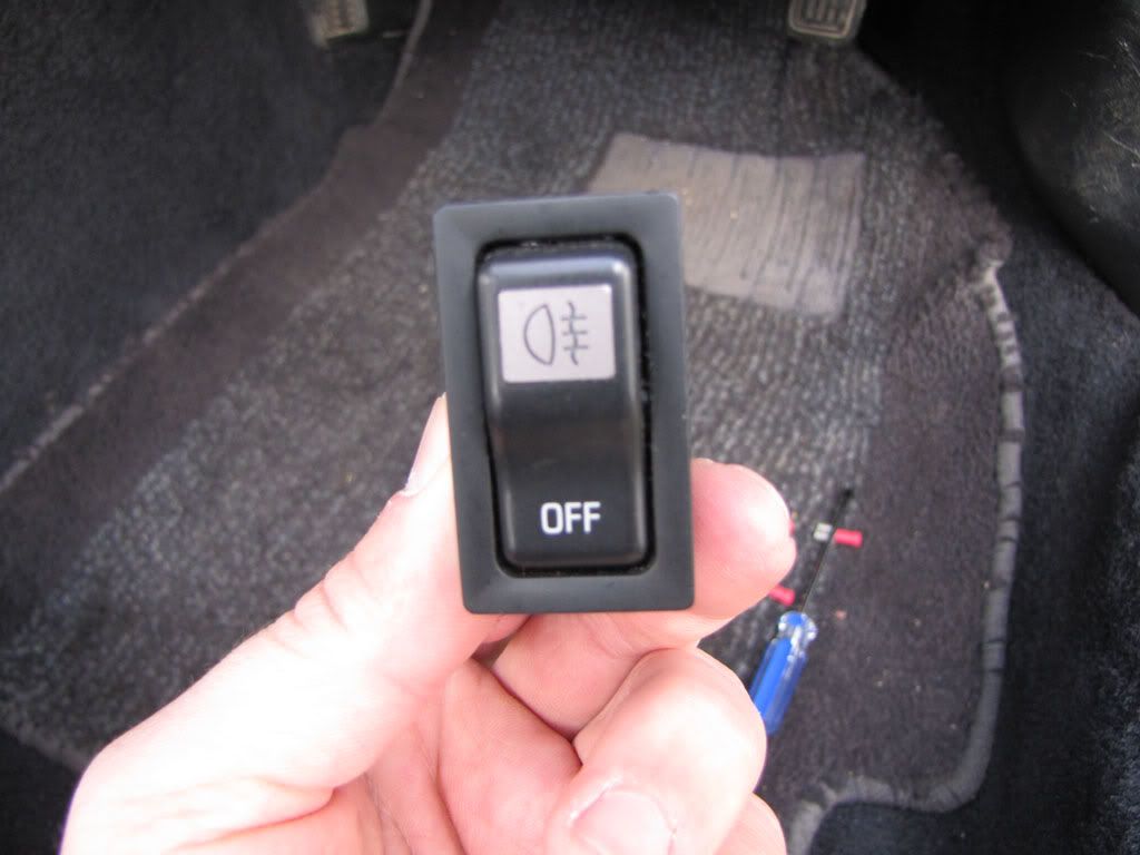

So my front fog lights are not working at all neither of them ... switch on the switch but nada ... nothing. (the switch seems to be incorrect one as it only a on / off MR2 .. UK I think ... ) however the switch shows a fog light and horizontal beams coming out of it ... this usually in all the cars I had indicates it is the rear light ...
However the rear (after market) fitted fog light has it's own after market switch and it is working fine ...
I suspect that someone has replaced the front fog light switch ... but with an incorrect one ... ie if the car had the japanese 3 way switch and someone installed a 2 way UK reverse fog light ... I would assume it will not work.

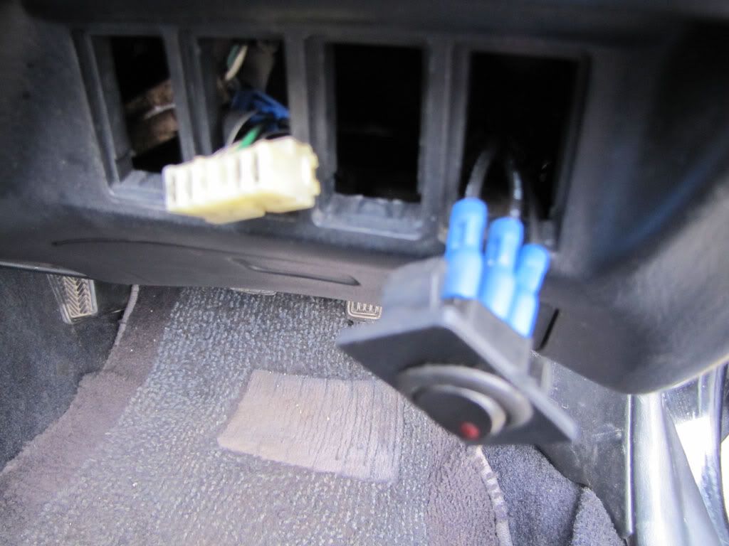

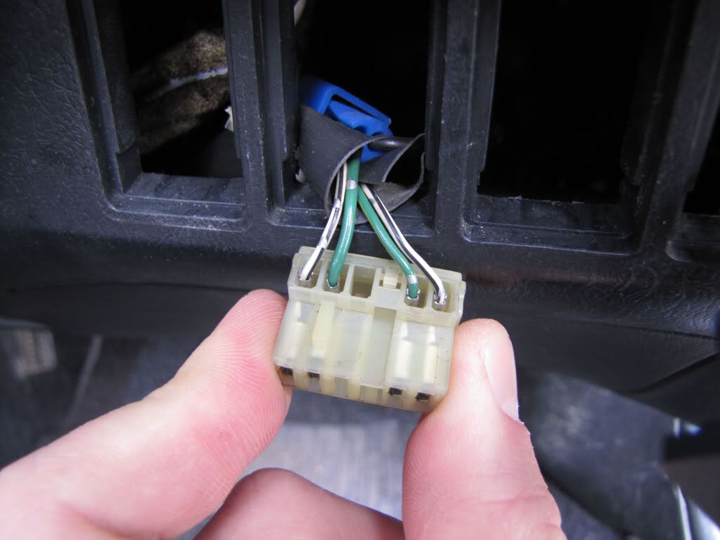

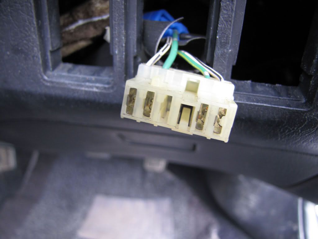

OK there is a problem ...
I have the plug attached in the picture on here ...
and then that plug does not fit on the fog light switch (which I am convinced it is for a rear fog UK car) ... I managed to fit it by bending the plastic a bit ... and tried to switch on and tadaaa burned the fuse!
lol

Your switch and plug are consistent with a car that doesn't have steering fogs fitted, I think. I say I think because they are the same as my car, which doesn't have them. You can also check in the frunk, if over on the right by the fusebox and the retractor relay you have another relay called fog ref or something similar.

Edit: It also looks like the wiring for your front foglight switch has been mucked about with (I see a scotchlock, which is an evil hateful thing) presumably to fit the rear foglight. It'd be worth checking that out too, to make sure the wiring to the switch is still solid.
