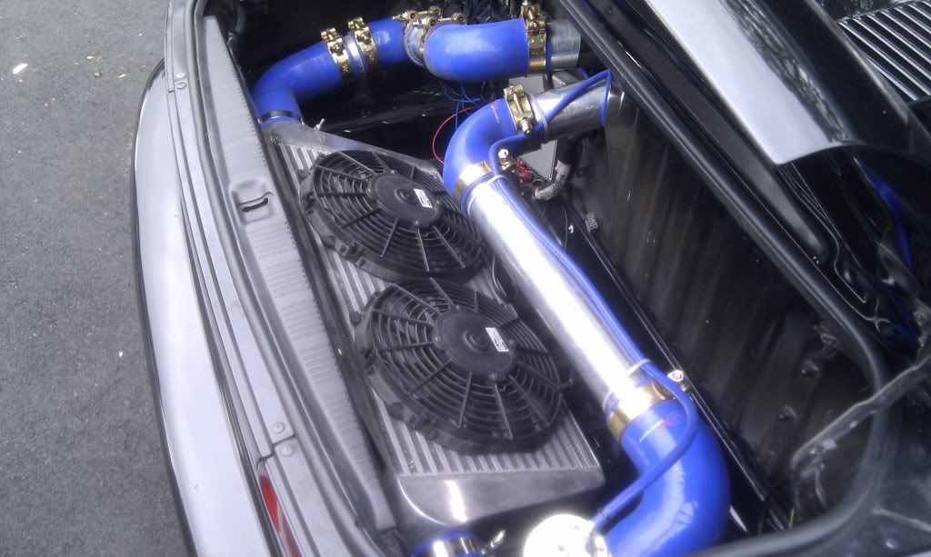

Spent the last few days fitting the bootmount to my car that i purchased from Steve Horrocks
Have to say i'm very impressed with it, can drop from 38deg c at idle to 23deg c on full boost in no time
Got a bit more lag but after taking on what has been said i'm on the hunt for a bigger turbo when funds permit

Re: [Mk2] [Turbo] Aiming for 400whp, advice sought please
Oh man! That IC setup looks cool! Lol.
I miss it already!
As for injectors.
Stock 540 yours 780 so that's 69%.
So alter PFC to 69 or 70% should be safe to get down there.
Sure you don't want a big ol' T67 to make use of it all?!
How did it fell making that first cut innthe boot floor?!
As for injectors.
It was a bit weird taking an angle grinder to my car
but ultimately it will be worth it,i'd love to take that T67 off your hands but i'm skint to put it bluntly,love the reaction every time i open the boot and somebody sees the IC and pipes
it's a cross between OMG and
'are you mad?' I'm going to use the td06 to it's full potential first and then when my credit card has recovered i'll likely get a GT3076r i think
PS i forgot to ask,did you have an issue with the hot pipe rubbing on the ignition leads above the dizzy? hence the temporary rubber insulator
Err, no rubbing as far as I can remember.
Although, I could just not have noticed! Lol
Although think my turbo had the hot pipe running higher
& further to passenger side.

That will be it,bit of size difference between a td06 and a t67,had to use a spacer on the turbo outlet so the hose would fit
