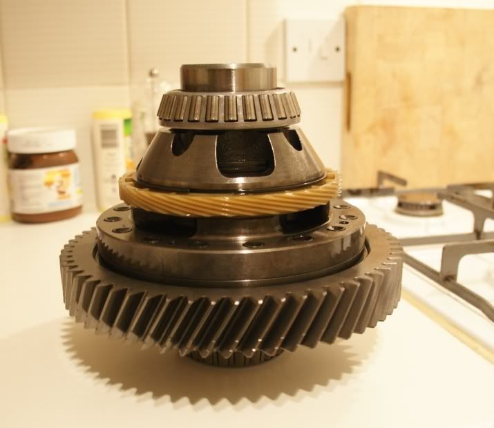

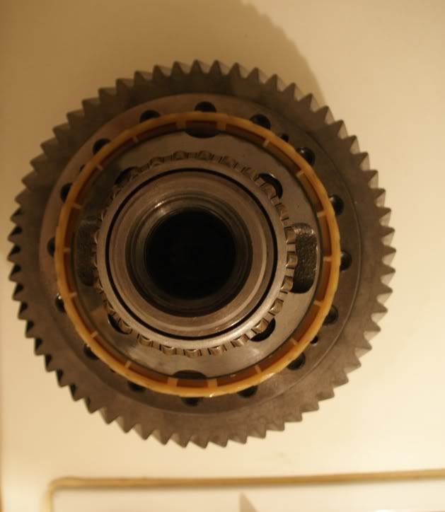

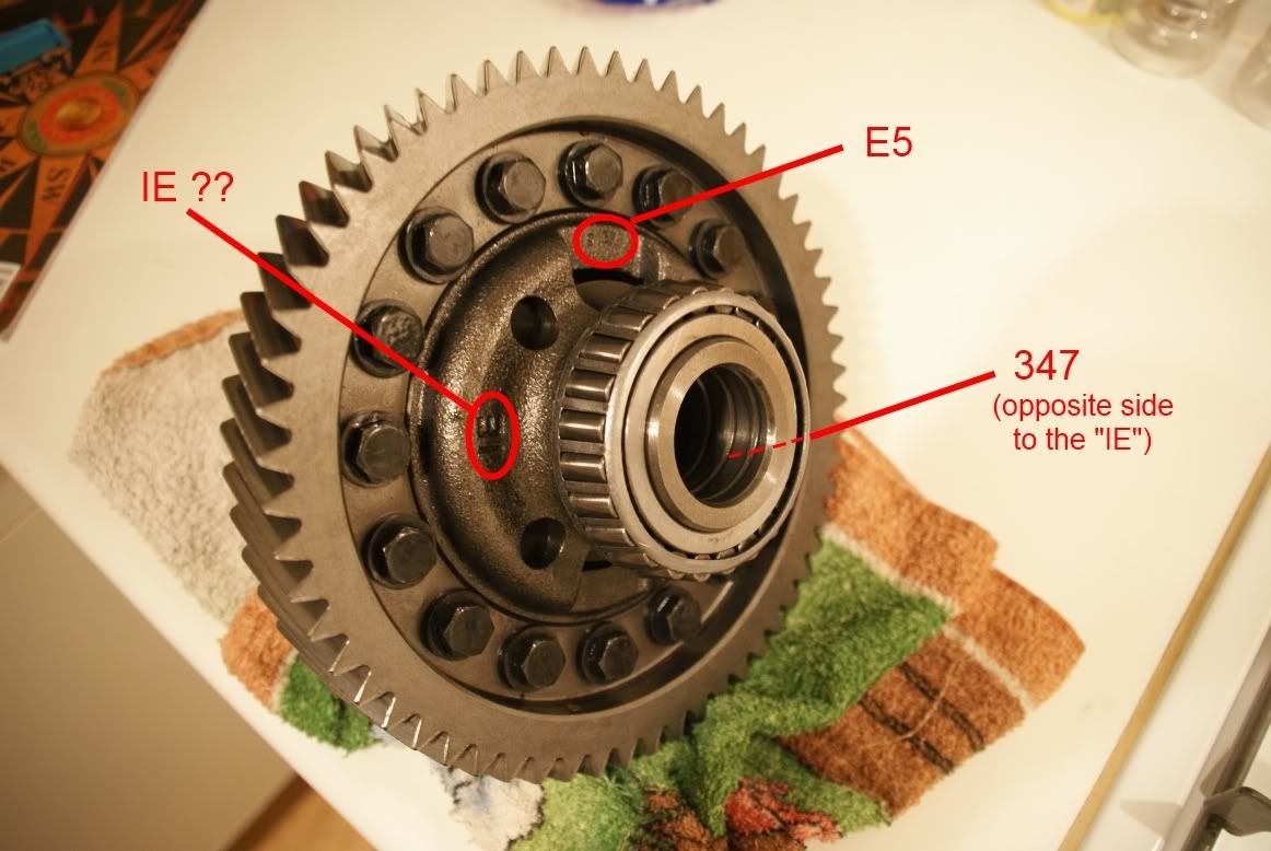

After a gearbox replacement on my Rev2 tubby, I had the existing LSD removed from the old broken gearbox.
The diff was very aggressive with heavy shuddering when accelerating whilst turning and often locked up the inside wheel so I know it's not a stock diff.
Matt at Rogue said it felt like a TRD 1.5way diff when he drove my tubby on the old gearbox.
However, the casing looks standard and there are no branding marks on it (which I believe is normally the case anyway).
(Right click & 'view image' for full size)

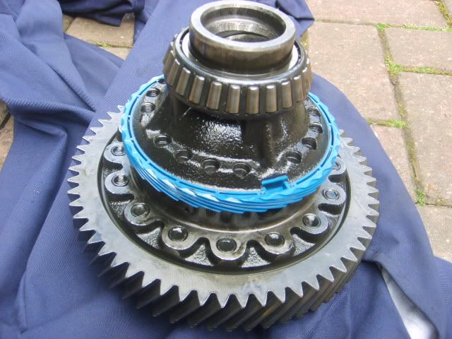

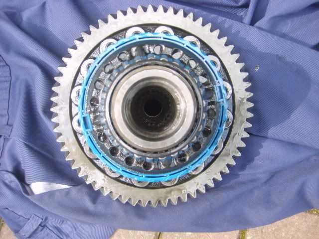

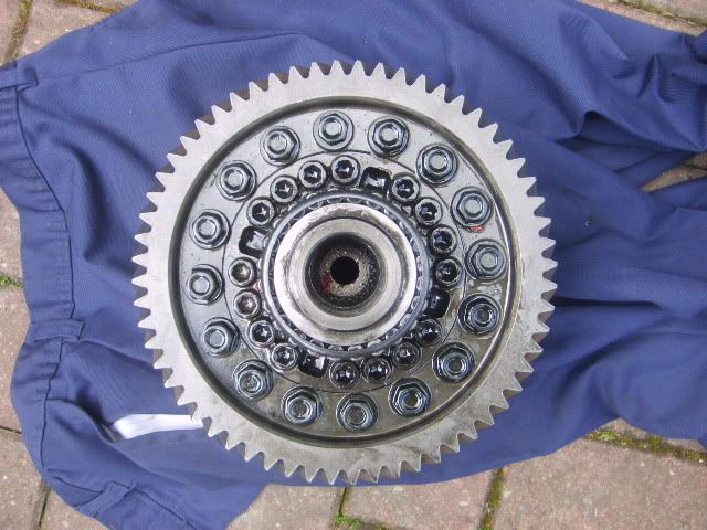

Not trying to thread hijack but thought I would add these pics to help out.
From a Rev 4 box, dont believe its stock as the box looks like it has been opened before.
If anyone has any pics of a diff. that they know is 100% stock then post them up so we can compare. :thumleft:

Hmm, no yours definitely doesn't look stock.
Here's some guy in Germany selling one that looks identical to mine (and claiming it's stock) for £1000!
http://cgi.ebay.co.uk/Sperrdifferential ... 3183wt_920
Maybe mine has the original casing but different internals because it definitely didn't drive like a stock diff.

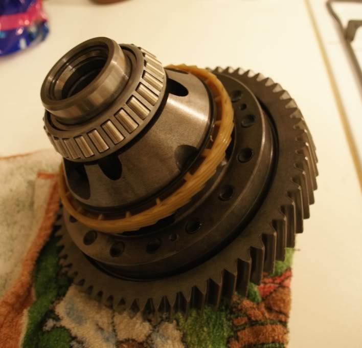

This is a Kaaz 1.5 way diff which I fitted to my car:

Now that LOOKS after market...^^^^^^^ is the nylon/plastic cog on the other 2 diffs where the doodah connects...if so where does it fit on yours?

Isn't that from a mk3?

no.

djpkins wrote:what makes you think that yours isn't stock Olly
Just because of how it behaved when it was in the car. Really agressive, shuddering when cold, locking the inside wheel. Matt at Rogue Motorsport also remarked that it didn't handle like a stock diff.
