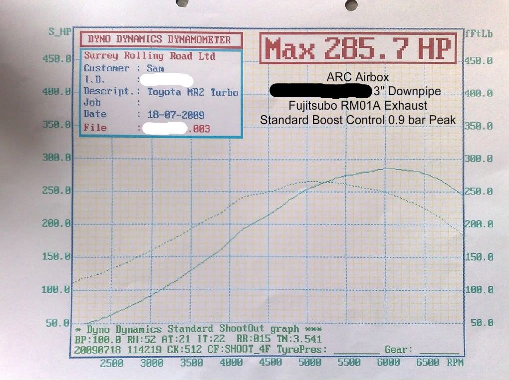

I don't know. It look standard to me. I am new to turbo's. I have owned an NA for about 5-6 years on and off. This is my first turbo

Power curve is almost identical to mine which as far as I know has a stock turbo.
Mines just shifted to the right a bit, I guess because of the decat.
Pete, heres my boost graph, you can see mine tails off too
yeah a electronic boost controler should definatly be your next perchase then a trip back to the RR to get the boost set up properly. an EBC should 99% cure the tail off, but some degree of tail off is normal and will happen whatever the sercumstances.
