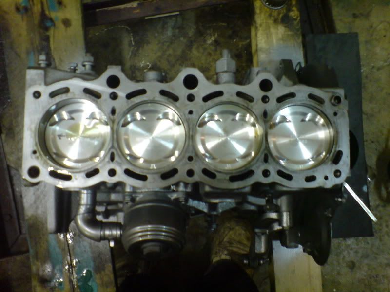

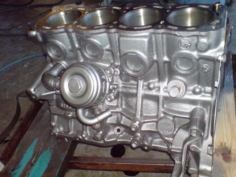

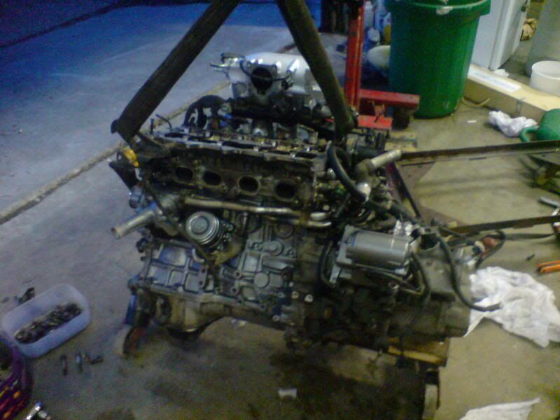

Anyhow .I soon set to work . The engine was stripped down and inspected all was as it was when it left the toyota factory .big and main bearings were like new , bores still had the hone marks around them ,,and there wasn't any oil leaks
This made life a little difficult .for a week or so i was deliberating whether to get a new block ,after hearing the horror stories of rev3 thin blocks .Or to get my current one sleeved .Or just to chance it seeing as i wouldn't need to go oversize on the pistons
I decided to risk it .I only hope it all goes ok
The block was lightly honed .and painted , not for bling but just to freshen it up

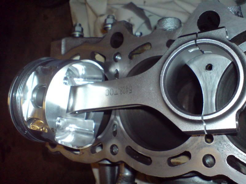

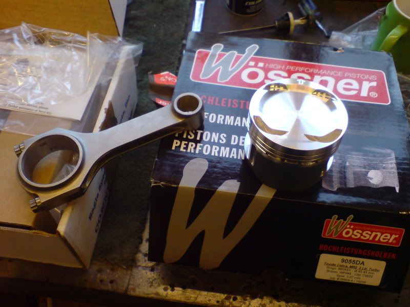

Then the wossner pistons and eagle rods , which Peter Gidden supplied were assembled and fitted and the rest of the bottom end reassembled

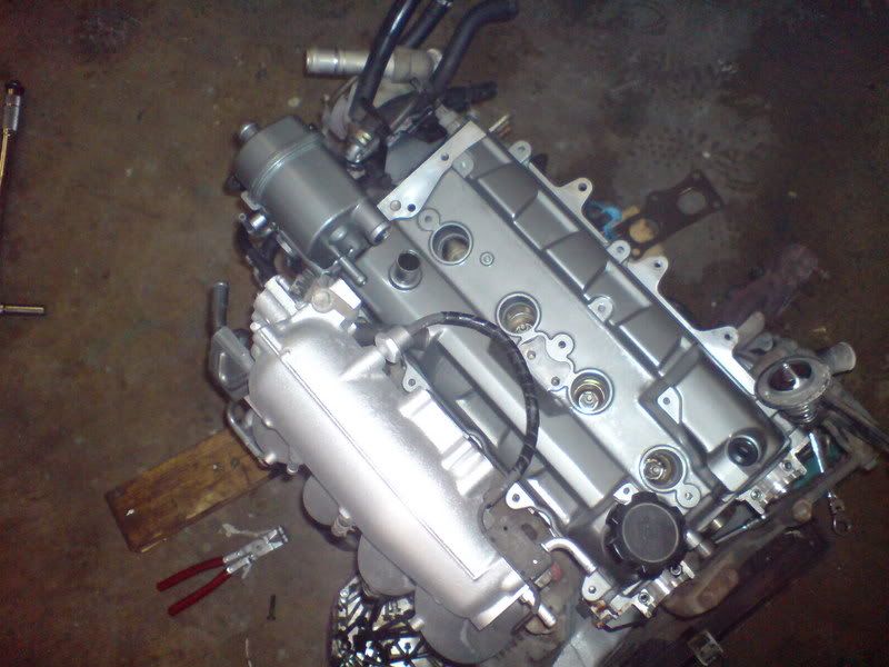

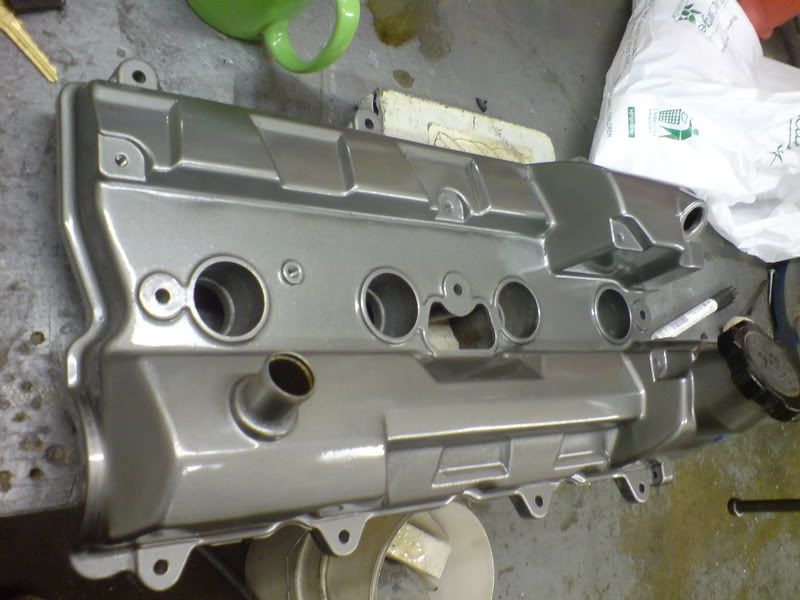

this left me with some time to paint a few things , including cam cover
The cylinder head was stripped ,and tested for true ,it was all in spec , so a light rub-in of the valves and all was reassembled using the uprated Piper springs .I the fitted the ARP head studs to the block and refitted the head

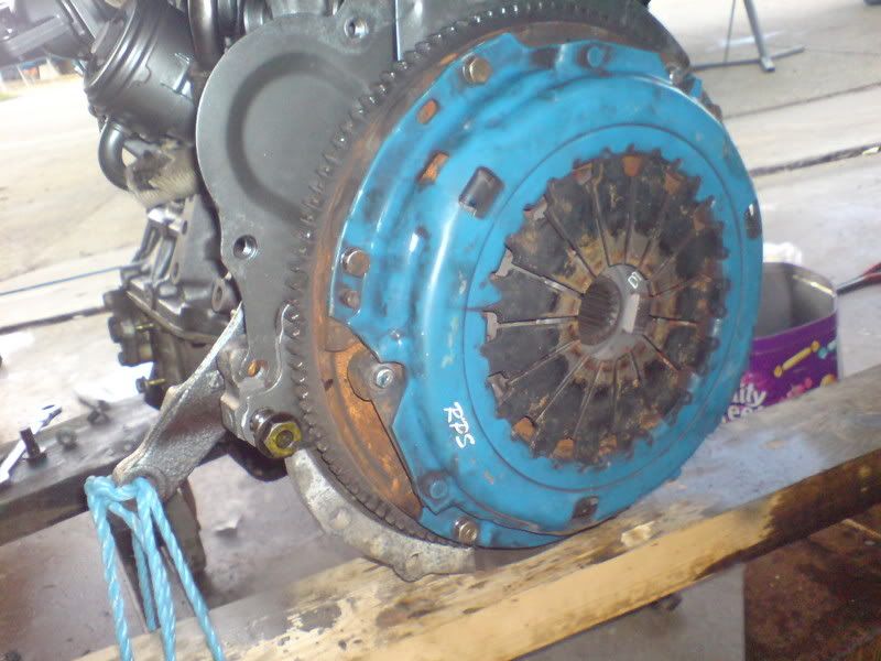

I then refitted the flywheel ,and placed on my RPS streetmax clutch which was only 1000miles old ,was previously in my rev1 turbo seemed a shame to get a new one when this one was so good

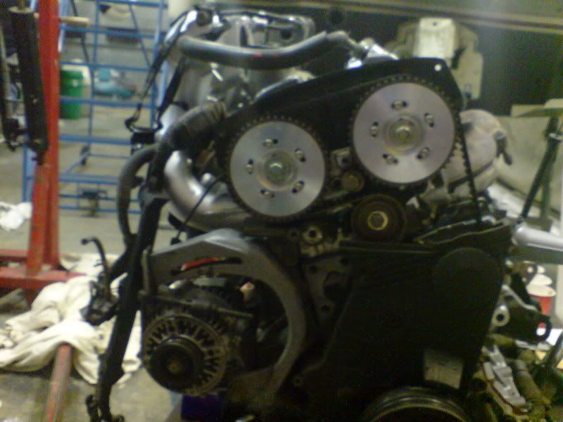

The cams got here , along with the ATS cam gears .the best thing about the ATS cam gears is the fact they use OEM toyota gears ,with an adjustable alloy insert precision fitted into the centre .in my opinion much more suitable than an all alloy gear
The cams and gears were fitted ,and the valve clearances re-shimmed .Then the cam timing was done with a dial gauge and a degree wheel to pipers settings

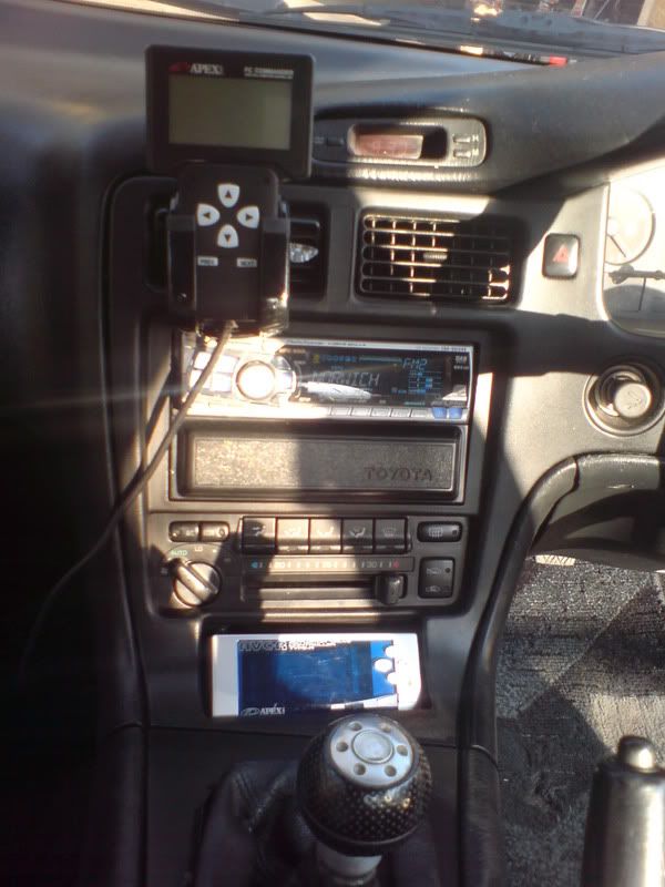

wired in my apexi AVCR and mounted the display in the ashtray hole
run in the extension for my powerfc commander :D

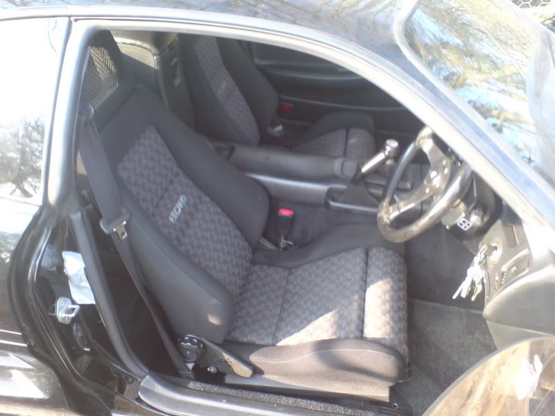

Fitted a set of rare factory recaro's :mrgreen:

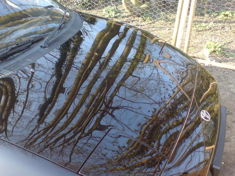

Clay-barred the paintwork and given it a generous coat of meguires gold class polish ,which i have never used before . I was always a diehard AUTOGLYM fan , but i won't go back now

RECAROS
Clay-barred and poilshed paint YUMMY
Dash shot of avcr and pfc commander

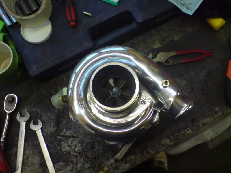

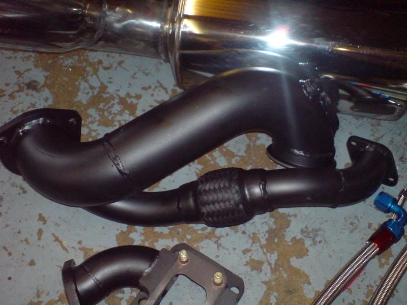

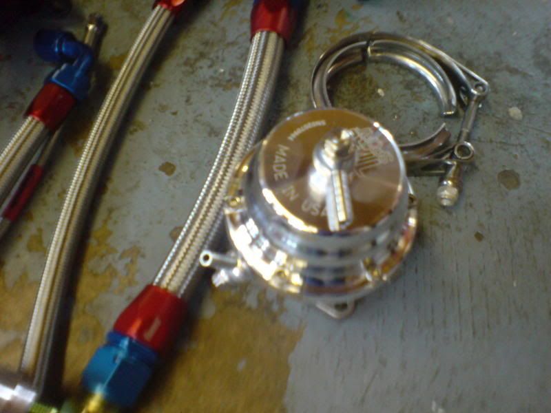

here are some pics i took of my new turbo on my phone
Polished compressor housing

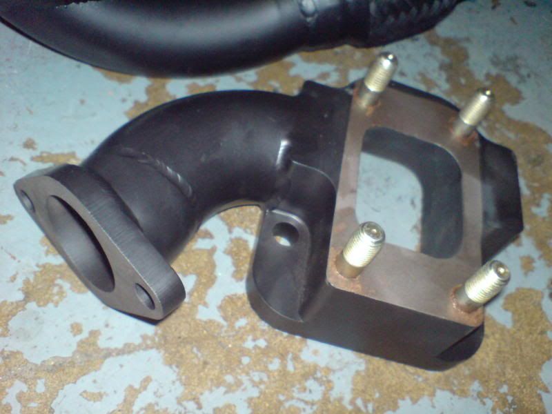

manifold adapter

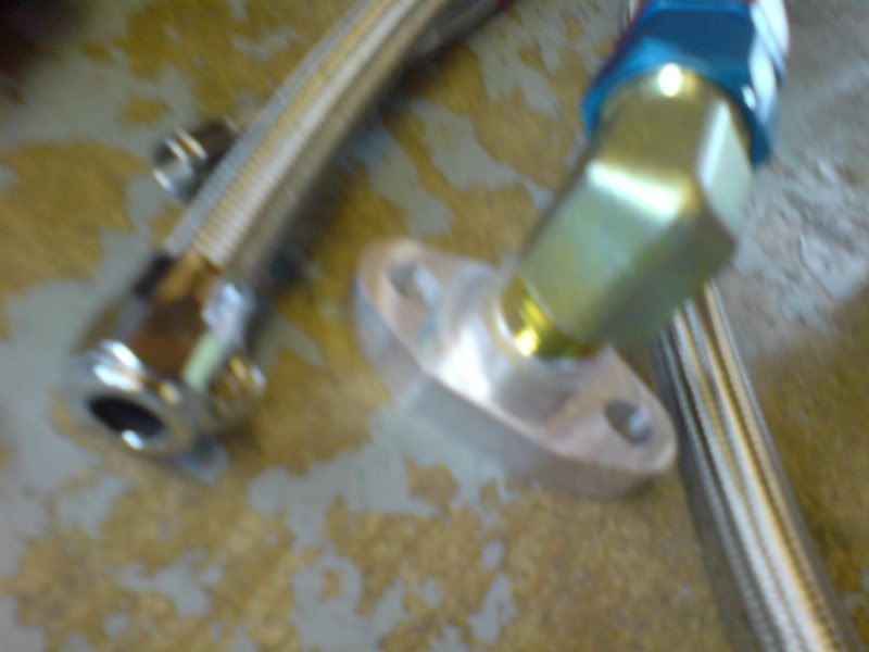

External wastegate and oil lines
sump oil drain adapter

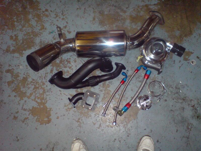

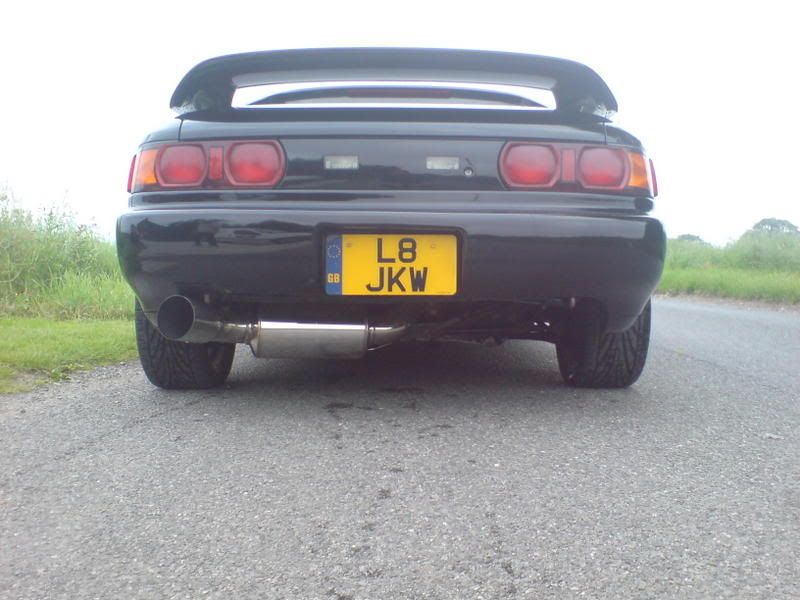

downpipe /re-routed dump tube (will be changed for sceamer pipe when mapped :thumleft:
group shot of all turbo bits and recently polished Apexi GT stainless exhaust :whistle:

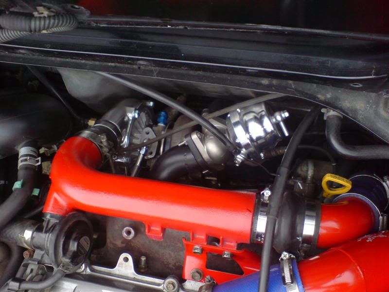

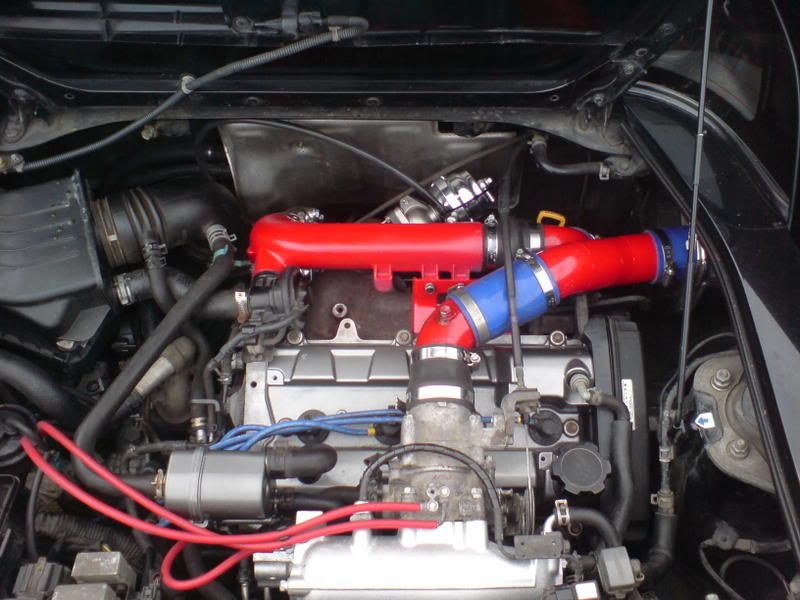

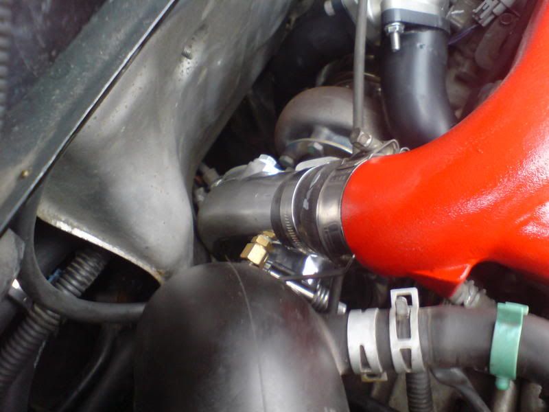

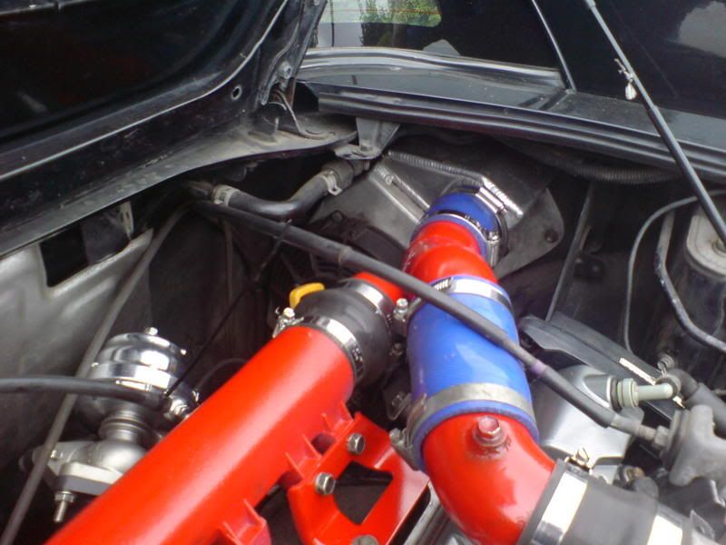

OK i'm on a bit of a high after finally getting my car up and runing so thought i would share some pictures
engine bay needs a bit of finishing ,throttlebody and trumpet need painting ,i need to make a heatshield for the manifold/turbo
and fit the custom 3" intake i have on order ,but she's nearly there
and just some general pics of my car .
