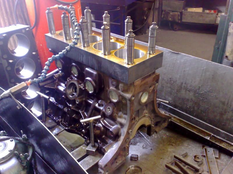

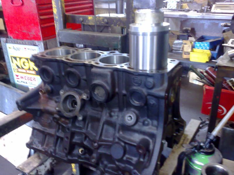

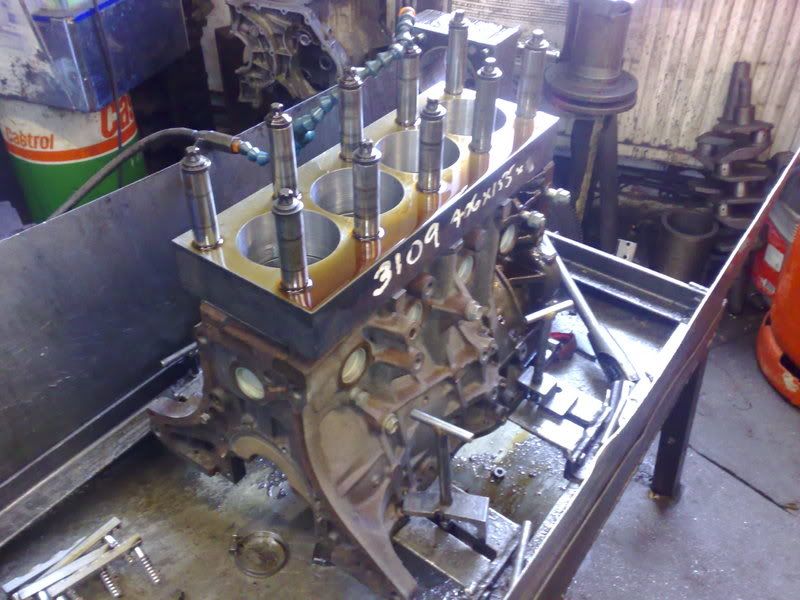

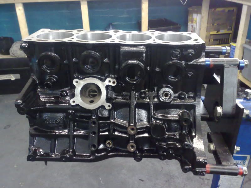

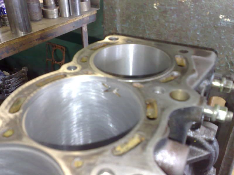

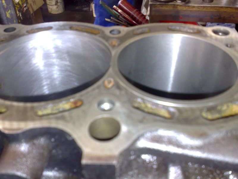

Well the block is pretty much done - just needs to be decked, honed and sprayed.
Here are some pics of the sleeves going in...

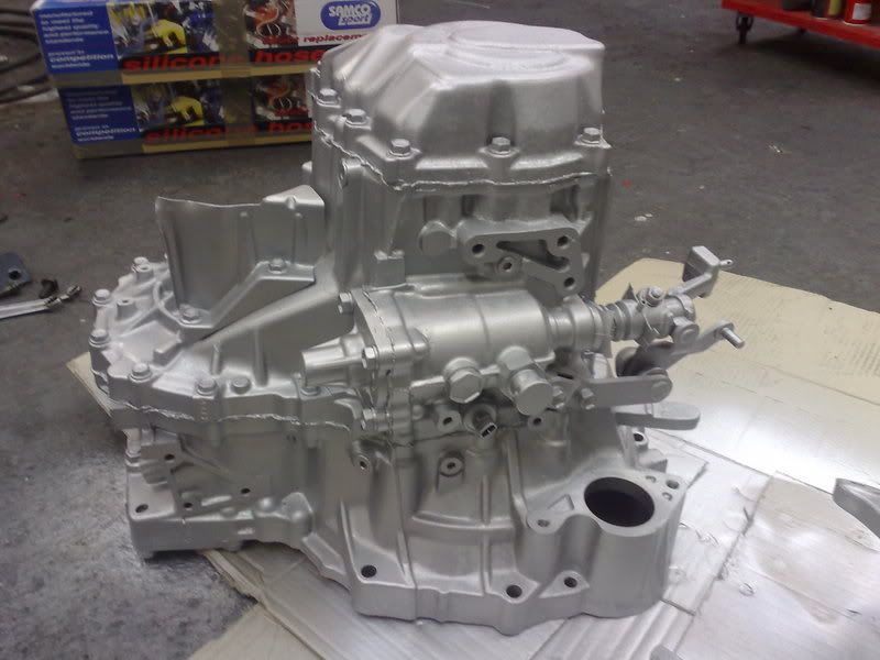

Spent some time cleaning and painting things also and fitting new CV boots - messy job!

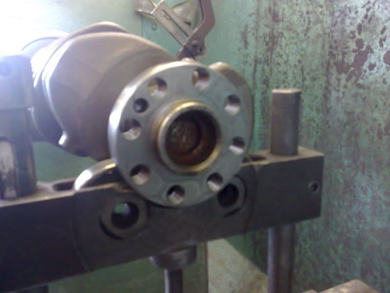

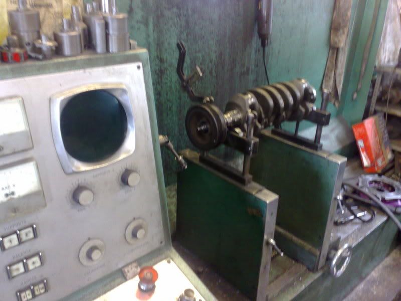

More pics!
Torque plate honed..
Balanced crank
Modified 5S-FE bolt pattern to larger 3S-GTE bolt size + PCD... results in much better fitment of the flywheel :thumleft:

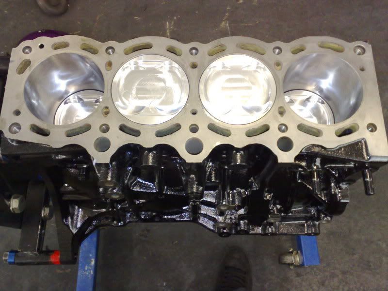

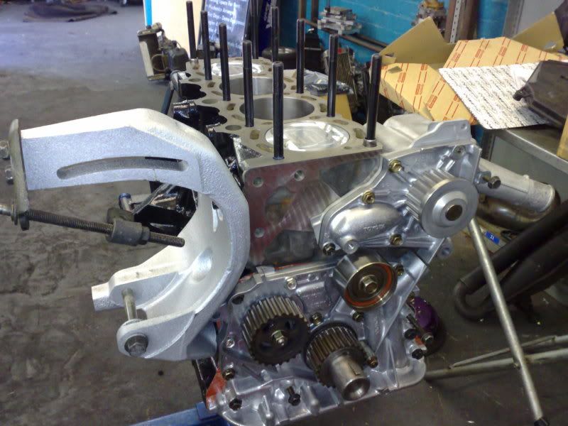

Well today has been busy!!!
Here are the results...
started as this..
then progressed....

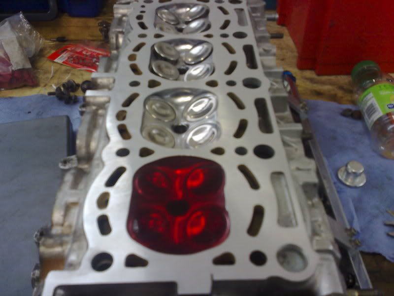

Some measuring and calculations were made to make sure everything is A-OK
Compression working out at a nice 8.7-1 :thumleft:

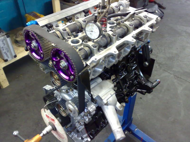

Then time to dial the cams in..
Just some nice pics..
More work being carried out tomo, fitting sump then other bits with the view of the motor in and running by the weekend.... :pray:

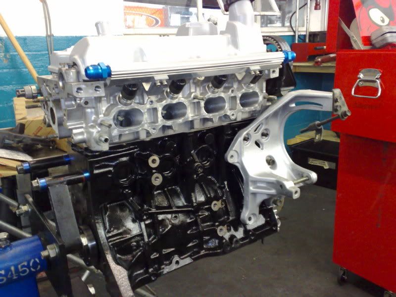

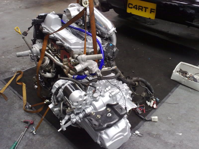

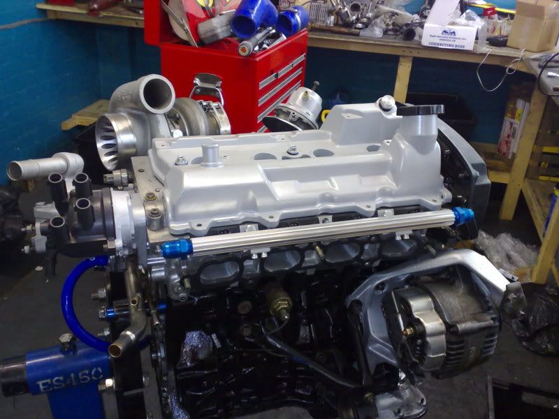

Slow progress today - had to make sure everything was perfect and a few bits took longer than expected but the engine is now ready to have the clutch and gearbox fitted then fitted to the car. This will be happening tomo. Some more pics..

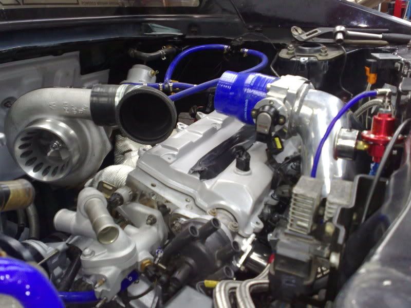

I plan to Earl - the jubilee clips are for the samco coolant hosing.
As for boost - i think we need to be looking at 2.3BAR to be getting good torque. Anything over 2.1bar and the torque sky rockets.
Race fuel would be nice but am just running out of time!

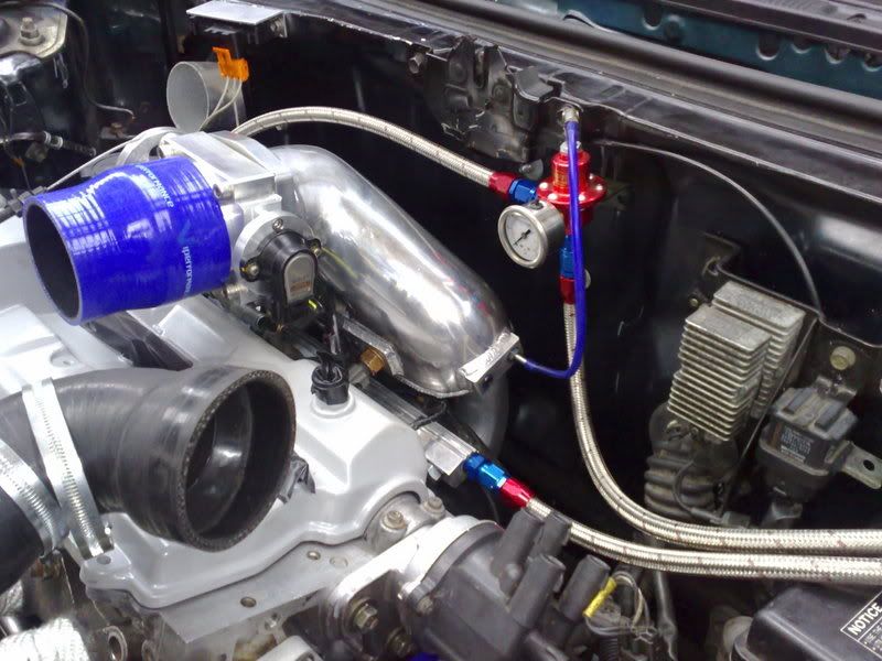

Anyway - more pics....

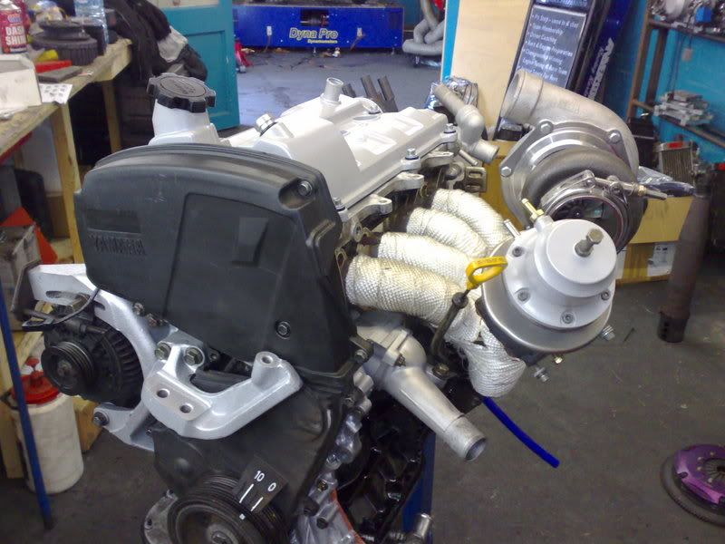

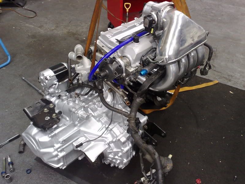

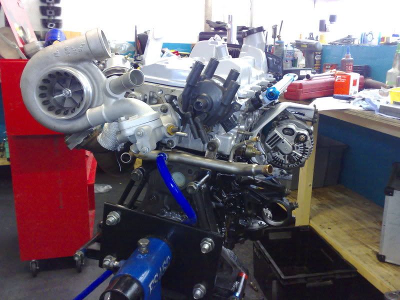

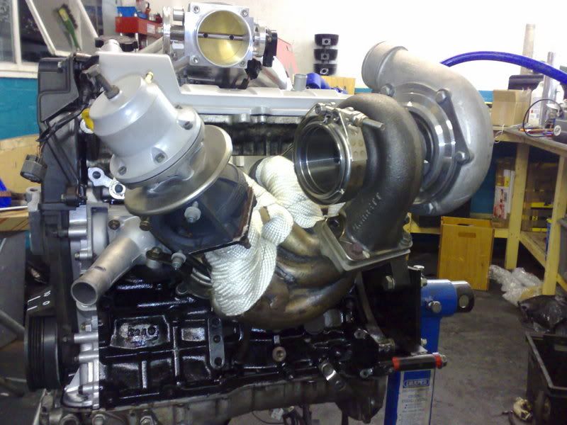

Was a fairly slow day, got engine in but had to fab a few things up then came the fun of fitting all the fuel + turbo lines. Bosch pump in place and fuel lines are all done - turbo drain needs to be finished still but we really broke the back of it today... more work tomorrow.
Also, drag tyres were ordered yesterday so we should be having good grip @ TOTB :mrgreen:
