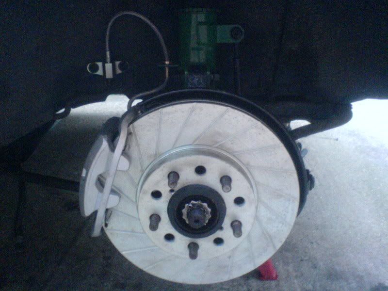

So, anyway I got onto brakes
40 Groove - Phosphate coated discs
Goodridge hoses
EBC greenstuff pads
DOT 5.1 fluid
Brake Calipers cleaned and greased
I think they look much better, and hopefully will give me some improvements.

Good progress there, whats the deal with the Phosphate coated discs? Does it just prevent corrosion around the edges? (I assume most of it rubs off soon after you start using them)
Re: TRD Widebody - 509.6BHP!
Yeah thats it mate. Where the brakes touch it rubs off, but if you drive fairly regularly rust is not a problem in this area, as it gets polished by the pads. Just helps the rest stay pretty
