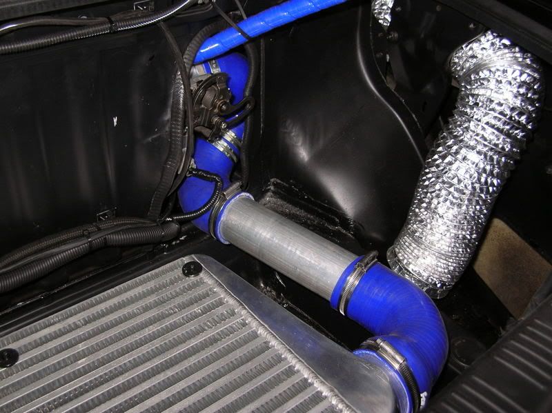

A few pics for the guys that I have been chatting to on the TMIC thread. I will get this little lot finished this weekend and a summary written.
Cheers for the support guys.
Well a bit more progress has been made and the only real thing left to do is weld up my downpipe as the previous one didn't fit. Looking forward to the fire up now although a little nervous.
