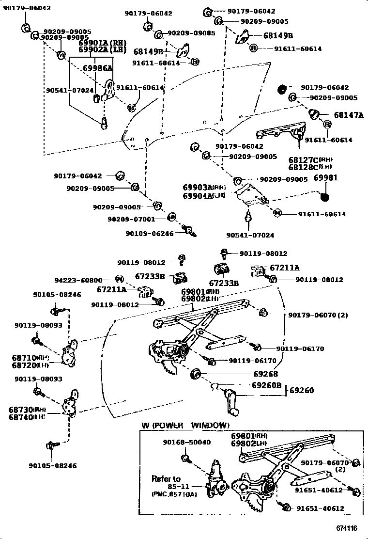

Toyota already provides a facility in the EPC (Electronic Parts Catalogue) to find all models that use a particular part number. Its called Part Number Application to Models, you enter the part number and it will list any Toyota/Lexus that uses the same part.
Part numbers are
85710-17030 MOTOR ASSY, PowER WINDOW REGULATOR, FRONT RH
85720-17030 MOTOR ASSY, POWER WINDOW REGULATOR, FRONT LH
69801-17040 REGULATOR SUB-ASSY, FRONT DOOR WINDOW, RH
69802-17040 REGULATOR SUB-ASSY, FRONT DOOR WINDOW, LH
These parts are only used on the MK2 MR2, no other Toyota. You may be able to make another one work but it won't be a straight swap
Did you apply power the the actual connectors on the motor ?
