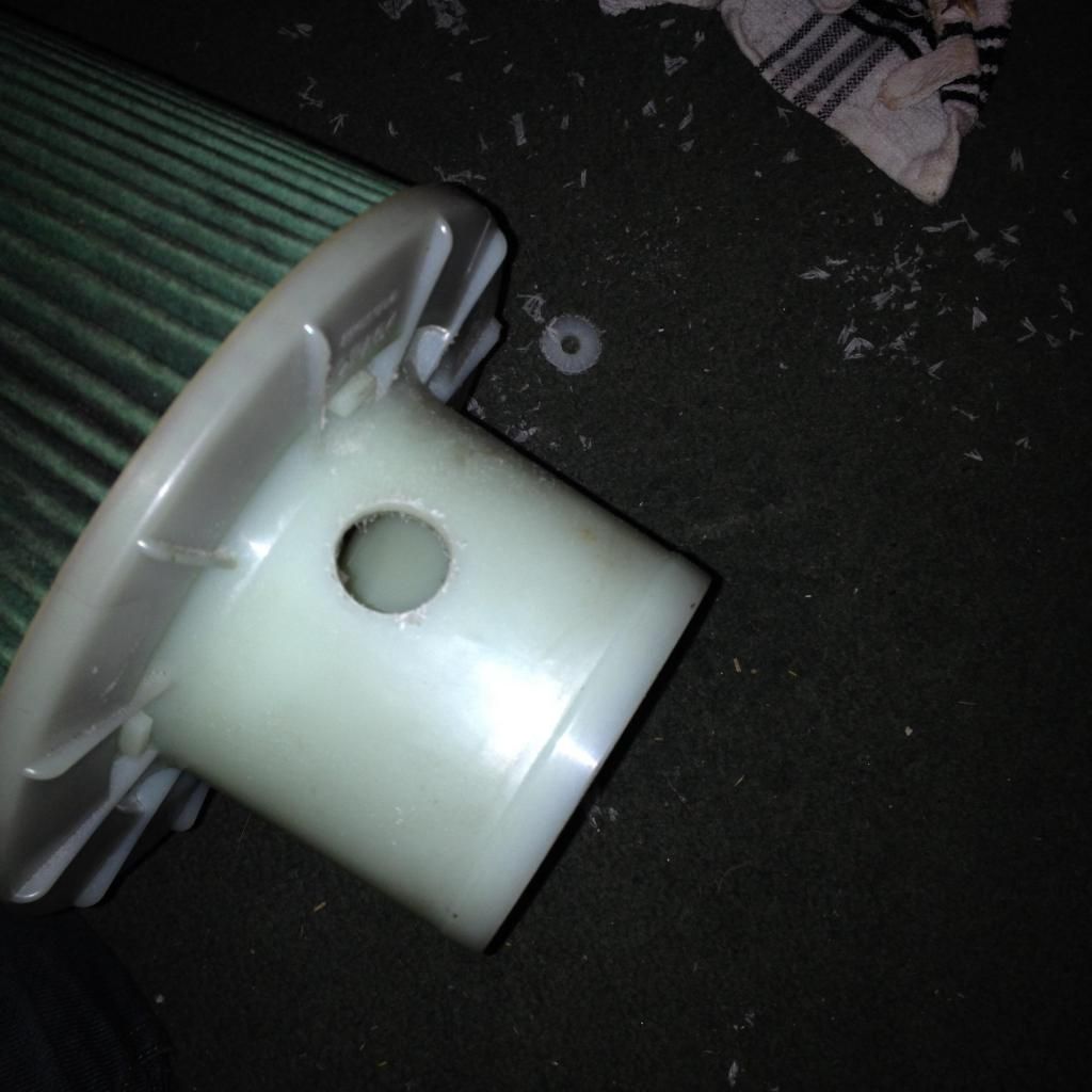

I put on my OEM four spoke wheel and carried out a small mod, fitting an s2000 filter. Now my friend works at Honda so has plenty of used ones stacked up in his shed so I thought Id fit it and see what happens!
First off I stuffed it full of my mothers precious dish towels to avoid any plastic shavings going for a jaunt through my turbo.
I then took a 20mm drill bit and blasted a hole through the side for the IAT sensor.

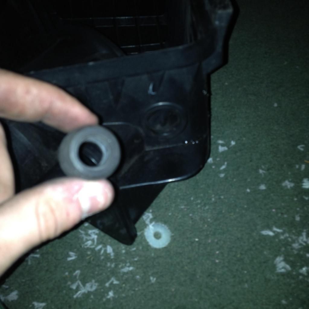

This also meant I could use the old bung from the stock airbox to secure the sensor.
Banged in the bung which fitted perfect.
Then all thats left is to squeeeeze the filter onto the stock turbo hose, plug in the sensor, fasten her up with a jubilee clip and cable tie to secure.
This was just an experiment and the filter is ugly as sin but the car now sounds like a fighter jet so I plan to go and buy a new s2k filter as this one is pretty filthy and we are good to go! Chuffed.

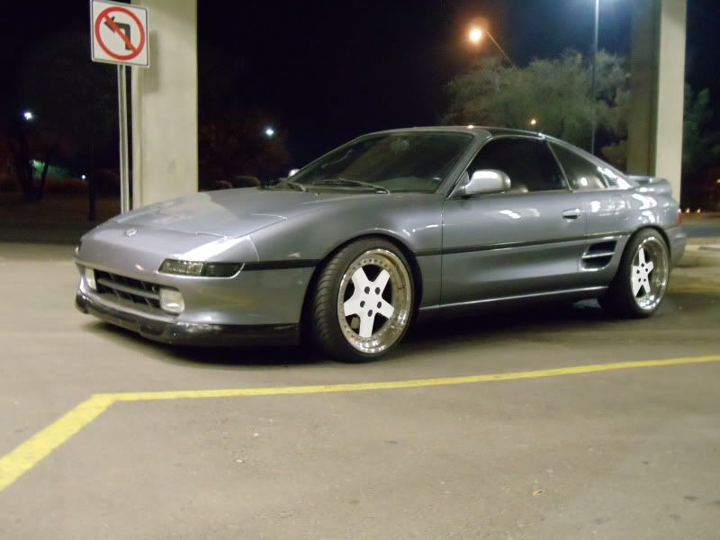

I'm in Mexico visiting my dad and in the mean time trying to finalise my direction on how I want my car looking for summer whilst I have time to think.
I've been debating going for black side strips since Josh (JAAASH) posted up photos of his so I did a quick visual on my car
Personally I think it looks awesome though I'm not quite sure why. Thinking to just wrap them along with the rear centre panel incase I go off the look.
Next up, the Equips
I simply cant decide on these, currently they have white centres and in need of refurbishment but here are a few mock ups I made from a photo I found on google (10 mins max dont judge too much lol)
To begin with I was certain on going for a bright silver, brighter than the above photo...now though Im swayed particularly towards the white centres with the polished lip however there is that part of me that loves the thought of satin black centres and gloss black lips but I feel this would be very controversial on a set of Equips and perhaps doesn't suit the car.
What are your thoughts people?
Suggestions welcome!!
