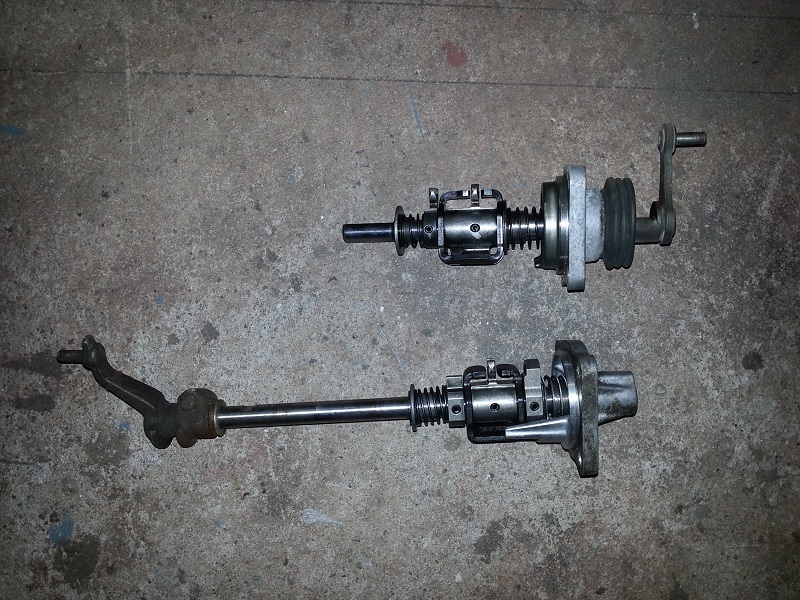

The next challenge appeared. I´ll have to build one working part out of this two:
The upper one is the rear facing gear selector out of the 6 speed Corolla gearbox and the lower one the front facing gear selector out of an 5 speed MR2 gear box.
I´ll have to drill a hole into the gear box housing, put a sealing ring into it and combine the shaft of the MR2 selector with the mechanics from the Corolla selector.
Paul says it´s a pain of a job to get it working. I´ll will see, but I´m confident.

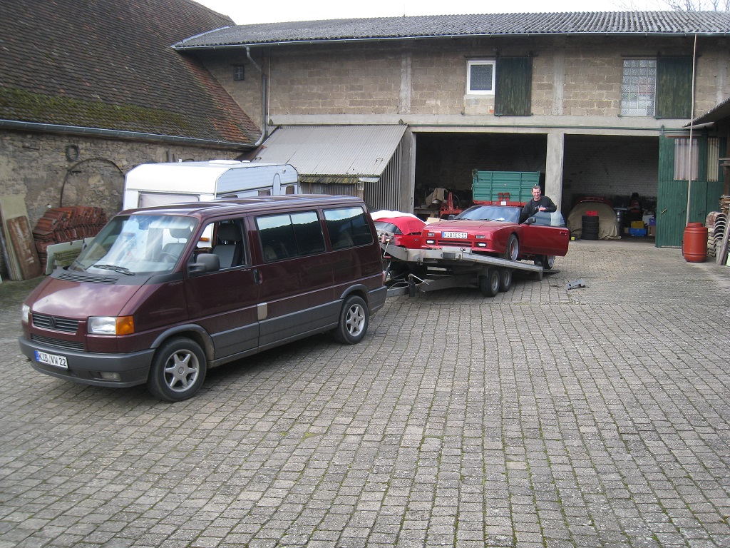

Today it was moving day. I awaked my MR2 from it´s long sleep. Had a helping hand by my mate Marko with his VW Bus and the car trailer I´ve borrowed from my ex boss.
Pushed the MR2 out of the shed it was parked for 10 years now and pulled it to the trailer:
Now it´s parked on my mate´s driveway as we had to finish his project first:
Bolted an chainlift to the ceiling of my mate´s garage where we will pull the engine out of my car and than got it bit more in the details of the gearbox modification.

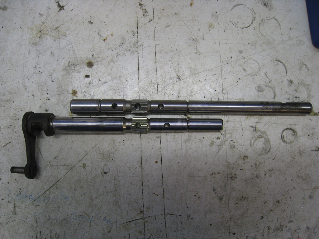

Striped down the gear selectors of the MR2 and the Corolla box and test fitted the Corolla selector parts to the MR2 selector shaft. It fit ! Just need to close weld one borehole in the shaft, drill one some millimeters away from that closed one and find a way to close the shaft hole of the Corolla box´s selector cover.
MR2 selector shaft vs. Corolla selector shaft:
Will get the Corolla gear box housing drilled next week, finish the selector and will pull the old engine and gearbox out of the MR2.

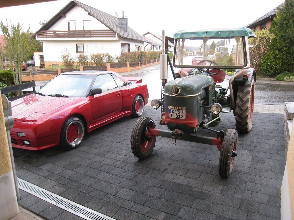

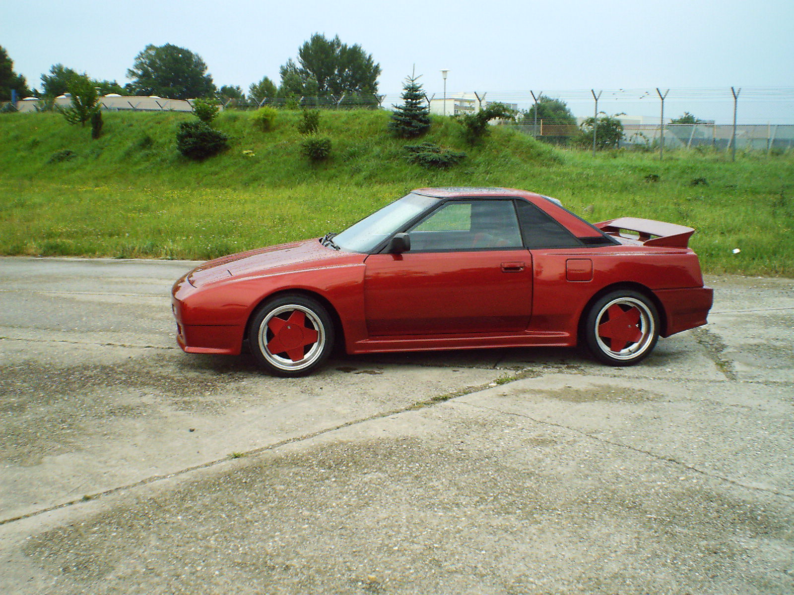

Post by XLarge »

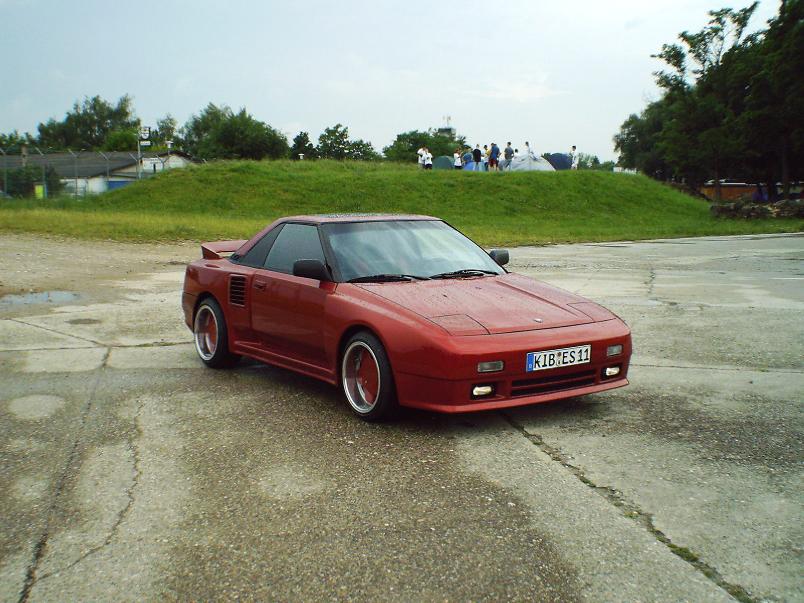

Basicly I´m not a uge fan of bodykits, but I like the Fritzinger kit as it makes the car unique, has a tough history and embody the 80th soooo well.
The "High Tech" kit Toyota Germany sold in that times, made by Haslbeck is to smooth and to rounded I think:
Here the ten years old pictures. May be old, but the look didn´t changed in between:

Post by pk_090 »
I love those wheels!

Post by XLarge »
Me too !
The Borbet A matches the AW11 so well like they was made for it. The edged shape of the center and the flat areas repeating the forms of the car, special with this bodykit.
I´ve searched for an alternative but I didn´t found one that fit so well.
