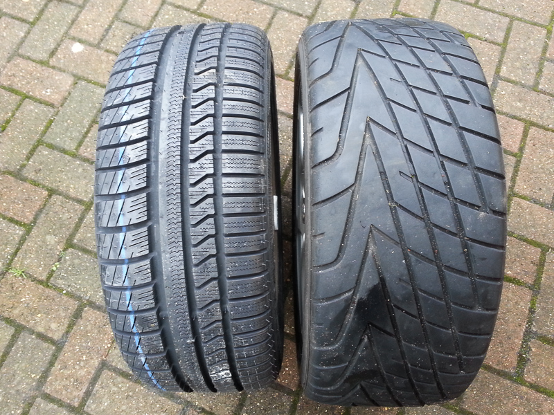

In the above, you can see the difference in tread pattern between the smaller blocks of the Quatrac3 on the left and the large blocks of the Nevoas on the right.

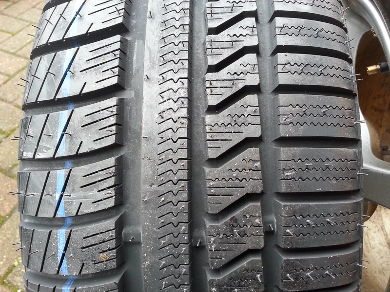

And many more fine 'spies' to provide biting edges in snow and ice, with wide channels for water and slush.
My impressions, a month on and after some icy and snowy mornings is that they are a noticeable improvement on the Neovas in the cold. Ice and Snow grip is astounding - trying them out I could drive on those surfaces and expect nearly as much grip as wet tarmac. There isn't any additional road noise and fuel economy seems about the same. Dry handling is also good, with nice progression to the grip.
The only Cons I have are that the 185/55 profile gives me much lighter steering than the stiff sidewalls of the 195/50's on the Nevoas, but you do get used to this. The only other surprise I've had is that the Quatrac's on concrete road surfaces that have been re-keyed / scored in the direction of travel are very keen to follow the new keying on the surface - near me, there is some 'wave' in the keying on a dual carriageway which results in some pull on the steering.
