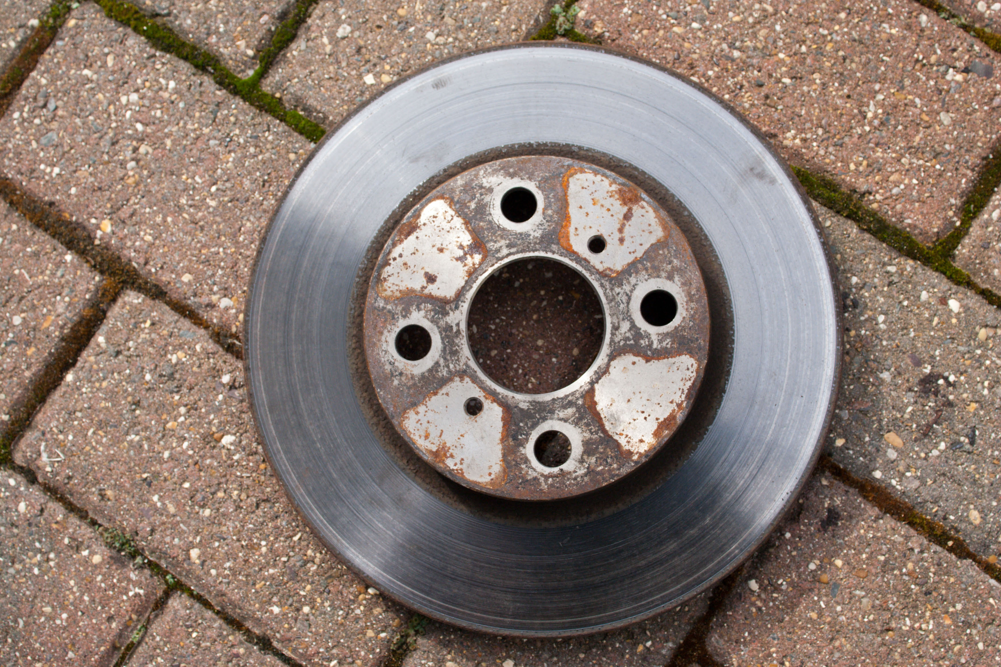

Looking at the outside of the disks, everything looked normal with an even swept shiny disk

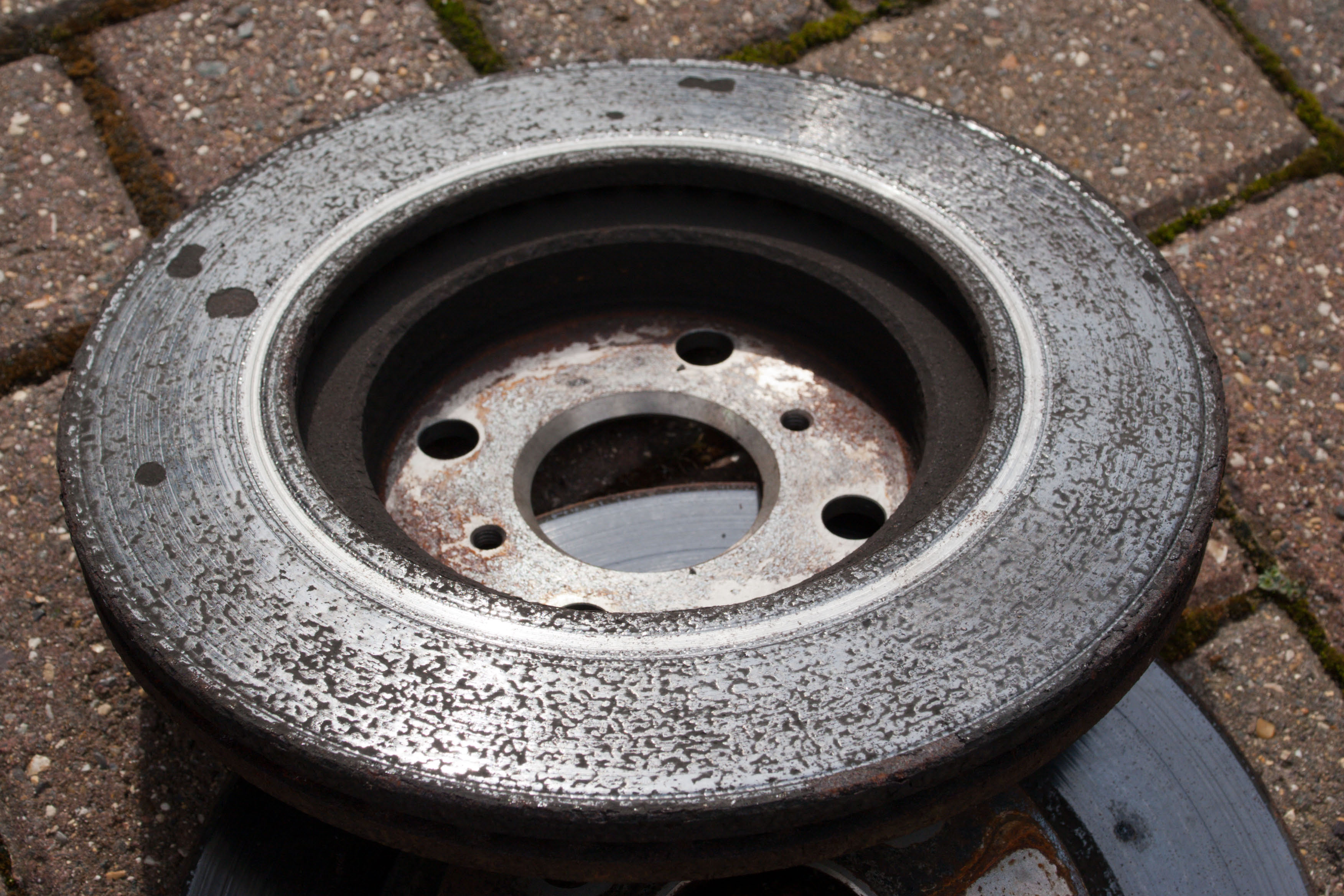

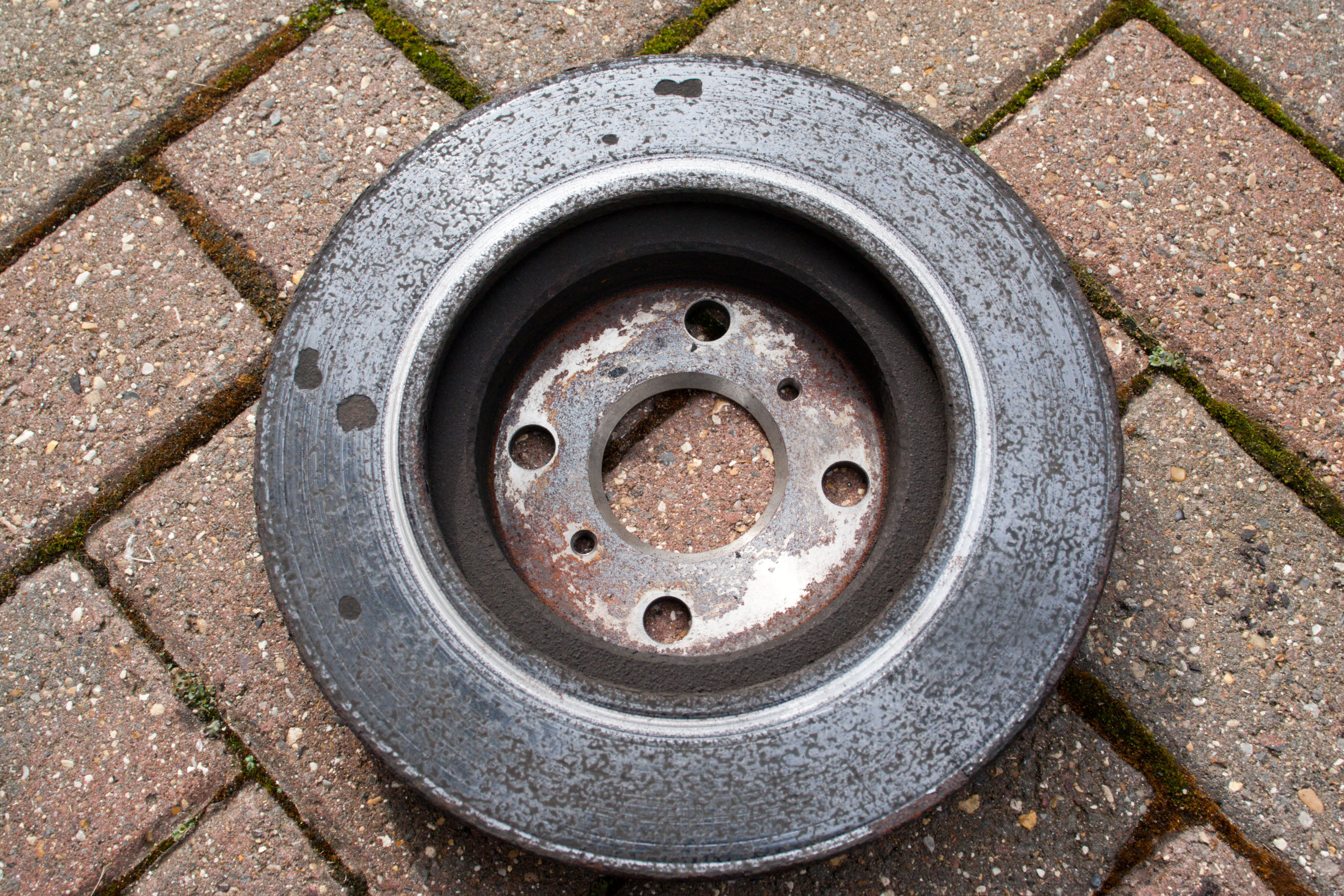

However, I was shocked when I got the disks off the car to see this on the inside surface :
The disk appeared to be completely glazed over, by 2-3mm of material. The brake pad surface looked 'normal' but had worn down more rapidly than the outer pad, as you'd expect on a MR2.

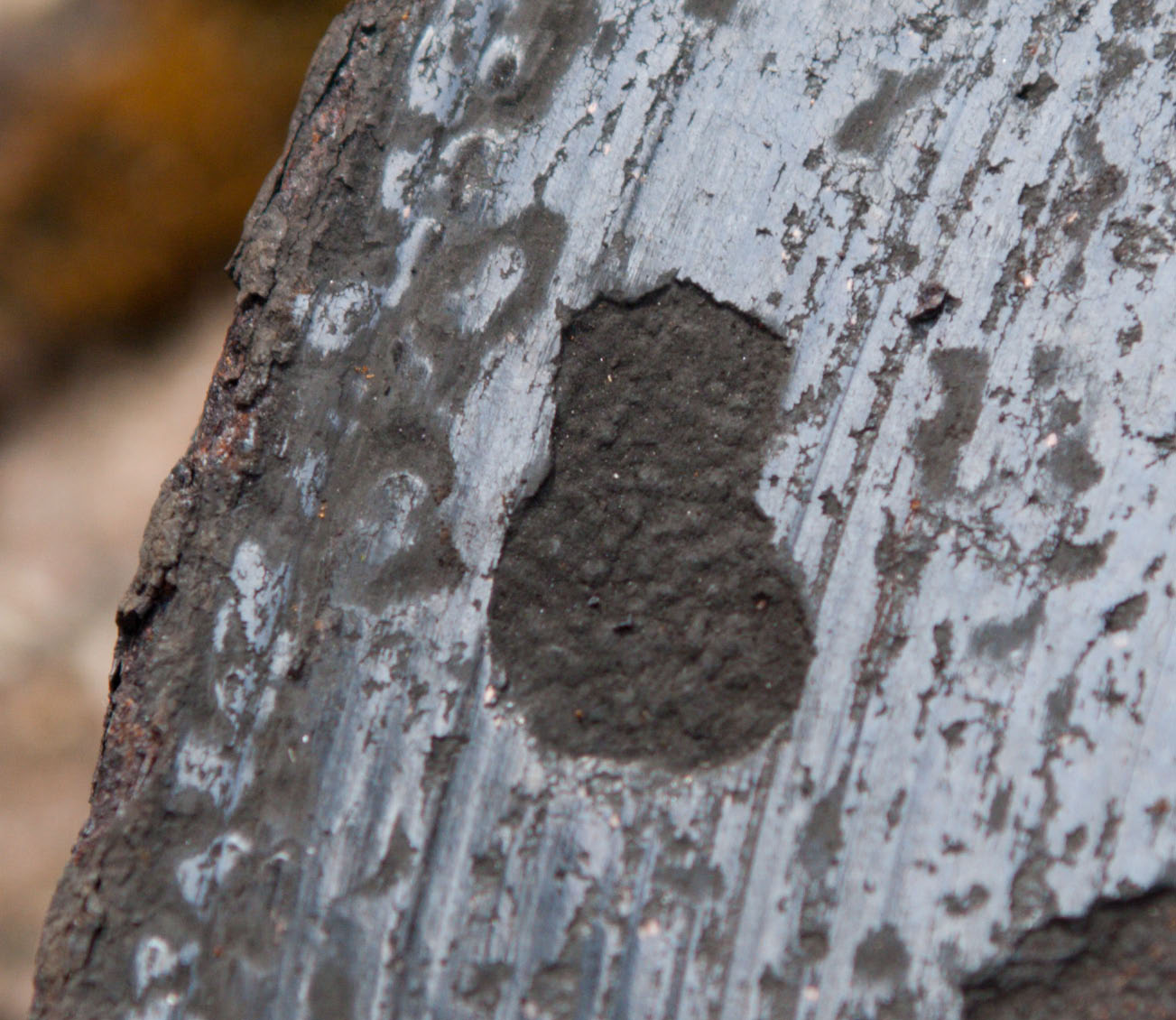

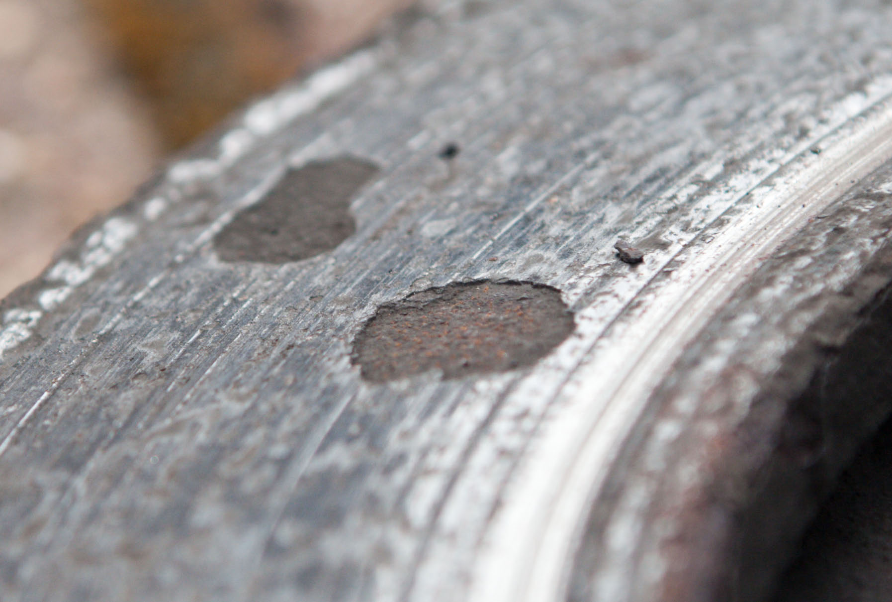

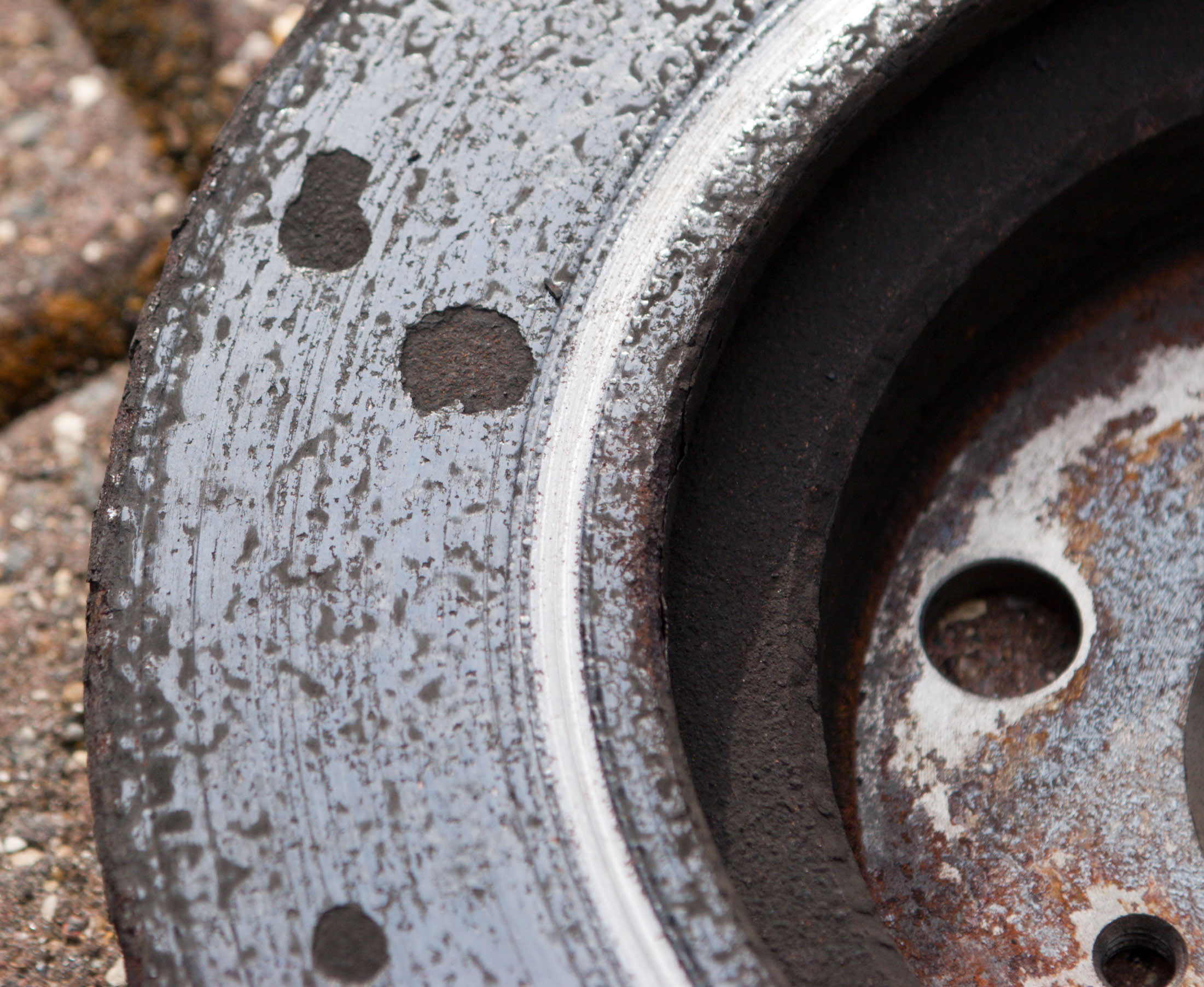

Looking at the material on the disk, in some areas you could see where it had flaked off :
It looked like there were only small bands of ~5mm on the inside (RHS of the below pic ) of the disk where the disk was 'bright' and actually working with the pad - not surprising that I was getting vibrations under braking with the uneven heating.
I've had mild scoring on the inner disk before which was what I was expecting as is common on Mk3's - but has anyone seen a layer of glaze like this on a Mk3 brake disk ?
